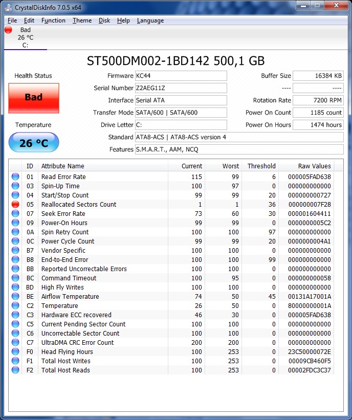

Hi! I'm a newbie. Before I start, I'll tell that I've read the DIY: What's the big deal? post, and I'm aware that:
    - repairing HDDs could be very more complex than expected
    - what I want to do is not the most safe idea, it would be better to let this HDD go if I don't want to get deeper in the technnical part
And my valuable data is in good HDDs and one SSD, and I have all the important stuff in two physical units. This HDD has just a testing OS with nothing to keep.
This is a Seagate ST500DM002 HDD that I replaced by myself from another user's computer several years ago because a bad SMART status that appears in the BIOS boot (with less than 1000 hours of use). But you know, my father and I don't feel that respect to it, thanks to an IDE HDD in a secondary computer that we have. It has that bad status as well... for more than three years and moderate use, and still working. It hasn't anything important stored. And this ST500DM002 is walking the same path. I used it as a external drive with a USB 2.0 case these years and, except the heads contacts thing (I had to file them down once several months after I got it), it shows no problem (apart from the SMART report, obviously).
Well, after reading tons of forums of people asking how to reset the SMART flags and other people answering that it's impossible, forget about it and replace it, I found this video:
https://www.youtube.com/watch?v=-PPmbxNAWyg
So I want to try that. But I have some doubts:
    1) What is exactly "reallocated sectors count"? Does it mean that the SMART found too much reallocations, or it appears with just one? I haven't experience any data lost with it at the moment. Reallocations mean that it found bad sectors and had to move data to other sectors?
    2) What does the raw data means? I mean, 7F28 in the "reallocated" narrow is a hexadecimal number that means exactly what? (Just to control it and check if it goes up)
    3) If I succeed, will the SMART function report new detected errors?
    4) I've never set a RAID yet in a RAID capable mob. The SMART warnings work in the same ways as with non-RAID setup, right? (For RAID0, RAID1 and, if I'm able to, RAID10)
    5) I have computers with UART ports, so I think I won't buy a USB converter like the video, but a serial port to TTL one like this one for this. Do you think it's a good idea? And do you know if there is a male connector (I mean, has it name? :lol: ) for the TTL port in the Seagate HDDs to buy it and make a DIY cable, or already made ones? Because you know, the female plugs of the included cable I think that won't fit (plastic cover too big). Or any idea of the name of that kind of female connector that the dude uses in the video to plug in the HDD?
Cheers,
File comment: CrystalDIskInfo report.

@OP, clearing SMART on Seagate drives is very easy, but most people here are unwilling to share that info because the only non-data recovery related reason to do this is to re-sell bad drives on ebay. Clearing SMART isn't fixing anything, it's just hiding the problem. In professional data recovery, there are times when clearing SMART becomes necessary to get the drive functional, but if you don't have any professional equipment like PC-3000 you really aren't going to be able to handle into that anyway. As to your drive, there is no fix, the drive is dying. It belongs in the trash and will only continue to get worse if you keep using it. That was a defective series of models.

Ok, but according to what you said in the Translator, Defect Lists and Bad Sectors post (and if I understood right), if I reset the G-list, then the HDD will try to read the original physical sectors marked as "bad" instead the spare ones, won't it? In that case, HDD will re-create the G-list and, therefore, the SMART will show warnings again. What I would like to do is to keep the actual self-detected errors (great that there's a "spare zone"! Let it do its work), but tell SMART to warn only for new ones. Is this possible?
And thank you very much for your HDDs' brands recommendations! Do you have for SSDs' brands as well? :mrgreen:
(for any Internet user that drops here, thanks to the Spildit's post, I found that "reallocated sectors count" is the number of sectors detected as "bad" -probably because failing to try to write in them- and have been re-mapped to a "spare sectors" zone that HDDs have set from factory. RAW data for reallocated sectors count I found that it's, actually, the actual re-mapped sectors. In my case, I have 7F28 -in hexadecimal- re-mapped sectors, it means 32552 sectors <-- can be automatically calculated with the Windows calculator in programmer mode, if available)
