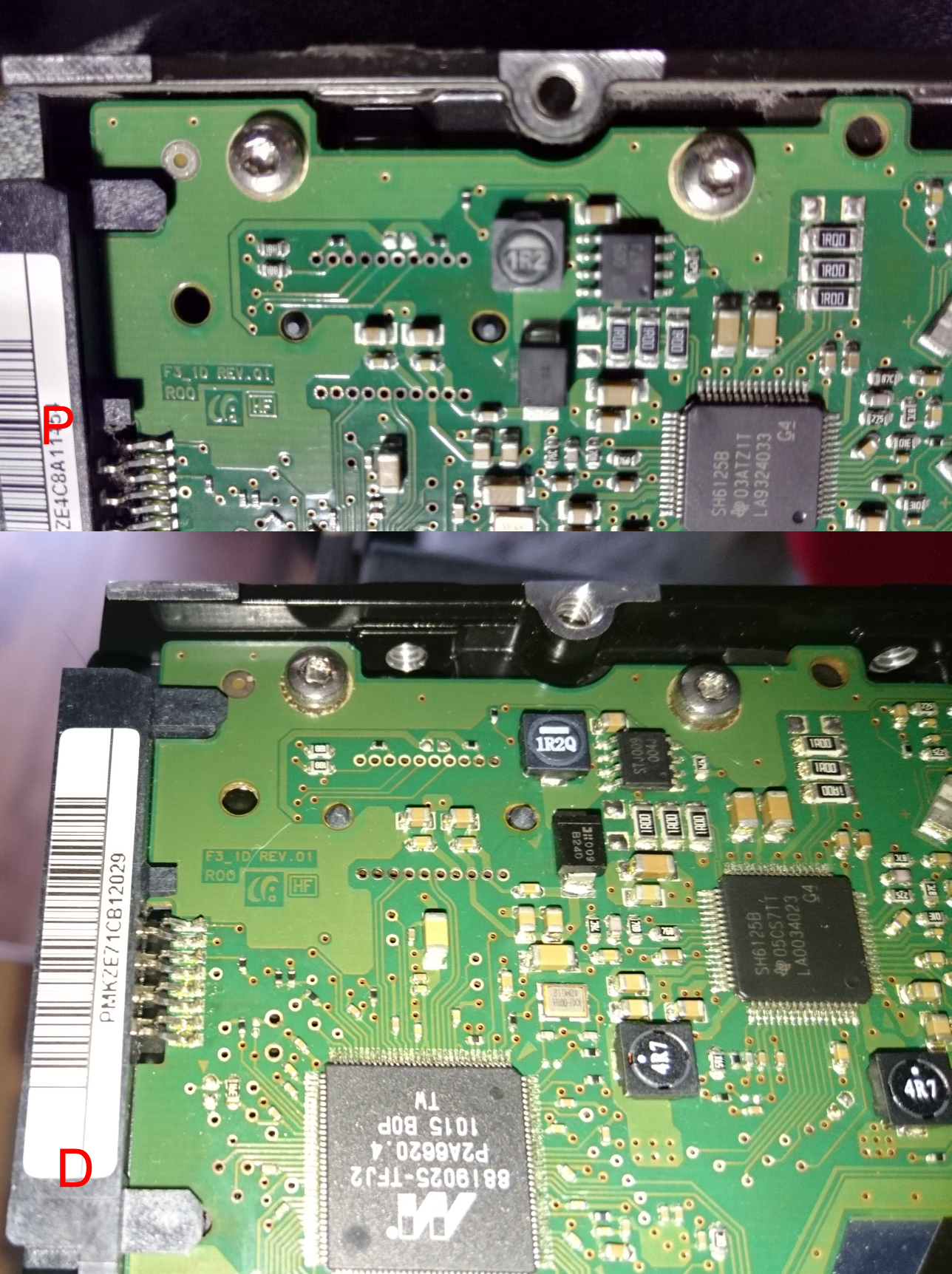

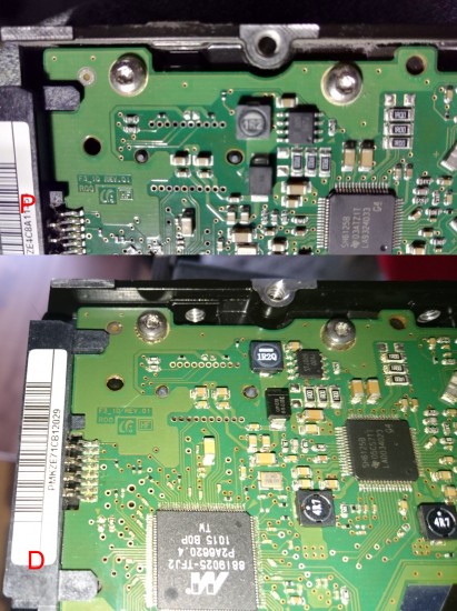

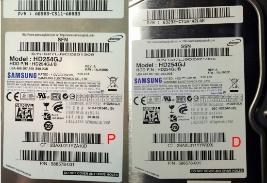

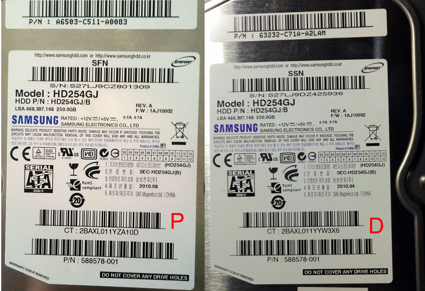

P is the patient, D the donor. Is there anything I missed? They seem pretty identical. I`ll try to do a hotswap, any advice, maybe there`s something I`m not thinking of...
Found this http://www.hddoracle.com/viewtopic.php?f=116&t=1085
Think I should try that or just go for the hotswap with nothing else?

If it helps anyone, I managed to get the data back using hotswap and also replacing the rom chip. Cloned with ddrescue, worked like a charm!
