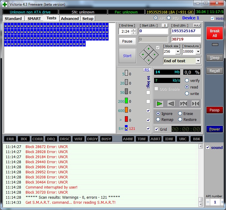

@JGAN & @thathellguy, I'm afraid it's not that simple. I didn't realize before, but now I can tell you that the only way to connect these HDDs and check that the Windows Disc Manager and GParted "see" the partitions is with an external USB 2.0 case. With this one, SMART can't be checked: CrystalDIskInfo doesn't show it and Victoria says, if SMART report is asked, that there was an error. Besides, if I begin a test, it says that there are errors (it was stoped a few seconds later):

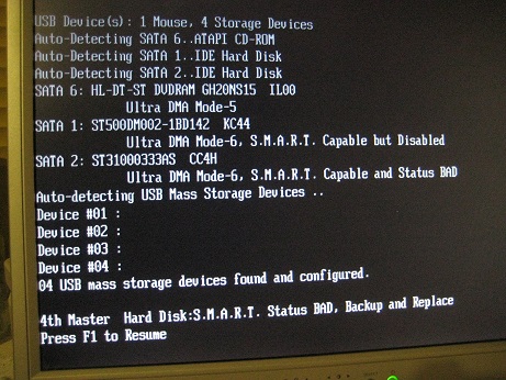

If I connect it via eSATA or internal SATA, they only last a few seconds as connected. Then dissapear for BIOS or OS. When booting, SMART says that something is wrong, that's true:
@Martin Thank you very much, that's a good start point. So, it may be a FW issue + bad blocks. I only connect the drive if I consider some test is necessary, otherwise I was thinking the same (the more time powered, the less probabilities for recovering the info).
