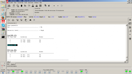

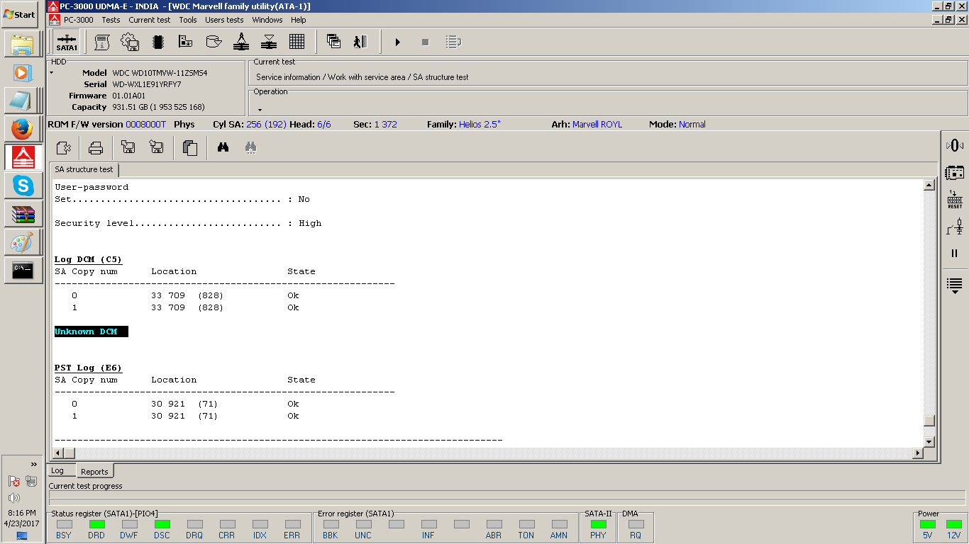

Hello Friends ,
Please help me , Can not Access WD LBA !!!!
model : WD10MVW-11ZSMS4
Normal mode Detected, but Can't Access any data Sector .
SA Test shows : unknown DCM
Micro Jogs
LH : PH : Micro Jog (Hex/Dec)
0 : 0 : B26/2854
1 : 1 : B24/2852
2 : 2 : B40/2880
3 : 3 : BD8/3032
4 : 4 : B4C/2892
5 : 5 : B52/2898
View module 90 information
Total heads............................. : 6
Used heads.............................. : 6
Mdl 47 version.......................... : GJ.4037F
ROM Version version..................... : 0008000T (08.0T)
Mdl 11 Version.......................... : 0008000T (08.0T)
attaching ROM & ROM modules to check .
Regards,
Alex

Security level.................... : High
 Post subject: Re: Unknown DCM , Cant Access Sector - Helios
PostPosted: April 26th, 2017, 11:17
Posts: 219
User password set ......................No
alexpeter
This is the native USB drive. Are you working via USB? Or you've already use adopted SATA board?

Well,
This unknown DCM error comes with many drive families ,This just means that pc3k could not parse that properly to give you a meaningful answer ,Try and concentrate of other thing and leave this dcm error please .If you wanna send us drive for data recovery welcome we both are from india

Looks like already adapted to SATA.

Hello Friends ,
Sorry for late reply .
1. USB to Sata converted .
YES I COULD RECOVER DATA .
Error was in ROM modules .
Thanks for your kind support.
