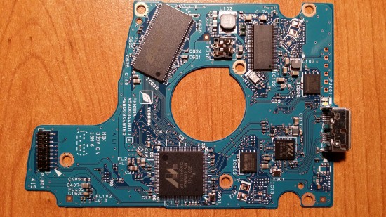

Hello to all,
I’ve been reading over the forums, but I didn't find similar symptoms as my drive.
This is the drive:
Model: MQ01UBD100
HDD Code: HDKBD29AYA31 T
Firmware: AB00/AX101U
PCB Revision: G3448A
Symptoms: The drive spins but the SO doesn't detect it. In particular on linux machine if I do "dmesg" on terminal I get:
[ 7852.284225] usb 3-1: new full-speed USB device number 6 using xhci_hcd
[ 7852.396267] usb 3-1: device descriptor read/64, error -71
[ 7852.612203] usb 3-1: device descriptor read/64, error -71
[ 7852.828138] usb 3-1: new full-speed USB device number 7 using xhci_hcd
[ 7852.940218] usb 3-1: device descriptor read/64, error -71
[ 7853.156152] usb 3-1: device descriptor read/64, error -71
[ 7853.372097] usb 3-1: new full-speed USB device number 8 using xhci_hcd
[ 7853.372320] usb 3-1: Device not responding to setup address.
[ 7853.576274] usb 3-1: Device not responding to setup address.
[ 7853.780051] usb 3-1: device not accepting address 8, error -71
[ 7853.892047] usb 3-1: new full-speed USB device number 9 using xhci_hcd
[ 7853.892256] usb 3-1: Device not responding to setup address.
[ 7854.096240] usb 3-1: Device not responding to setup address.
[ 7854.300034] usb 3-1: device not accepting address 9, error -71
[ 7854.300133] usb usb3-port1: unable to enumerate USB device
I tried to change USB 3.0 cable and also with an USB 2.0 cable, but it's the same.
I've thinked to buy another PCB but it's the first time doing anything like this and I just wanted to make sure that what I've in mind it's actually possible. Thanks, any help would be appreciated!

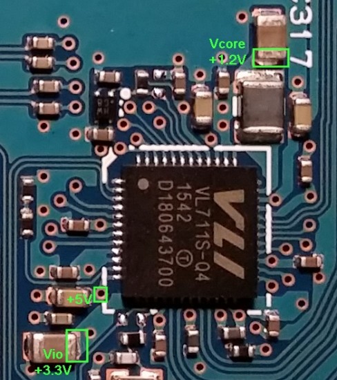

Check the following voltages:
Thanks for replies
In order, from top to bottom of image:
0.49V~0.51V,
4.87V~4.96V,
3.60V~3.68V
(Measured with two different tester).

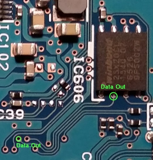

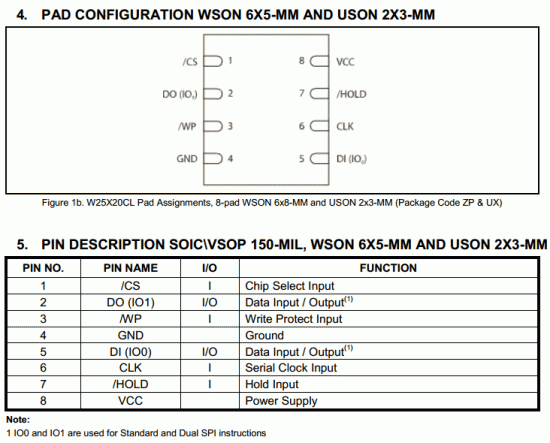

If the voltages are OK, try to invalidate the bridge firmware by shorting the Data Out pin to ground while you apply power to the PCB. If the VL711S bridge is alive, it should then revert to reporting VIA's Product and Vendor IDs via USB rather than Toshiba's.
Edit: Sorry, I just saw your latest post. Don't bother with this test.

ISTM that the bridge IC (VL711S) is faulty. Its internal LDO regulator should produce +3.3V from the 5V input. Also, its internal DC-DC converter should be producing +1.2V via the external inductor and capacitor (below and above my Vcore rectangle). Measure the voltage on the bridge side of the inductor. Also measure the resistance of the inductor (with power off), and the resistance of the capacitor (between Vcore and ground). It may be an idea to reflow the solder joints at the inductor and/or capacitor.
The voltage on the bridge side of the inductor is 0.49V, the resistance of the inductor is 3.4Ohm, instead none continuity between Vcore and ground.

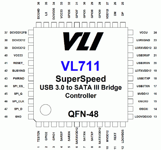

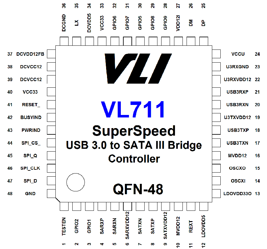

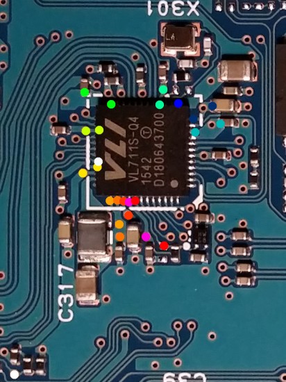

Here is a pinout diagram for the VL711:
I would measure the voltage pins - 10, 12, 13, 16, 24, 27, 33, 34, 37-40. I would probe the external components rather than the IC's pins (less risk of shorts).
Pin 41 (RESET_) should be high in normal operation. If Vcore is below 0.9V, then the internal reset logic pulls this pin low. This pin can also be connected to an external reset generator. The 4-pin IC near pin #1 of the bridge could be a reset supervisor. I would measure the reset pin (41).
The attachment VL711_pinout.gif is no longer available

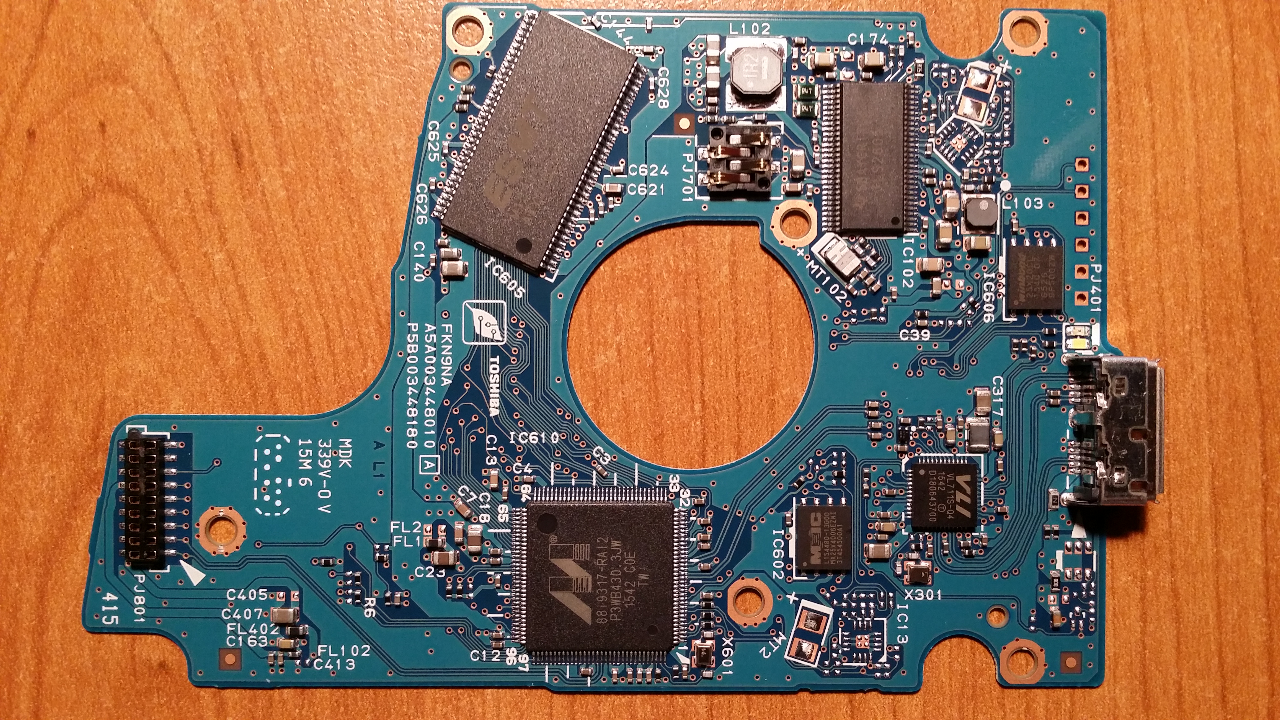

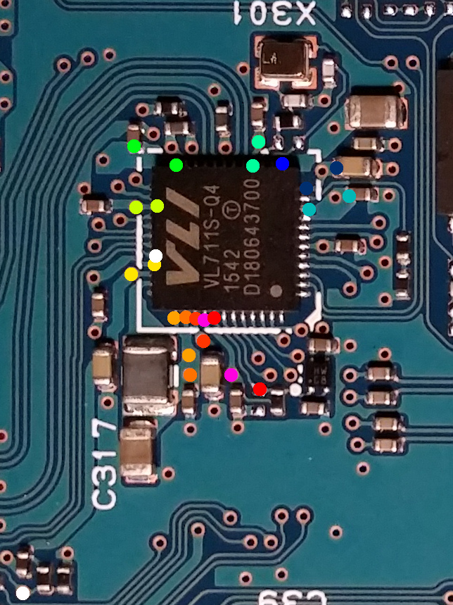

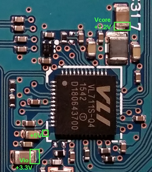

Hi fzabkar, I've been able to do the measurements: [PIN] [Volt]
10 0,50V, 12 5,04V, 13 4,83V, 16 0,51V, 24 4,83V, 27 0,52V, 33 3,34V, 34 5,05V, 37 0,52V, 38 0,52V, 39 0,52V, 40 2,62V, , 41 3,70V.
I also made the first measurements: Vcore 0,69V, +5V 5,04V, Vio 3,41V
File comment: In order not to risk the short circuit
 Post subject: Re: Toshiba MQ01UBD100 (1TB USB 3) not detected but spins
PostPosted: May 27th, 2017, 17:40
Posts: 17342
I don't understand why the Reset pin is high when the Vcore is low. I also don't understand why your Vcore measurement of 0.69V differs from the VDD12 voltages (~ 0.5V). :?
Which location are you using as your 0V reference?
PostPosted: May 27th, 2017, 18:36
Joined: May 13th, 2017, 6:33
Posts: 13
Location: Italy

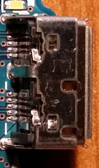

Does it refer to mass? (GND?) If so, I'm using the usb jack carcass.
I measured again at the same time Vcore and VDD12 and it's the same (in this case 0,68V). :/
(The measurements will definitely not be very accurate, because I have adjusted two pins to the tester's tips...because I do not have thin tips :( )
PostPosted: May 29th, 2017, 15:25
Posts: 17342
If the voltage across C317 (Vcore) is 0.69V rather than 1.2V, then ISTM that the bridge must be faulty, despite the high level on the Reset pin. ISTM that a PCB swap plus firmware transfer would be worth a try.
