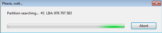

If it helps, I found out the model using DMDE.
It shows this:
WDC WD5000LMVW-11VEDS6 : 01.01A01 : WD-WX81A6384857
When I selected the drive, it started the scan and threw two popups:
Partition searching... #2 LBA: 976 707 583
LBA: 976 707 583 (try 1): WinError 1117. The request could not be performed because of an I/O device error.
I could retry the operation or ignore it, but I canceled out for now till I know more.

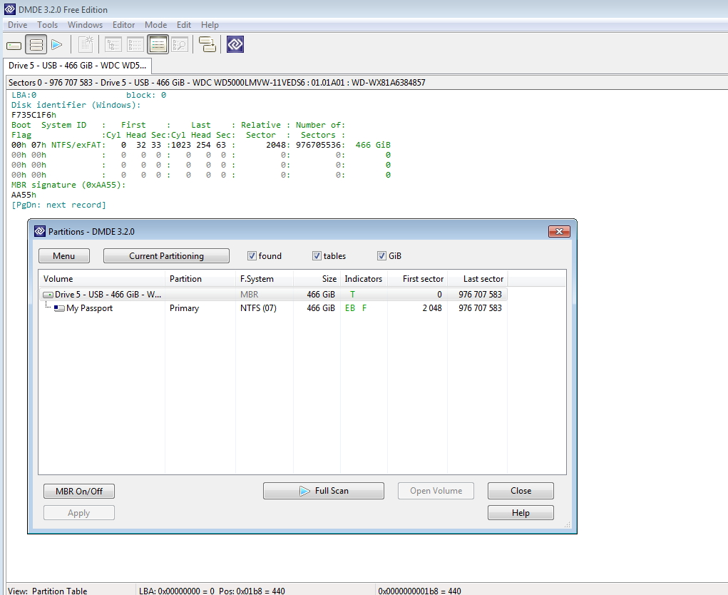

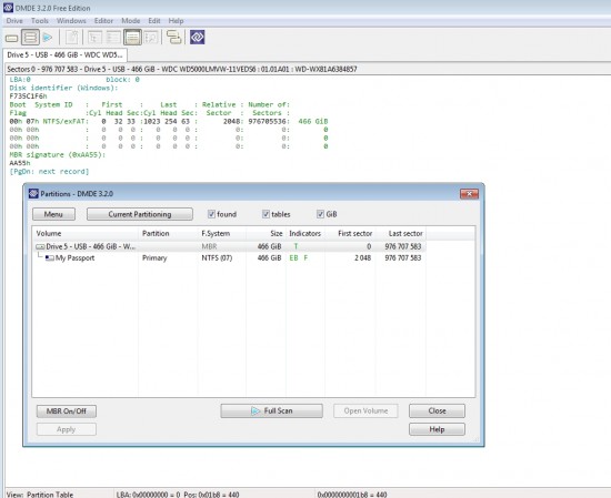

As for DMDE, it hangs right away in partition searching at the last available LBA. I guess it scans in reverse (?).
When I interrupt it, it shows whatever partition data it has identified. I'm attaching the two screen captures of this process.
File comment: DMDE stuck in scanning
File comment: DMDE partitions

DMDE has found a single NTFS partition starting at sector 2048 and ending at sector 976707583. The "Indicators" column indicates that the partion has an entry in the partition table ("E", sector 0), a recognisable boot sector ("B", sector 2048), a recognisable MFT ("F"), but there is no backup copy ("C") of the boot sector. This backup is located at the end of the partition (sector 976707583). Unfortunately this latter sector is unreadable, so that's why DMDE stumbles.
Try this:
    r-click the My Passport partition
    select Open Volume
    expand the Root
Do you see your file/folder tree? If so, then select any file and recover it to another drive.
If all is OK, I would clone your drive, sector by sector, and then recover your files from the clone. I would begin the recovery by restoring the boot sector backup copy. That's a single-click operation in DMDE.

1. The partition Find & Mount, in its faster mode, got stuck at 0% for at least half an hour and I stopped it.
2. The DMDE suggestion to right-click the partition and Open Volume, was victim to the problem I get with all the programs.
The partition scanning hangs on: Partition searching... #2 LBA: 976 707 583, and when I stop it, the partition directory entries etc show as zero. Right-clicking on the shown partition and Opening Volume, hangs there forever.
