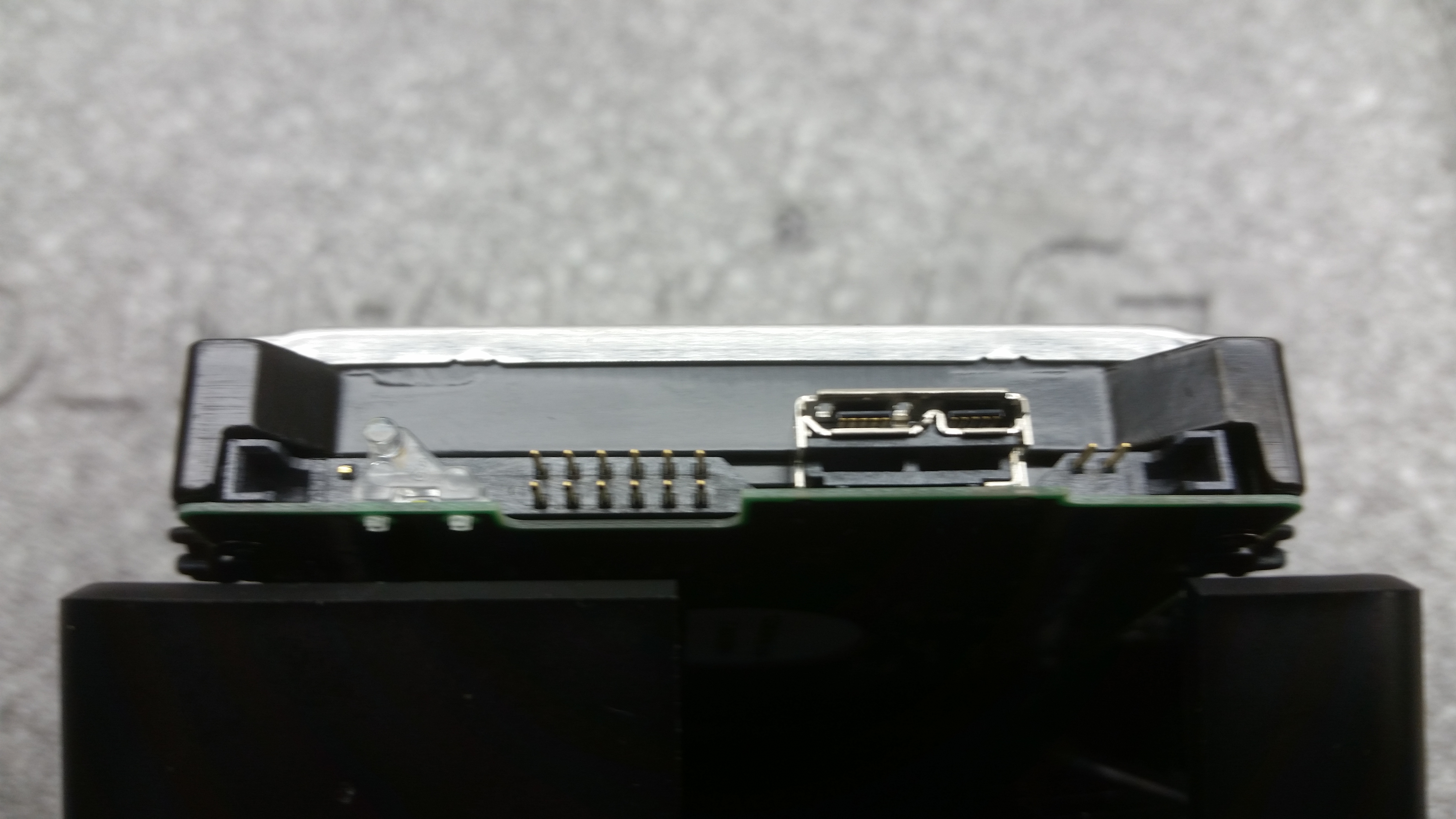

you mean the USB pins? can you take a picture?

As you can see in the pic the USB plug is attached to the board with some additional pins

Yes, however it does not make much sense to do so and it is not an easy conversion. Furthermore the drive is not designed for SATA use.
Wipe and sell it and buy yourself 1-3 brand new SATA drives.

The extra pins could for easy programming at the factory, serial ports, testing etc. Drives like this can have 2 different boards, a USB board, like you have, and a SATA board. When recovering these drives, a person doing DR might opt to find a compatible SATA board, and transfer ROM or whatever to make it work.
I dont think you will find it all that interesting to be honest ;-)

Has nothing to do with size, rather with costs. They are saving money by using this design by basically removing an extra adapter/converter from SATA to USB interface from the production line.

@trickyrick, if you are truly inquisitive, then determine how each of the pins connects to the MCU, and locate the ground and supply pins. Then we might be able to find out something useful. :-)
