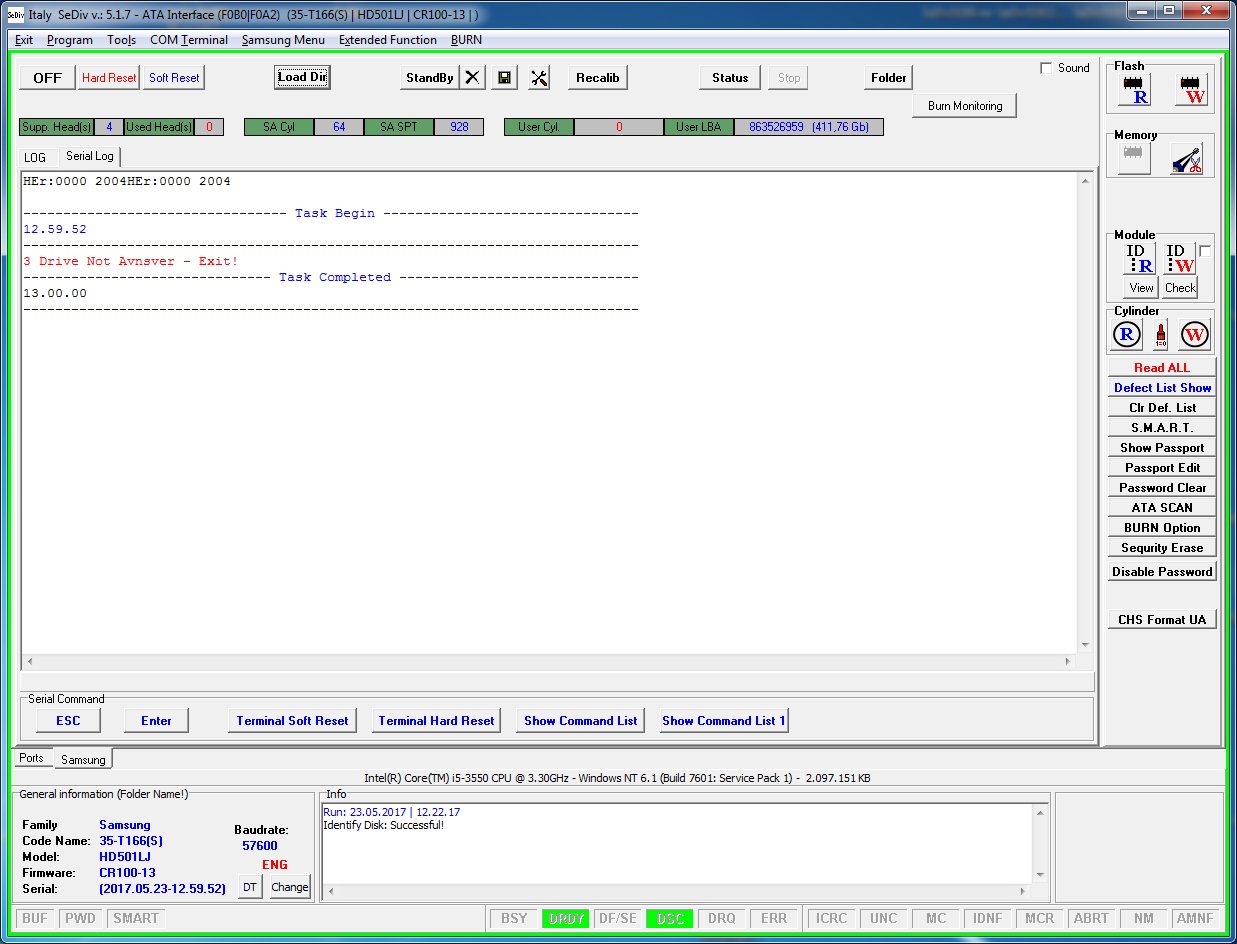

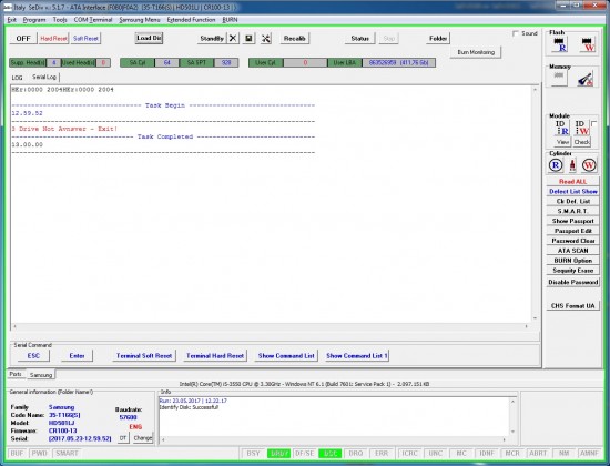

If drive stay always busy, sediv and mrt don't let me do anything, also with this pcb is not possible to make it ready without preamp connection.
I was able to get it in ready status by isolating motor contacts, but i still not able to backup rom and sediv returns me 'DriveNot Answer - Exit!'
However now sediv shows in general information corner the rom version CR100-13 and family name 35-T166(S)
At the moment i don't have another drive for hot swap.
