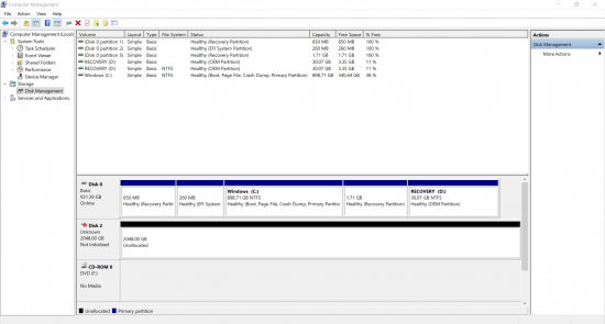

Hello!
I have been trying to run a hard drive, but my pc does not read it at all. When its connected, it make a "click" sound a couple of time, and then its start and do the sound on the pc when something its conected, but does not appear in This PC, and in computer management appears like an "unknown disk, not initialized and unallocated".
I dont know exactly whats the problem, if is software or hardware, i have been reading some problems and maybe is the click sound, that the header (or reader) its not locating the data in the platter, im not sure.
I had clean the pins of the logic card, but still nothing.
It is possibly to rescue the data?

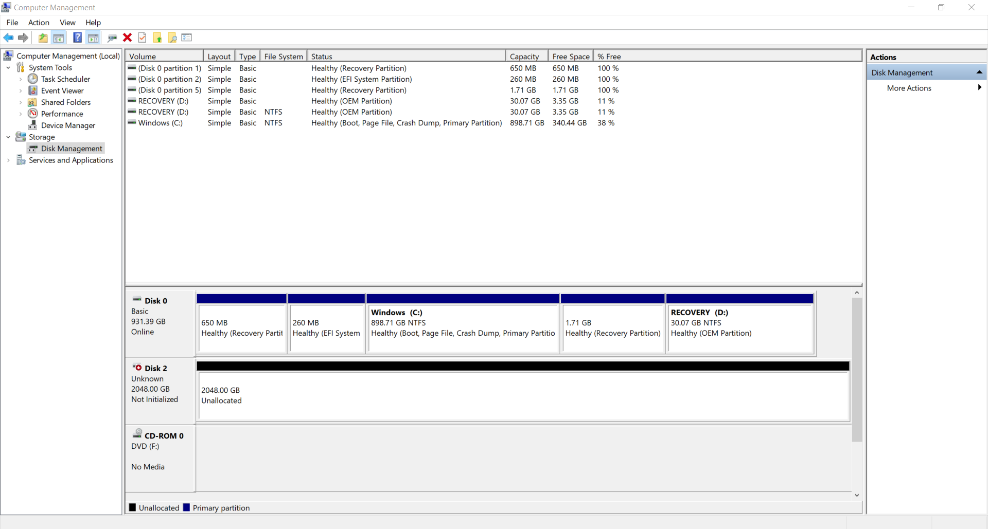

Oh! And the space of the disk, thats strange, the disk capacity is 250gb, and in the computer management says it was 250gb, no 2tb, thats new.

abolibibelot wrote:
since the drive seems to be still recognized with its correct size (2TB, right ?),
No, A 2TB HDD is (normally) shown in Windows OS, as (approximately) 1862.65GB (which is actually 1862.65GiB)
The OPs HDD shows 2048.00GB
