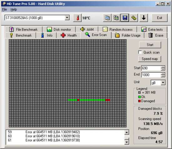

seagate st31000528as
bsy fix executed by user. with no success.
Now Hdd seems but data lost. sector readable.
he says there are more than 700 gb data in it.

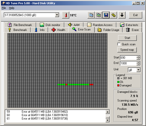

there are some bads at the beginning and all bad after the 699 gb.

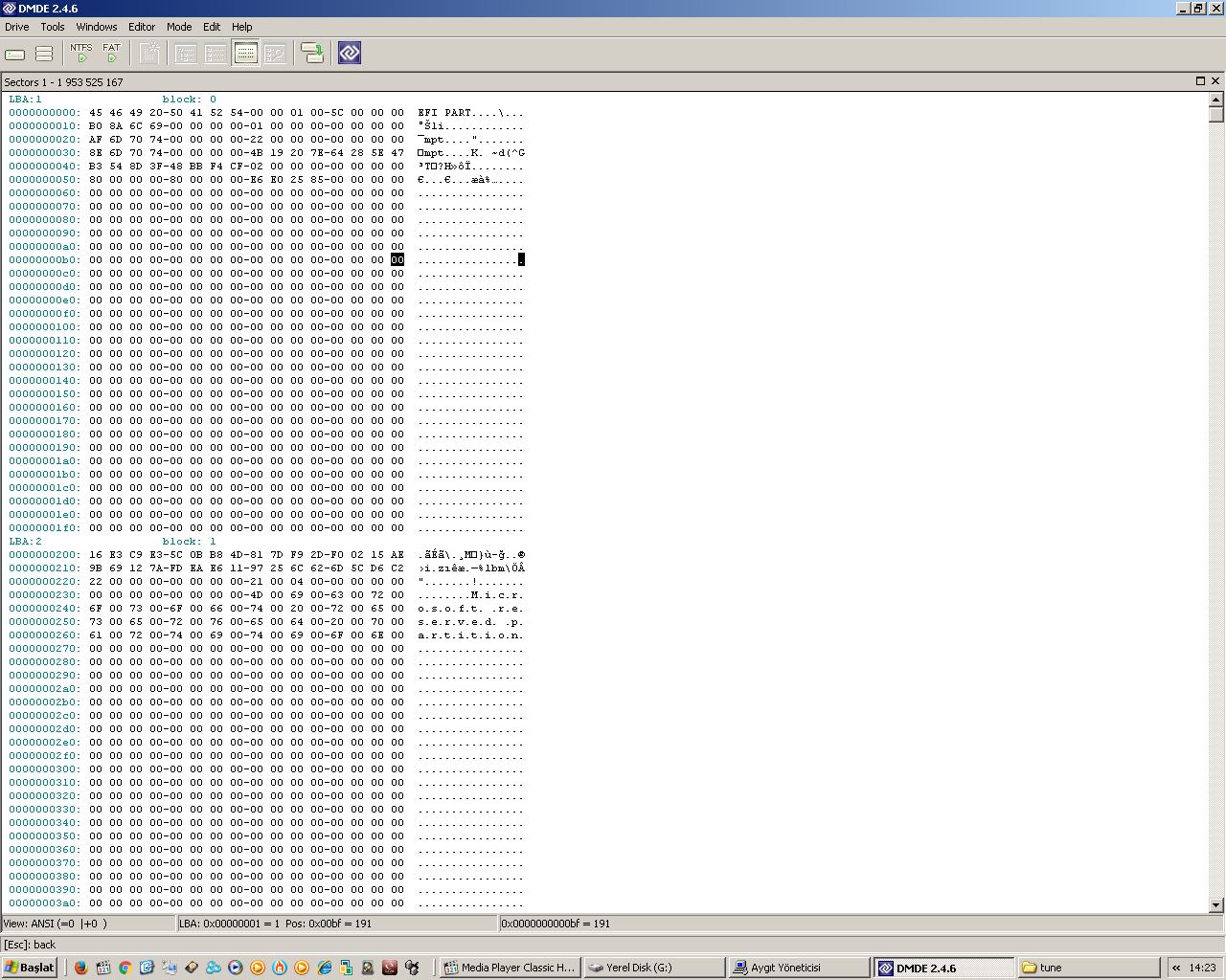

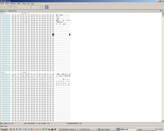

data can't visible at all. All LBA with 0 except first. Why?
because of MFT record area has bad sector?

interesting with busy fix, all LBA's 0.
are you absolutely sure that all LBA's are zero 0000 ?

he clears G-List by i4,1,22
and translator regenerate by m0,2,2,,,,,22
sectors aren't partial now. it's readable... but the data flys..
i think last heads gone...

I THINK ITS PSA ( Partial Access Problem) ++++++++
1. YOU TRY REVERSE CLONING
2. CHECK NRG LIST IN TERMINAL
