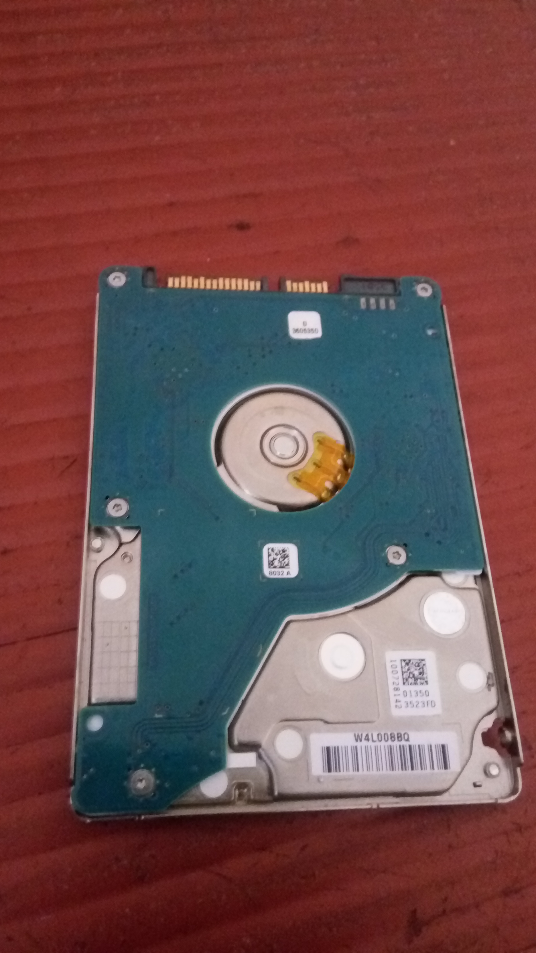

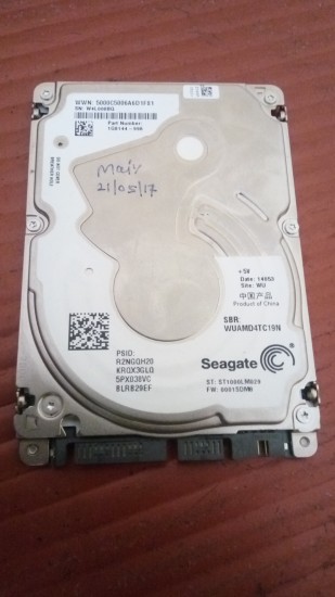

Has anyone successfully recovered data from this LM series drives. picture of hdd attached below

drive is not spinning , but i can hear buzzing sound . when i connected to terminal i get message like
" Boot 0x20M
Flash Boot
Spinup Timeout
(03h)-Serial Port Not Ready
Boot 0x20M
Flash Boot
Spinup Timeout".
