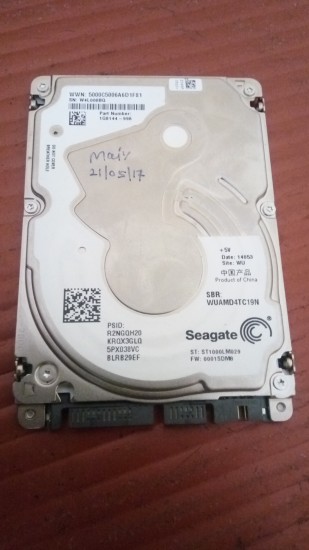

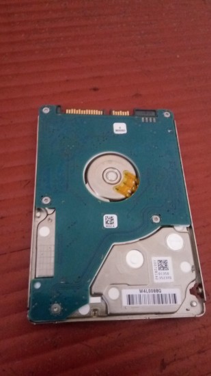

Hi all
Has anyone successfully recovered data from this LM series drives. picture of hdd attached below

drive is not spinning , but i can hear buzzing sound . when i connected to terminal i get message like
" Boot 0x20M
Flash Boot
Spinup Timeout
(03h)-Serial Port Not Ready
Boot 0x20M
Flash Boot
Spinup Timeout".
 Post subject: Re: ST1000LM029
PostPosted: June 17th, 2017, 8:50
Posts: 242
if buzzing sound problem in your spin motor jam ....
if you have clean room chamber plz try this link and don't risk be carefull
https://www.youtube.com/watch?v=WNJqTPutrJ4
