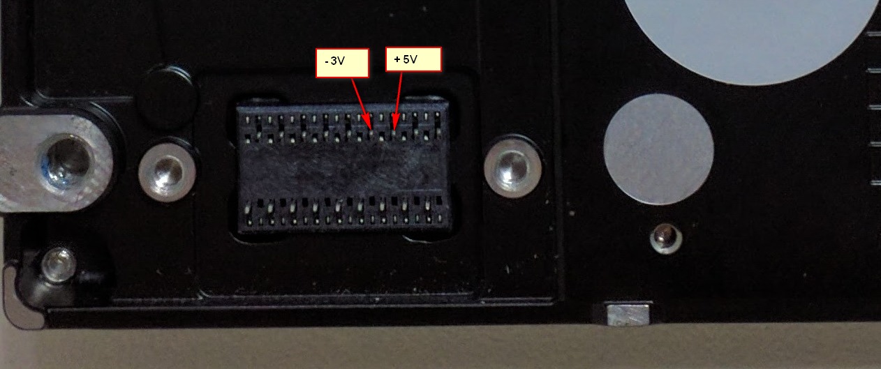

Motor driver IC. In this case you can get burnt preampifier or heads on the platters.
HSA shield with contacts - check voltage pins, at least, before using donor PCB. If it has no short circuit with common point or have no a very small resistance bidirectionally - it is good sign.

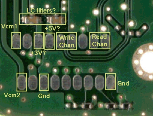

Are you sure about your voltage test points? They seem like signal pins to me.
I would have guessed that the LC filters (?) would be in the supply paths.

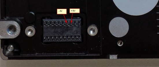

You are right, it's my fault, I'd put a picture for M8 family, but this is a M7E family.
Here is correct:
