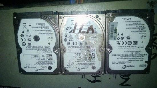

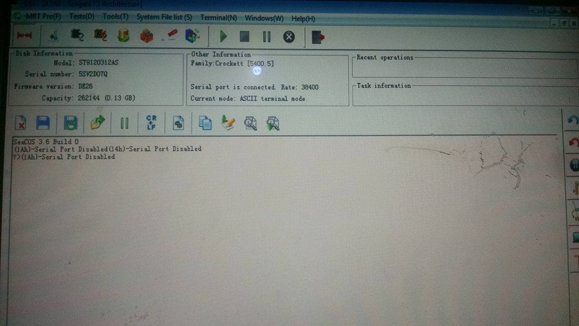

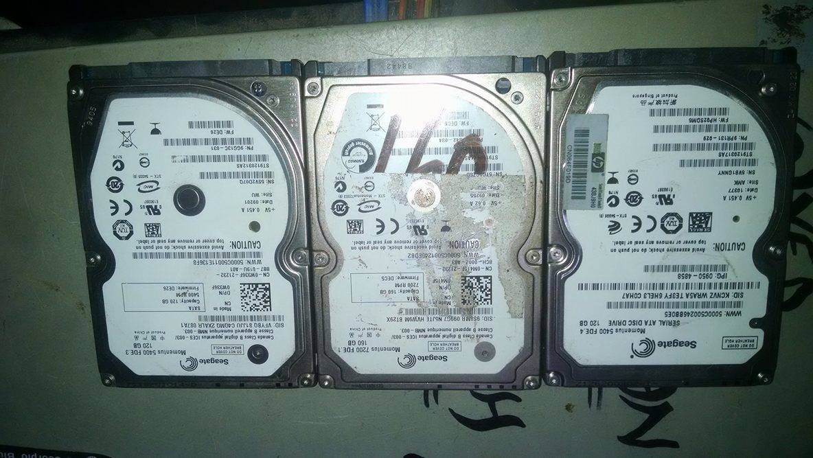

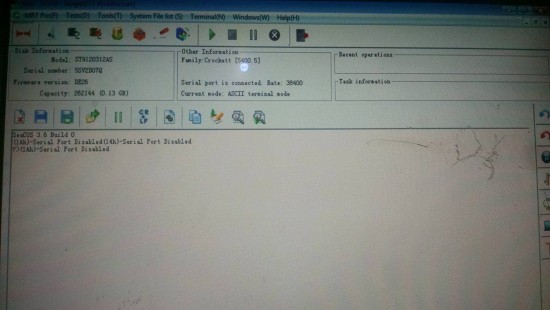

i have some drives showing port lock disable on terminal
and showing total capacity 0.3gb.
family Casy and crockett 5400.4
is there any solution.
 Post subject: Re: Serial port disable Seagate FD.1 ,FD.3
PostPosted: July 9th, 2017, 16:05
Posts: 849
FDE means Full-disk encryption . The only solution - get the key.
