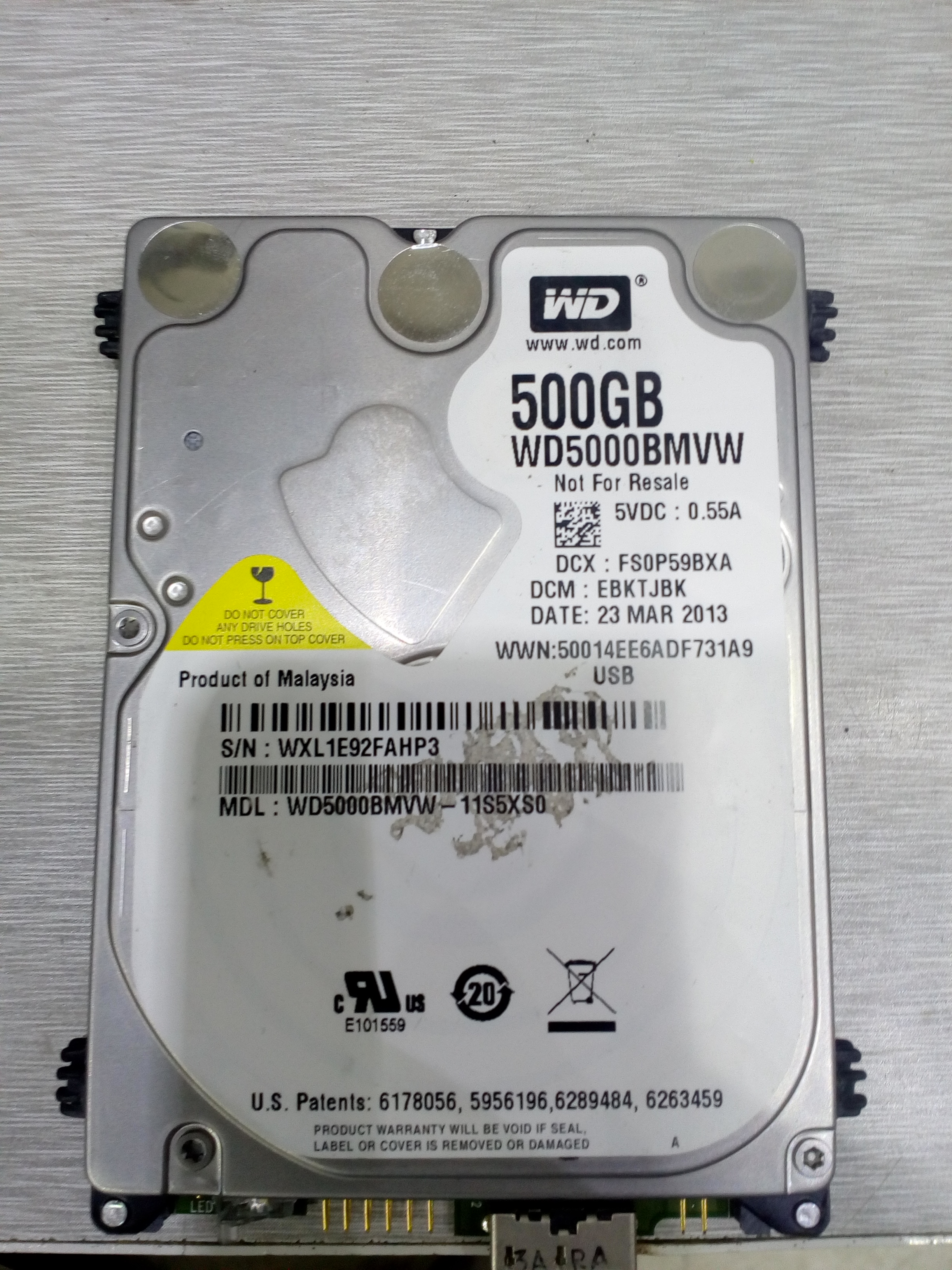

Here's the drive front label.

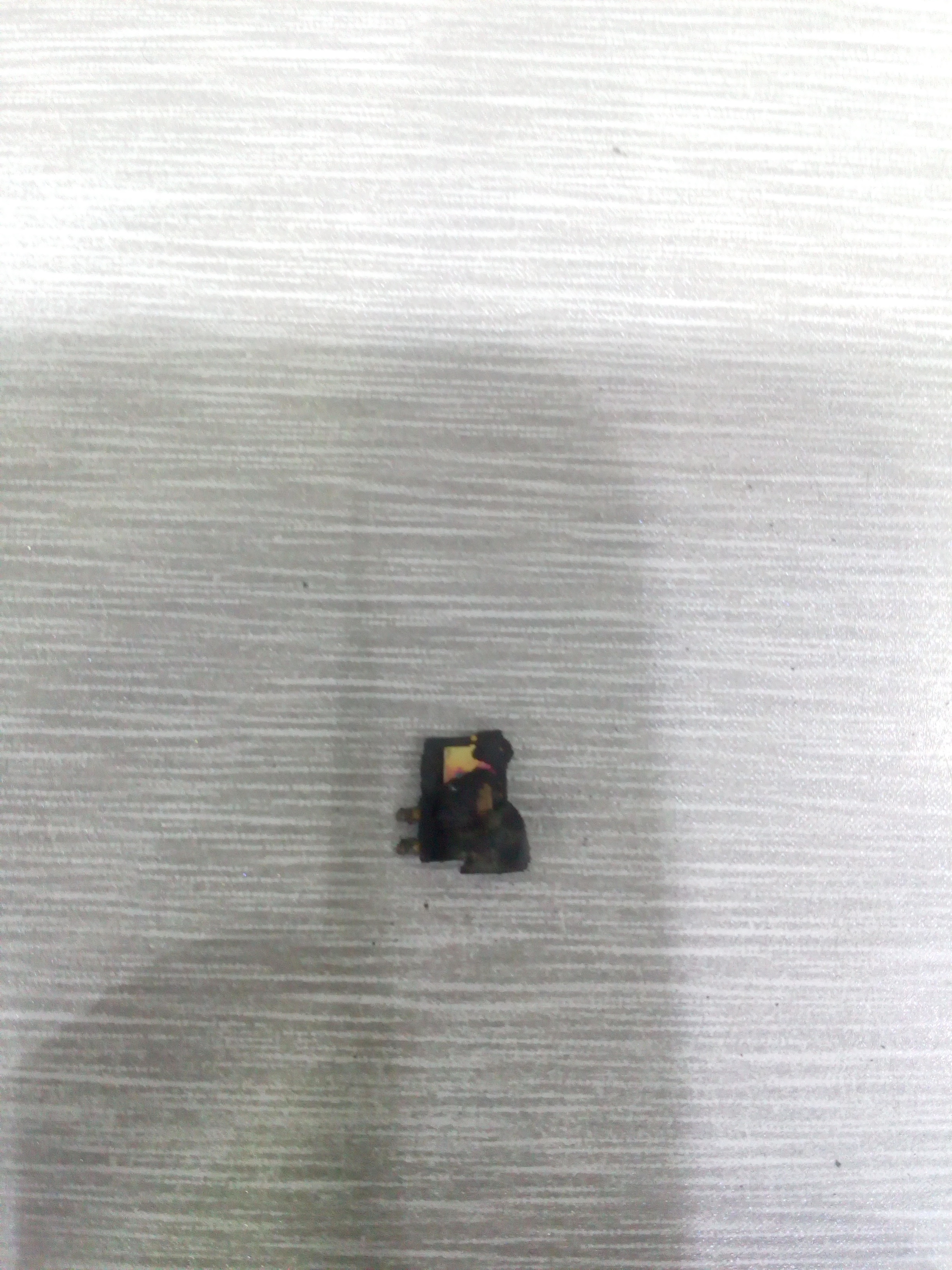

Post a picture of your damaged rom chip. Many "slaughtered" chips can still be accessed.

The guy applied too much heat already

PostPosted: July 2nd, 2017, 12:46
Wow, too much heat indeed!
 Post subject: Re: WD5000BMVW-11S5XS0
PostPosted: July 2nd, 2017, 13:00
And that kids, is why you never use a flamethrower to remove a ROM chip :lol:
This is exactly what's wrong with people doing DIY recovery.
Auch, reading out that one is not an option any more.
