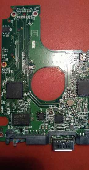

Hi all Gurus!

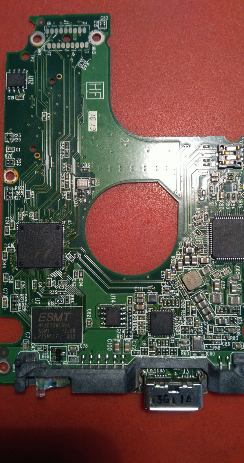

I have here a clicking WD drive.
i need SATA adaptation points to diagnose it better (i have no donnor PCB)
my PCB is:
2060-771949-000 REV P1
i atach Picture.
Thaks in advanced

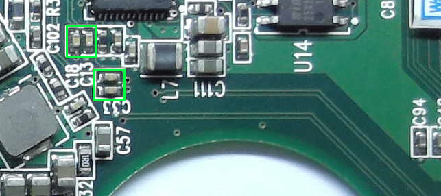

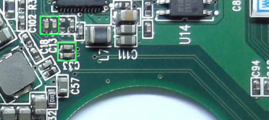

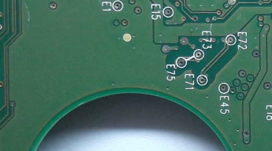

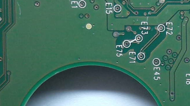

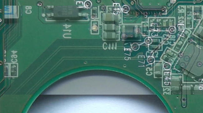

I believe you want to remove the capacitors marked in the following and connect your data lines to E71-E73, E75. I'll let you figure out which are Rx +/- and Tx +/-.

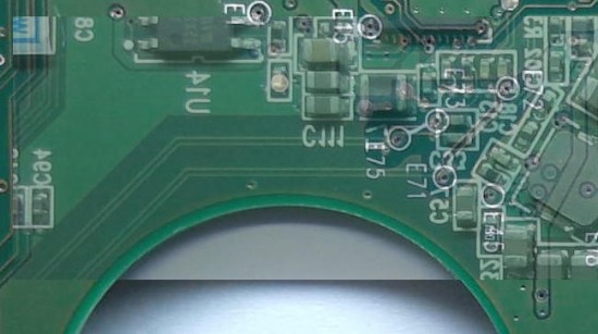

BTW, you can figure the above out by taking high-res images of each side, flipping the component-view image horizontally, overlaying the two with 50% transparency, aligning them and then combining them into a single image, as shown below. That lets you see where the Rx/Tx lines connect to the coupling caps.

 Post subject: Re: You know USB to SATA adaptation Points on a 2060-771949
PostPosted: July 5th, 2017, 11:20
Posts: 811
Location: World
i suppose:
c13= a+
c13= a-
But
c33 = XXXX?
cNoNumber = XXXX?

As a general rule, locate a SATA PCB with the same MCU and follow the SATA Tx/Rx differential pairs from the MCU to the SATA data connector:
http://ep.yimg.com/ay/yhst-14437584971410/2060-771959-000-14.gif
