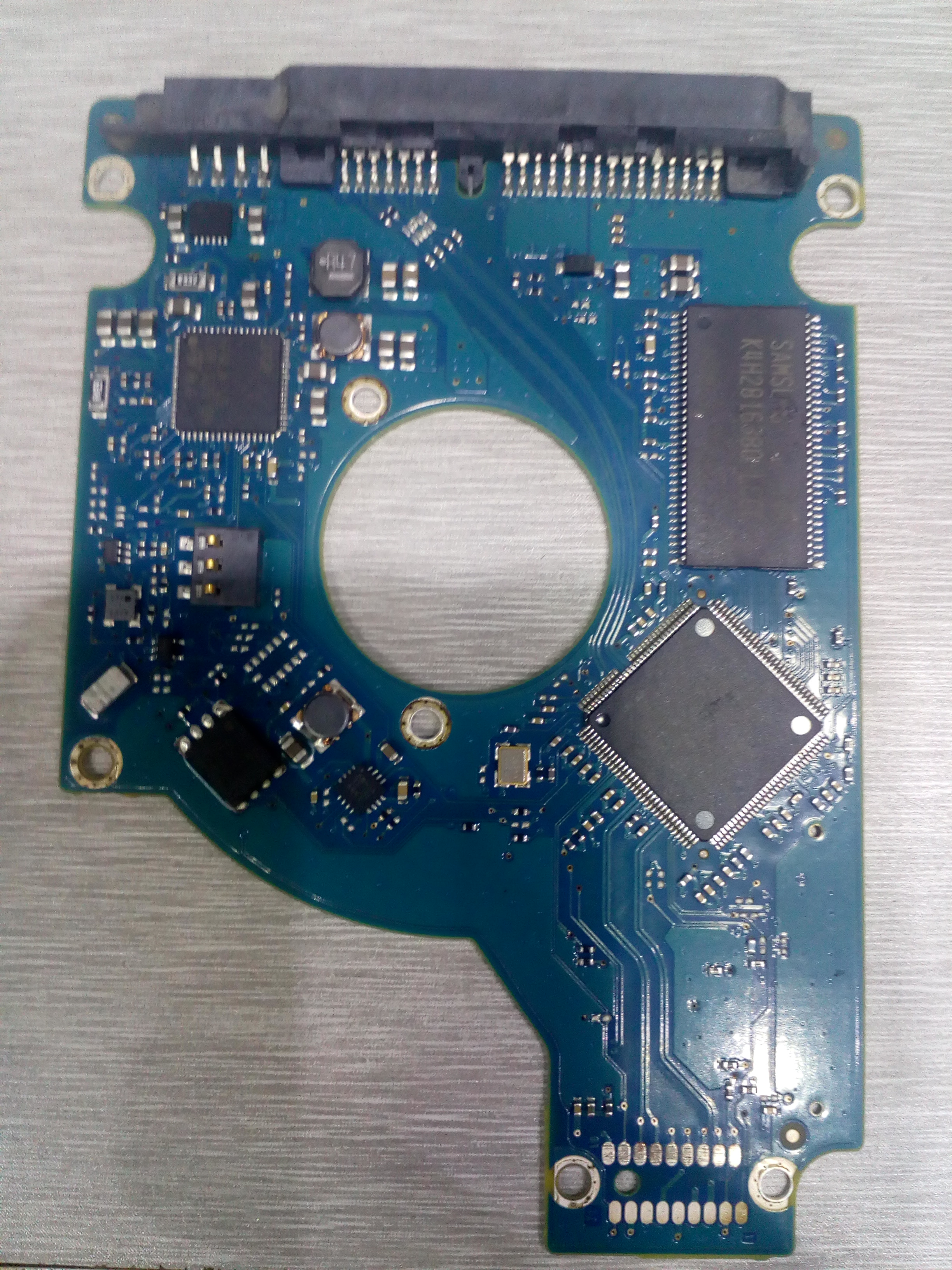

Hello
The drive in topic spinning normally and shows (busy).
Terminal output:
EarlySpinup Enabled
Rst 0x10M
ASCII Diag mode
F3 T>
LED:00000067 FAddr:003851A2
Any thoughts?
Thanks in advance.
 Post subject: Re: ST9750420AS
PostPosted: July 11th, 2017, 19:59
Posts: 17335
I don't think it helps but ...
0x67 UNDEFINED_INSTRUCTION -- Undefined opcode exception
The error would suggest that the firmware has become "lost".
PostPosted: July 12th, 2017, 5:23
Posts: 1748
Thanks for reply fzabkar, Doomer and Martin.
Heads are perfectly working on a donor drive.
I would like to know the read channel points. I will post the PCB pic.
Thanks in advance.
PostPosted: July 12th, 2017, 6:11
Posts: 1748
With PCB isolated:
EarlySpinup Enabled
Rst 0x10M
ExecuteSpinRequest
LED:00000067 FAddr:00380340
PostPosted: July 12th, 2017, 6:50
Posts: 1748
Thank you Martin.
With Donor PCB and donor ROM the drive become ready and reach F3.
Is that mean patient ROM corrupted?
PostPosted: July 12th, 2017, 7:58
Posts: 219
It means there is a coruption in SA. Probably, overlay.
