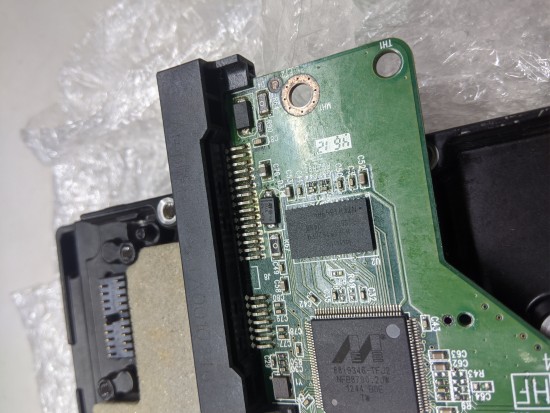

So I've had a 1 TB HDD of mine sitting in the storage for about 7 years now. Now that's when i decided to finally try to attempt repairs on it i made some progress.

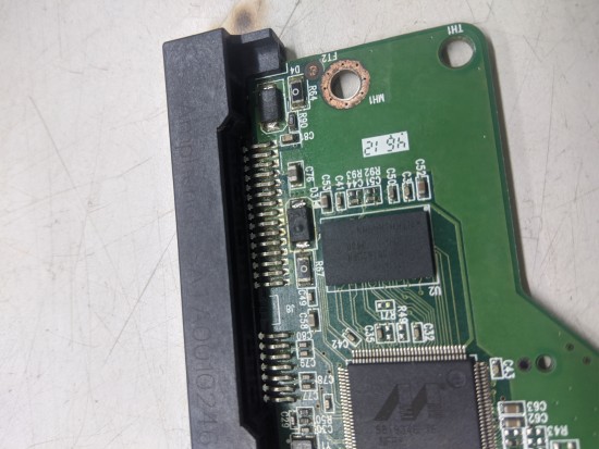

The fault was that the interface board was damaged when 13 yo me plugged the power connector upside down so that the 5v rail got 12v and vice-versa for the 12v. and in result the interface board shorted and when plugged back resulted out in the board just getting heated.
So i did took took out the board and found that the diode shorted out : https://imgur.com/EuDGKhi.jpg

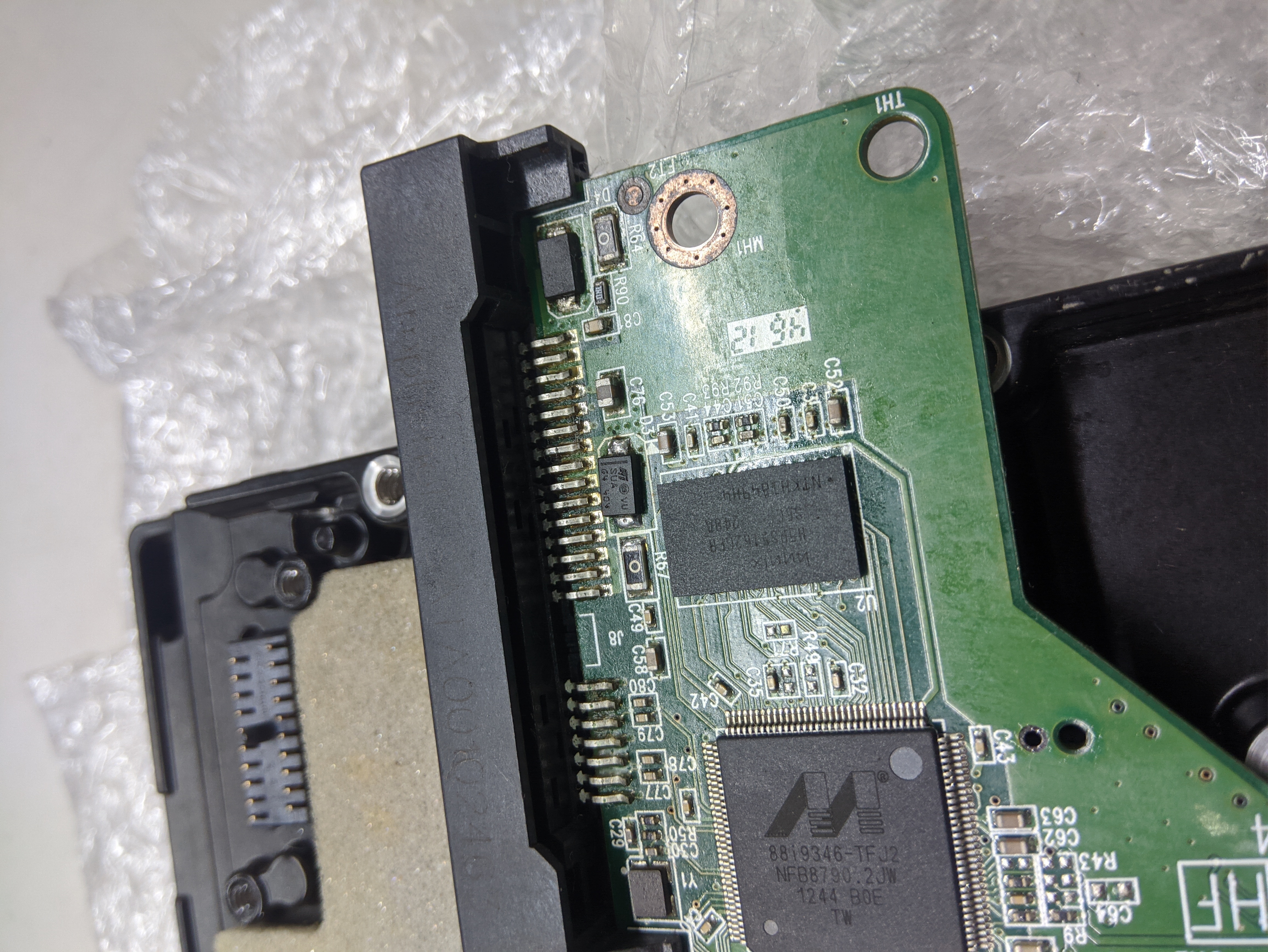

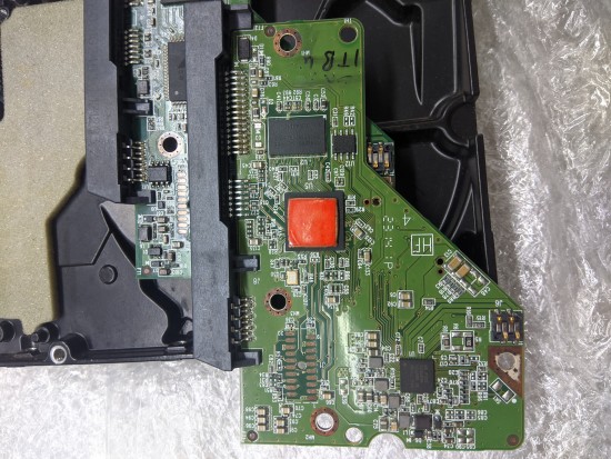

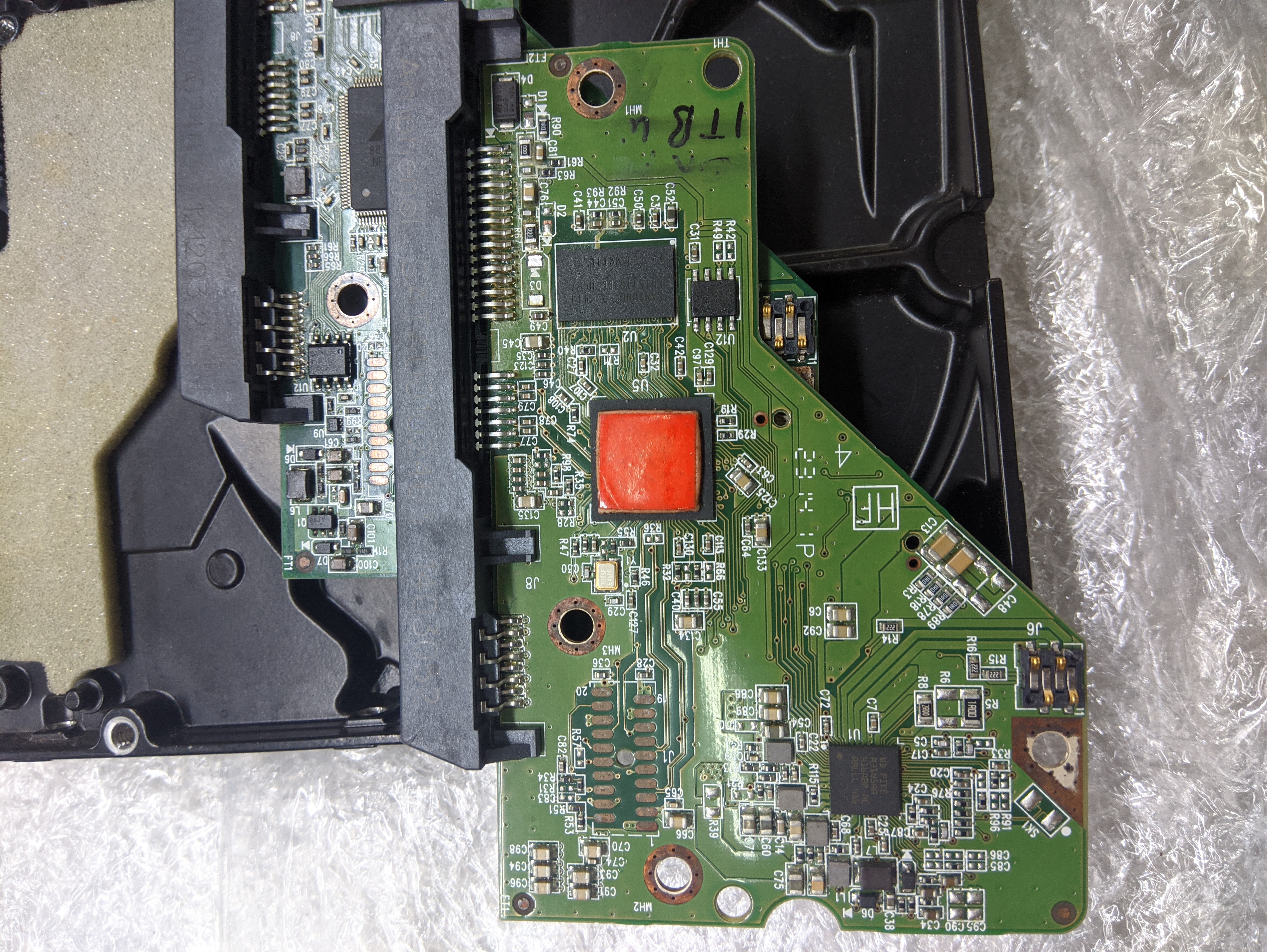

then i tried to replace it from a donor board and might have successfully done it too : https://imgur.com/bV8SJyP.jpg
also the donor pcb isn't the same so i just replaced the diode and nothing else. Donor Board PCB : https://imgur.com/VOtA9Tc.jpg
Now the HDD spins and when connected via a SATA2USB adapter, it is recognized and even installs the drivers but no partitions or devices are detected in Disk Management and Device manager. Also i tried plugging directly into a PC but it's not detected in the bios although BIOS screen takes time to load when the HDD is plugged it (Maybe it's trying to read it) So before trying out anything else i just wanted to clarify on what i need to do next because i really don't wanna ruin it further.

It's WD Green and i've attached the images.
File comment: The Donor PCB. (Not the same model)

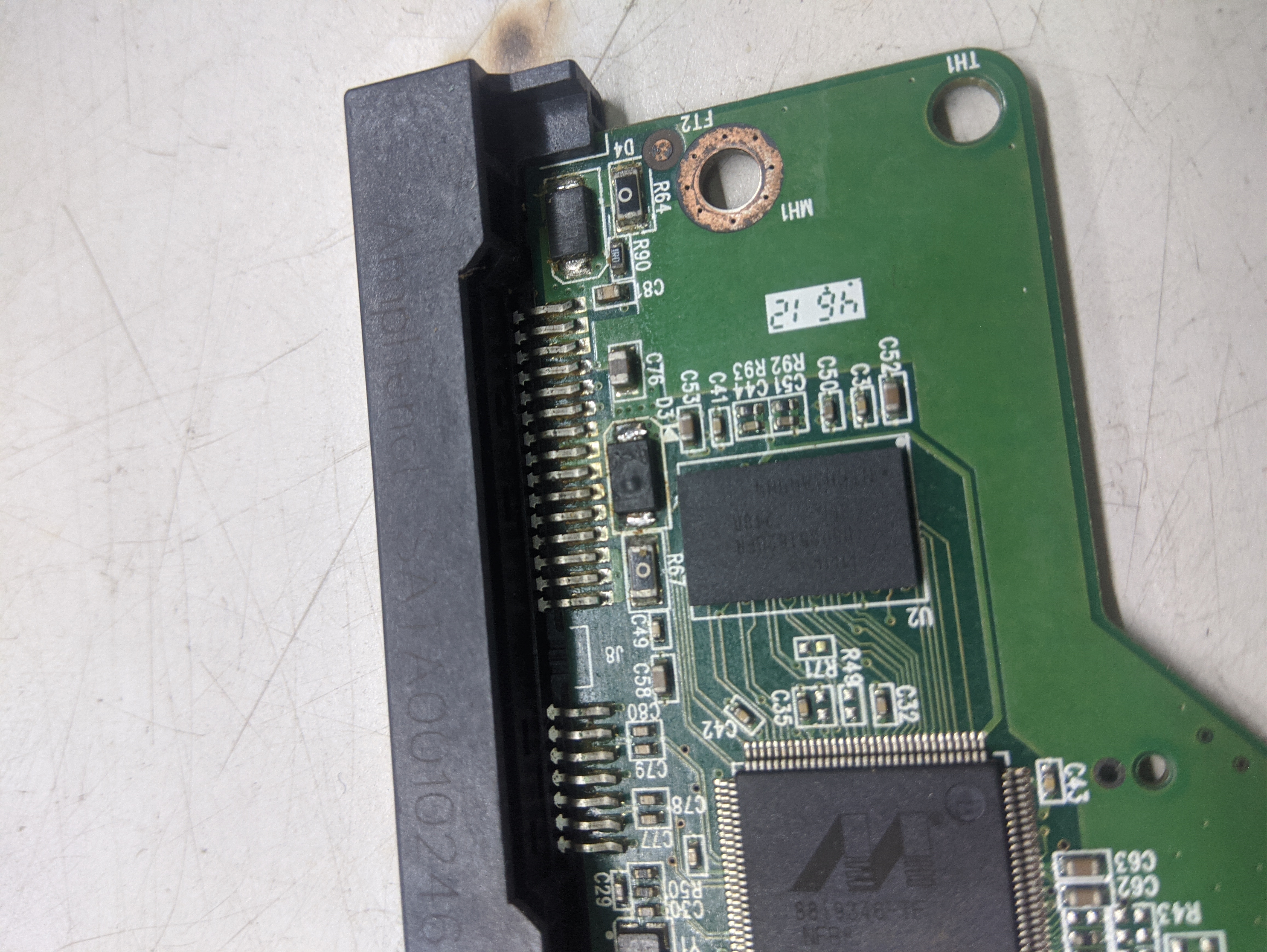

File comment: This is the diode which i replaced from the donor pcb.
File comment: Original Diode that got fried.

I'm not too sure how you can plug the sata connector the wrong way round, but if this is the case, I feel the damage might be extended. I am not sure but I think the protection on WD drives is crap and you could have a blown pre-amp inside the drive. I'm not sure others more experienced might know the answer. Wait for more comments and DO NOT OPEN THE DRIVE.
 Post subject: Re: HDD isn't detected but Spins and Installs Drivers on fir
PostPosted: November 24th, 2020, 13:24
Posts: 4816
plugging the sata connector the wrong way should not damage anything coz it has on connections at the opposite side. It can be done if either the cable connector or the hdd socket is broken.
I guess it was attached to a Molex connector with a sata power adaptor cable and you reversed it at the Molex side, didn't you?
There are multiple problems:
-your donor pcb is not compatible with your patient drive, it is from a different family.
-the patient pcb is badly designed, it has the fuse (0ohm resistor) connected at a wrong location, thus providing protection for the TVS diode instead of the circuit behind it. So it is quite possible that the 12V entered into all the circuits running from 5V including the preamp inside the HDA, which means two additional things:
- not possible to recover without replacint the head assembly
- data may be severely damaged if a working pcb is attached to this HDD and started because the burnt preamp may feed current into the writing heads, which erases any data that comes its way.
So it is quite important to rule out every possibility before attaching a new pcb.

check the 0 ohm resistor at the left of the blown diode (R67) with a multimeter in diode mode (continuity). It should measure as 0000 or close to that.
if it is broken open, then we can take it for 99.99% that preamp is busted. There a few members from India who can recover it for you.
Dunno, only Amarbir came to my mind but i am sure there were others as well...
Apologies for a late reply.
I have checked it and just checked again. The resistor is OK at 0ohm. So i guess the Preamp is OK?
