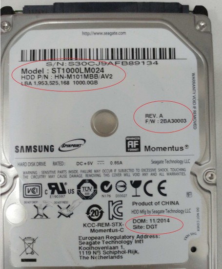

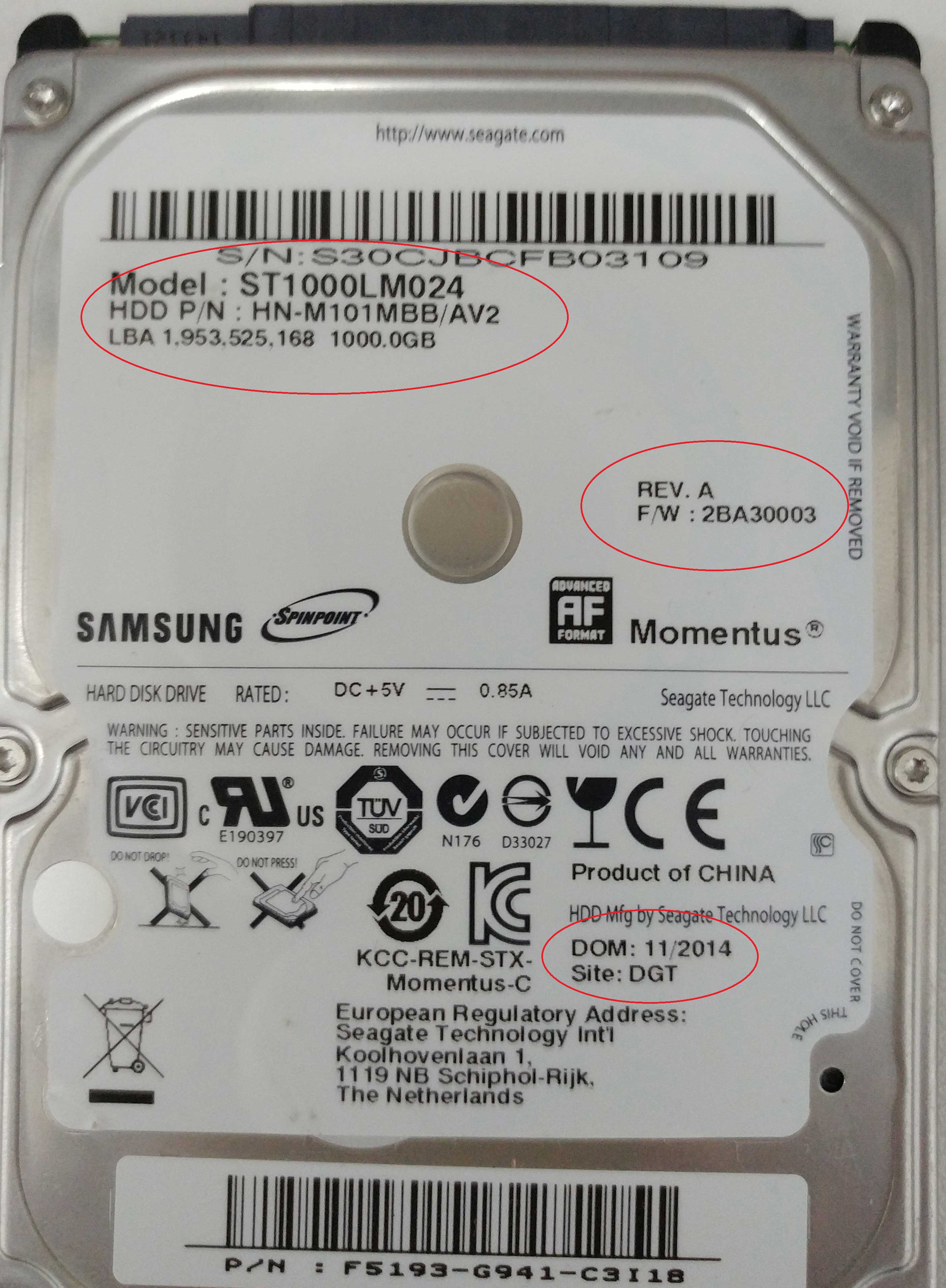

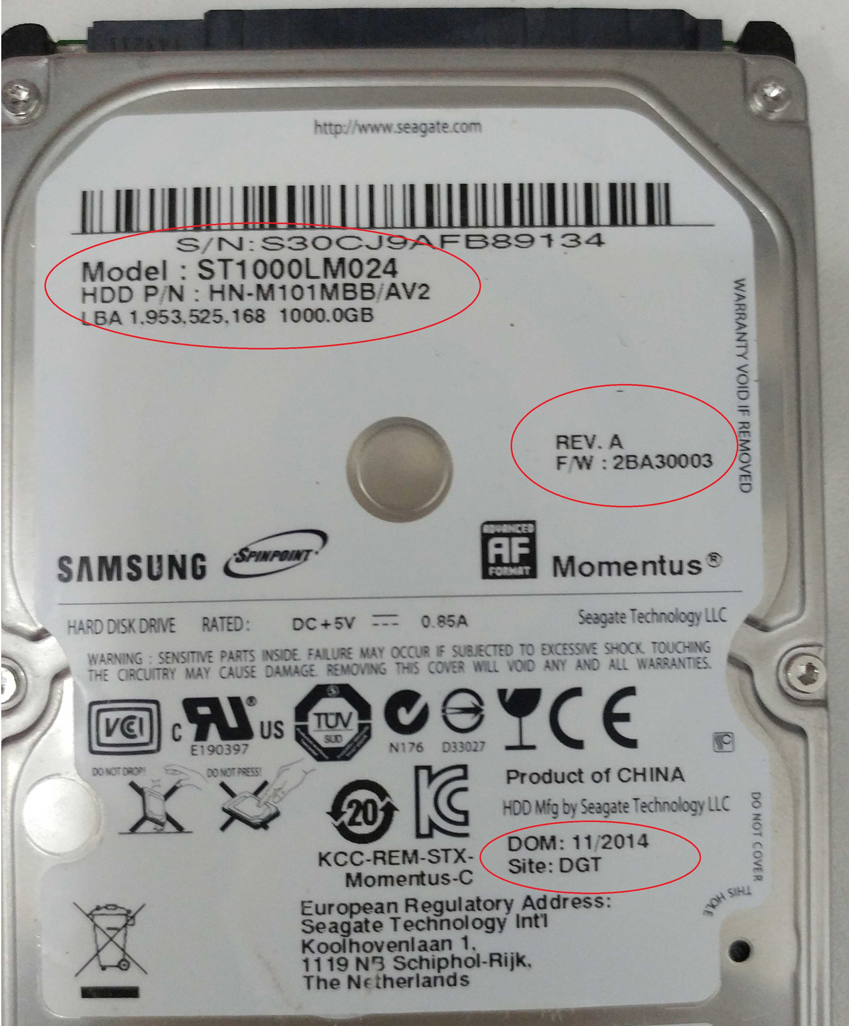

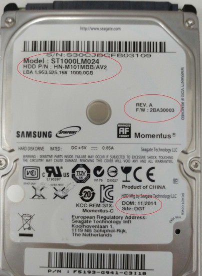

I have a Seagate/Samsung drive ST1000LM024 that had an issue with its heads after it felt down.
When I changed heads with an exact drive, the drive doesn't spin at all (it stuck on BSY).
When I put Donor PCB on the Patient drive (after heads were changed), drive spin well without clicks but doesn't reach readiness (of course because it has donor ROM).
So I thought it was an issue with patient PCB too, so I transferred Patient ROM on Donor PCB and put it on the Patient drive. Now drive doesn't spin at all (it stuck on BSY)
Please, any advice or help, I'll be thankful.
Kind regards

What's the PCB number of both patient & donor?

For the PCB number, it's the same Seagate PCB number for both HDDs: 100720903 04

The drive in topic must be Samsung M8 not Seagate. And the PCB # must ends with REV.03, 06 or 07.
 Post subject: Re: Samsung ST1000LM024 head change strange case
PostPosted: July 15th, 2017, 7:45
Well,
See The First Post And The Pictures ? .
