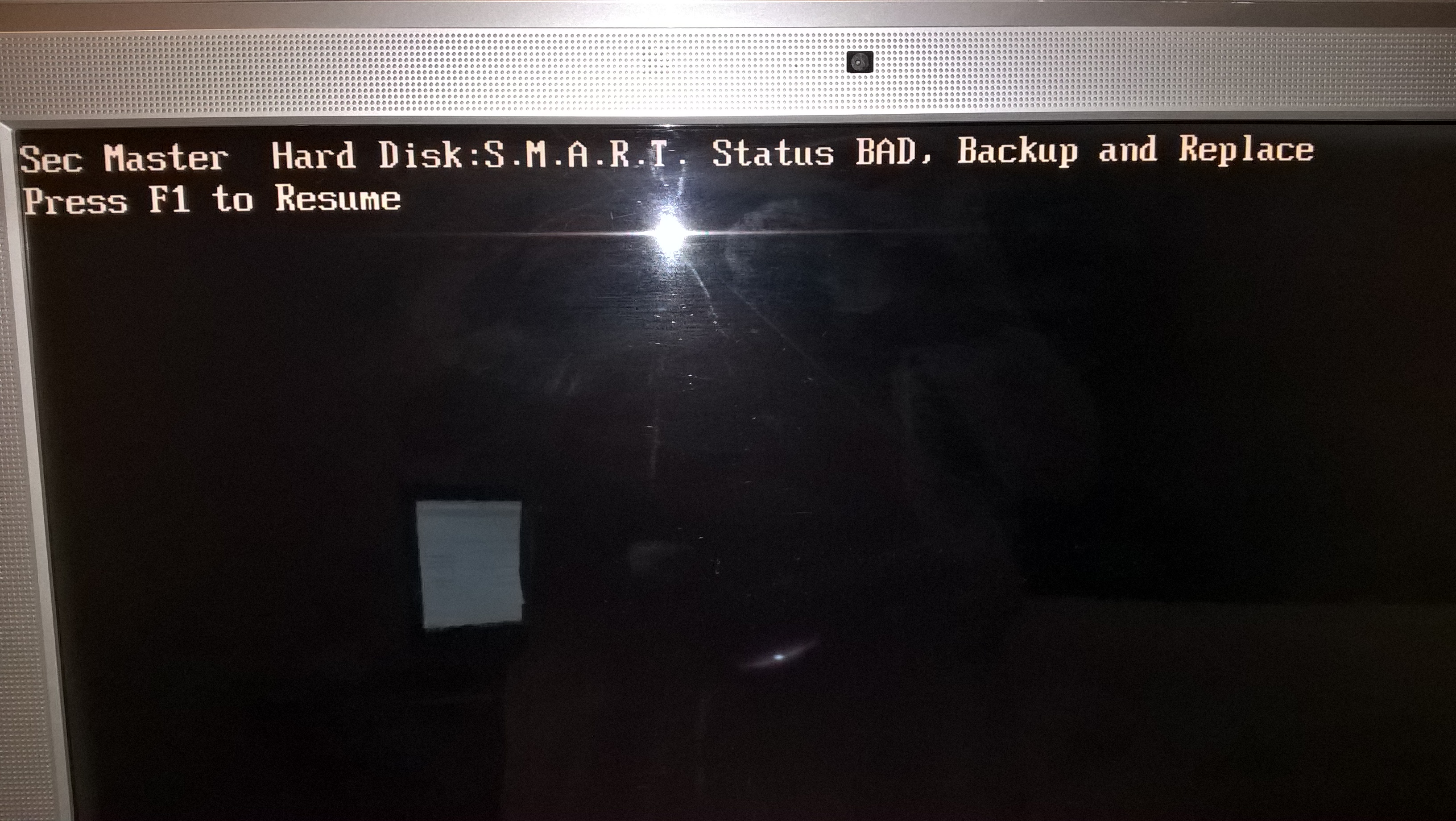

Hello I updated my ST3500820AS that had original firmware (and have no backup of) SD26 to SD1A. Now I receive the following error message: S.M.A.R.T. Status BAD
File comment: S.M.A.R.T. Error
Can this error be fixed, if so please point me in the right direction?

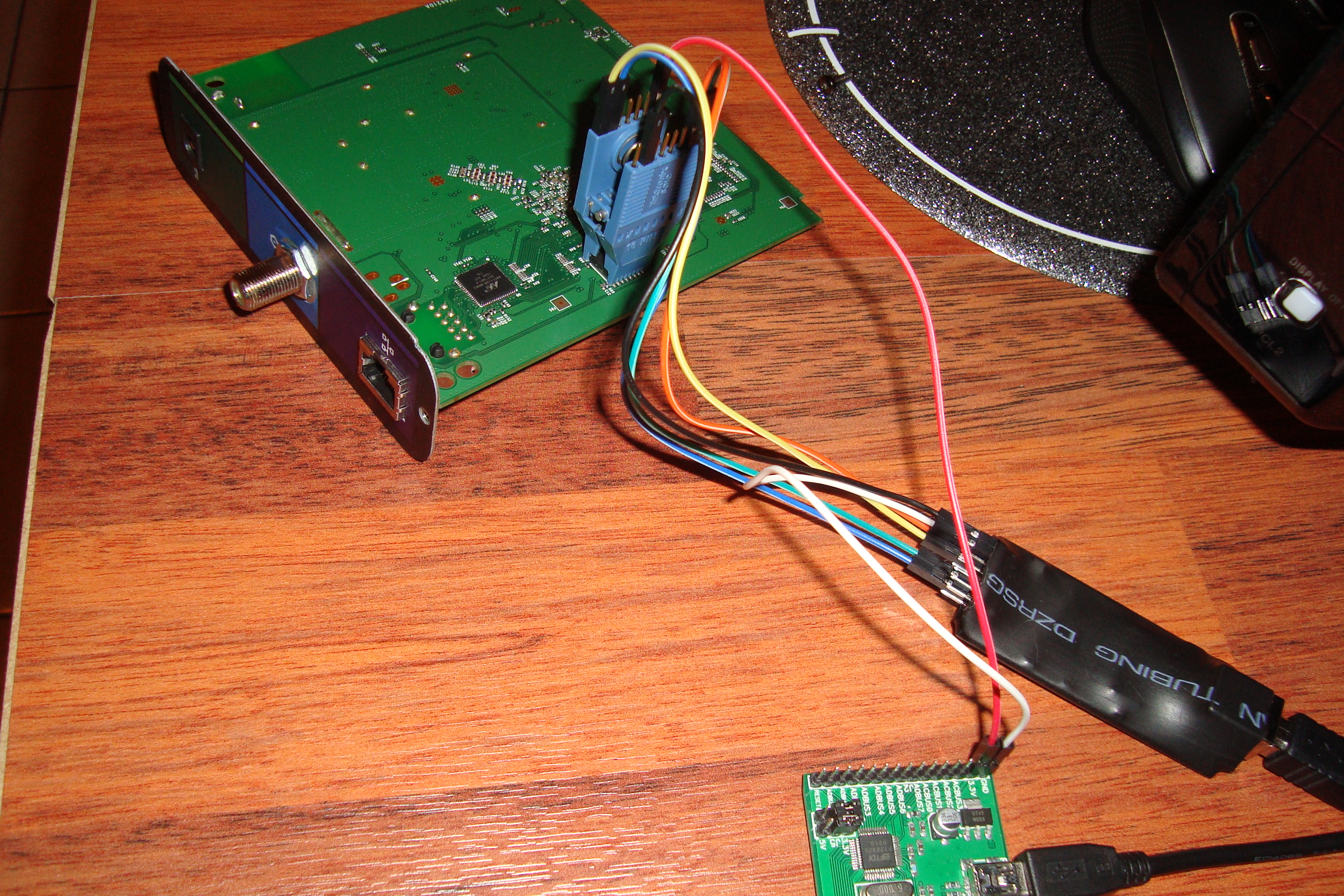

I am not a n00b to JTAG, SPI and Serial flashing when it comes to Modems, Routers and Wireless Access Points but I have NEVER done it on a HDD before.
File comment: SPI Flashing my Modem

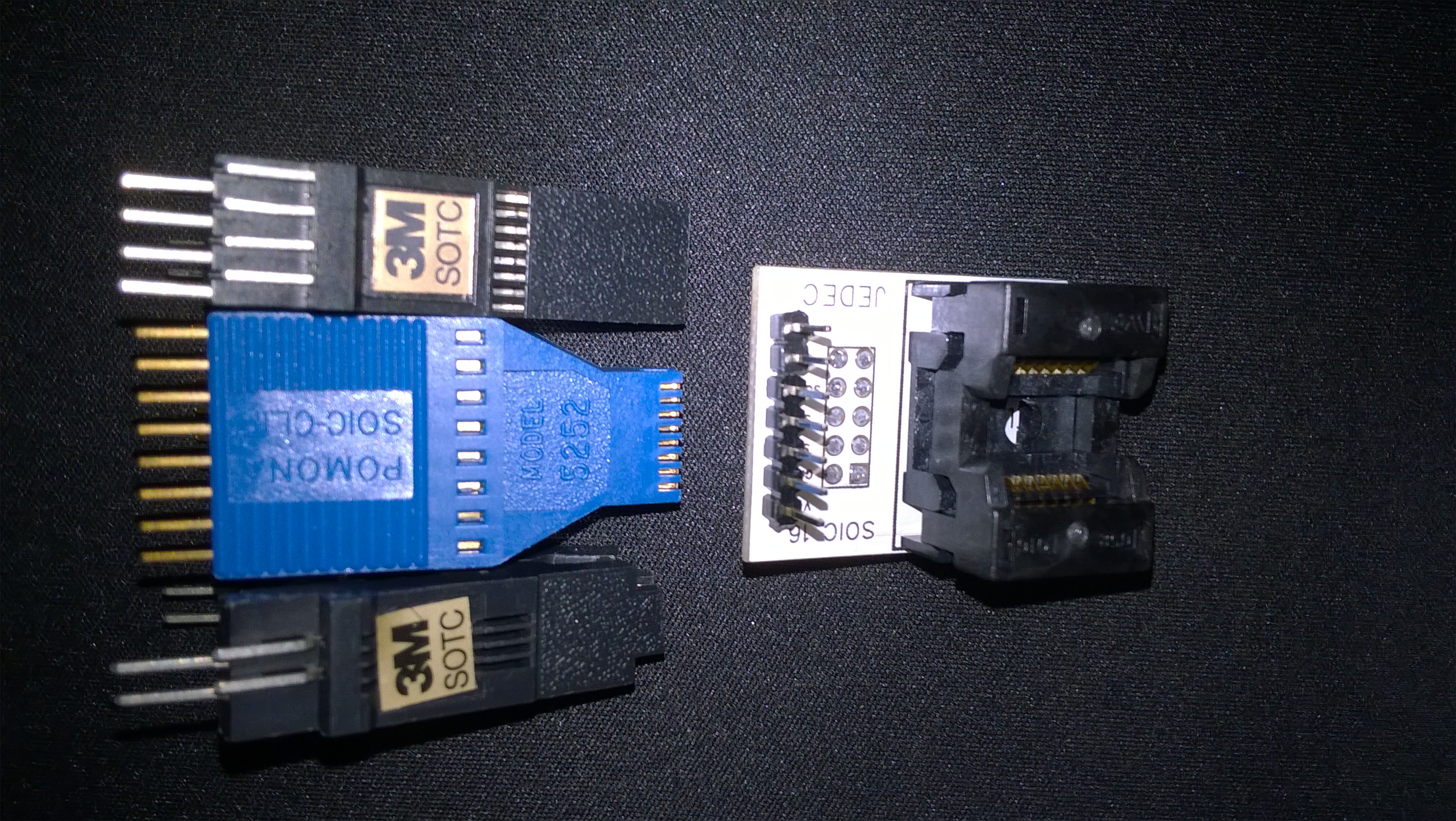

I have all the tools necessary including Pomona and 3M SOIC 8 and SOIC 16 Test Clips, I can read and write the flash using FlashcatUSB or a USBJTAG, I also have a UART USB adapter if serial needs to be used.
File comment: SPI Tools

your drive might 'only' need clearing smart by sending cmd 'N1' on level 1.
there is plenty of info on this forum about how to connect a serial port to the drive, then you attach power to the drive (sata is not needed), open the serial port in something like hyper terminal or putty, press ctrl-z, type '/1<enter>', 'N1<enter>'
Watch it for any errors (post here if any).
Check if AltList has any entries:
'/TV4<enter>'
post the full log here.

so it has a bunch of reassigned sectors, i would replace it as soon as possible.
