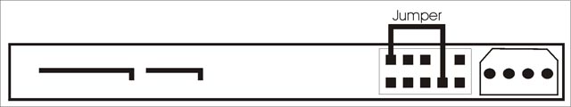

maxtor diamond 10 250 gb ata 133 (ide)
i need rx, tx, gnd pin connections can cany one help on this?
is my old device his work well i need recovery any files over them.

It is Sabre family, native Maxtor. TTL is avilable via safe mode, it will help if there is a problem with SA.

As I remember, to get into safe mode you have to send signal for initializing a safe mode, not a shorting a pins.

I think Martin is referring for SATA Maxtor drives.

For Sabre family see pic how to connect wire for safe mode:
Yes, I forget that Sabre uses both types of PCB. Didn't work with ATA for a long time.
P.S. As I can see, Michel had provide short pins for SATA (hybrid) as well.
