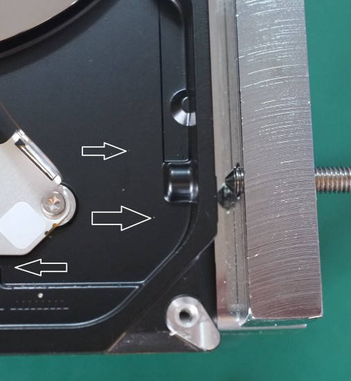

Hello All,
I’m running out of options for a disk I am working on. Any suggestions are welcome. I have a feeling the answer for this one will be ‘media damage’.
Patient:
ST500DM002-1BD142
Z3T…
KC45
TK
Donor – Match on all of above.
Similar symptoms as per: http://forum.acelaboratory.com/viewtopic.php?t=8273
Drive IDs as:
Model : ST_M13FQBL
Serial : QNR_BFW
Firmware : 03011619
Capacity : 3.86 GB (8 089 950)
Disk stays spinning. Terminal output below.
Work so far:
• Tested patient with donor PCB, no change.
• Attempted shorting read-channel with patient heads inside. Cannot get to T> . When shorting at the ‘correct’ time, drive spins down after a number of clicks, but will still will not provide T> .
• Opened HDD, inspected heads under microscope – no visible damage. In the HDA there are small signs of contamination, hard to see silver coloured fragments (Yes, not good I know!)
• Use of donor heads in patient provide the same results. After swapping donor heads back into donor they still work OK.
• Patient heads in donor drive do not work – they have failed.
If there was significant damage to the platter I would have expected the donor heads to have degraded, and not be functional once they were swapped back into the donor. However, the tiny amounts of silver coloured fragments would suggest some media damage, perhaps to SA? More likely than not media damage on this disks, but trying to exhaust all possibilities.
Any suggestions are welcome on this one.

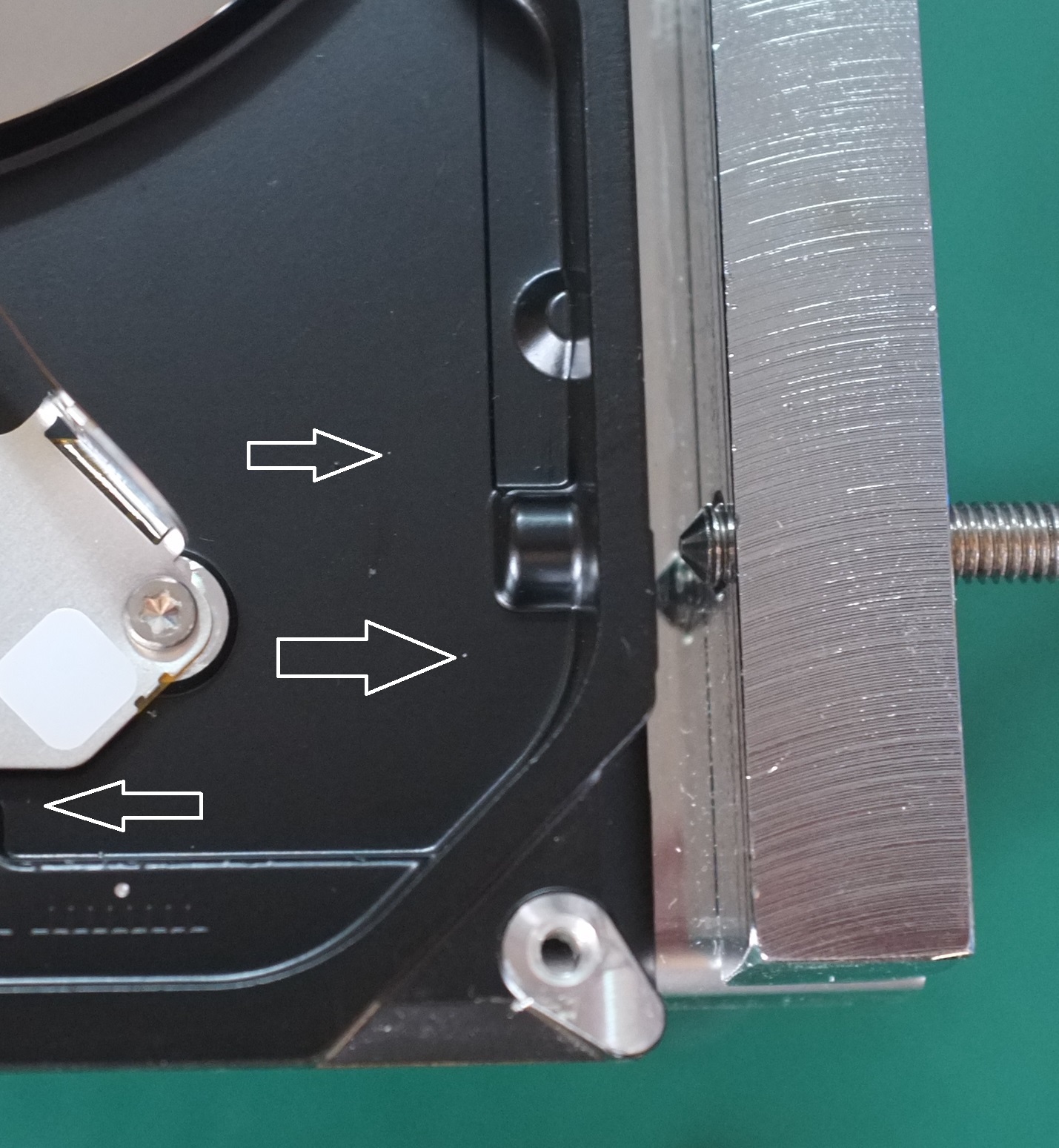

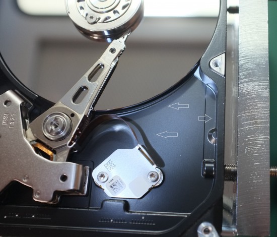

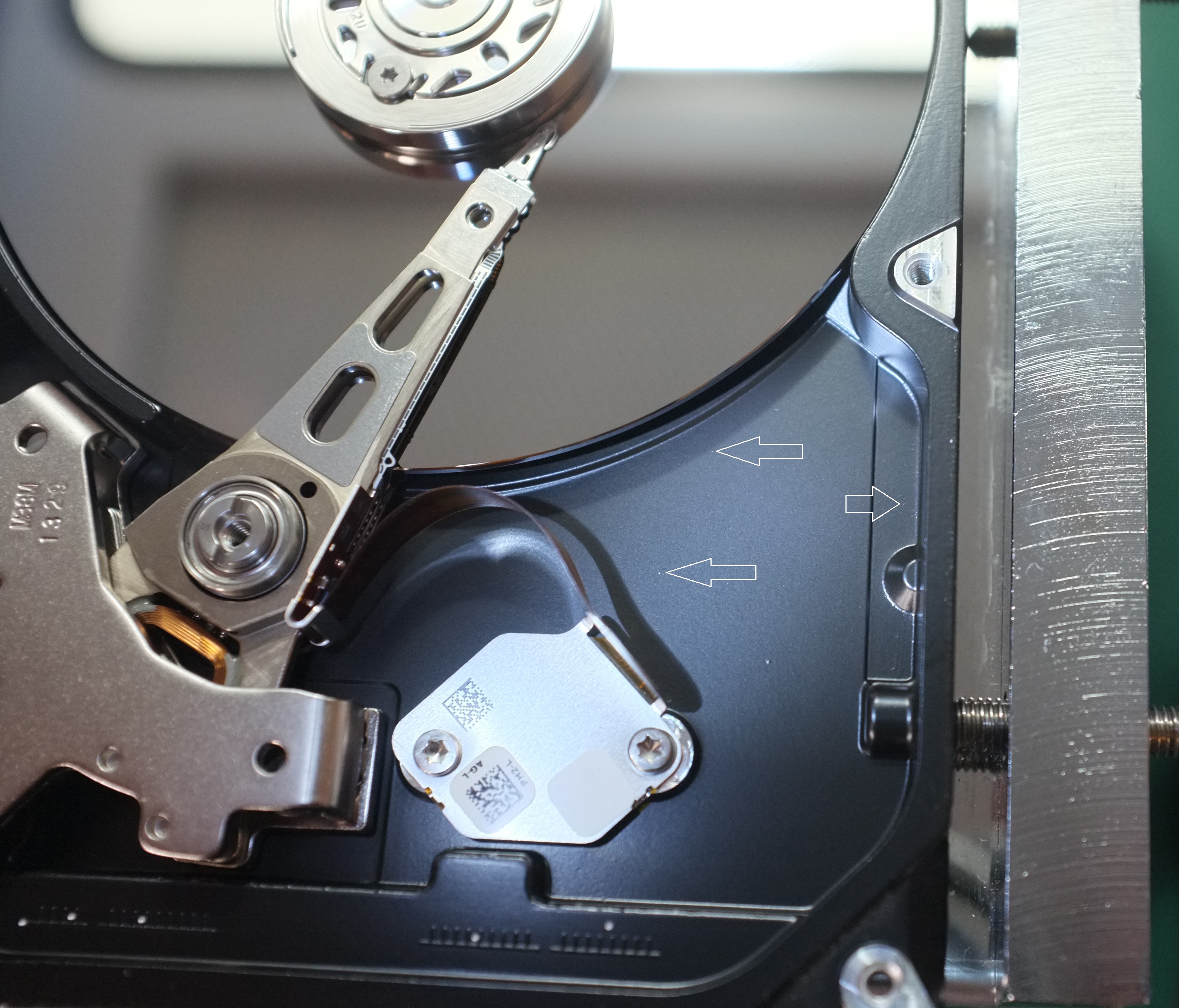

Thank you for the suggestions. I have been trying to bring this one to a conclusion this afternoon with a few checks and re-checks.
Tests conducted:
• Checking whether having head-map adaptives imported into patient ROM aid initialisation. No change on boot. Donor HDD is a very good match in all respects.
• Disabling individual heads in the ROM / changes of head-map. No change.
• Heads from donor still have functionality when placed back in the donor.
Inspection of the HDA shows that there is an increased amount of silver colour fragments. I’ve seen worse and the drive has been recoverable, but the fact that there is more contamination than there was to begin with would suggest to me that there is damage to the platter which is just getting worse. Images below.
Regarding the possibility of a non-native ROM:
In this case the donor HDD was supplied by the customer. Both PCBs were present, and the donor PCB initialises the donor correctly.
The job is from a regular customer, who is reliable, and not someone who I associate with swapping over components (that cannot be said of some the regulars). Therefore, it seems unlikely that a non-native PCB is on the patient. I will make a final check with the customer though. Perhaps there is a second ‘donor’ drive that I have not been made aware of. It seems unlikely though. Assuming that a PCB is not missing, I think it is most likely to conclude that this drive has media damage.
Best regards,
John
File comment: Initial opening. Minor contamination. Silver fragments highlighted with arrows.
File comment: After head-swap. Additional contamination. Silver fragments highlighted with arrows. Suspected media damage.
