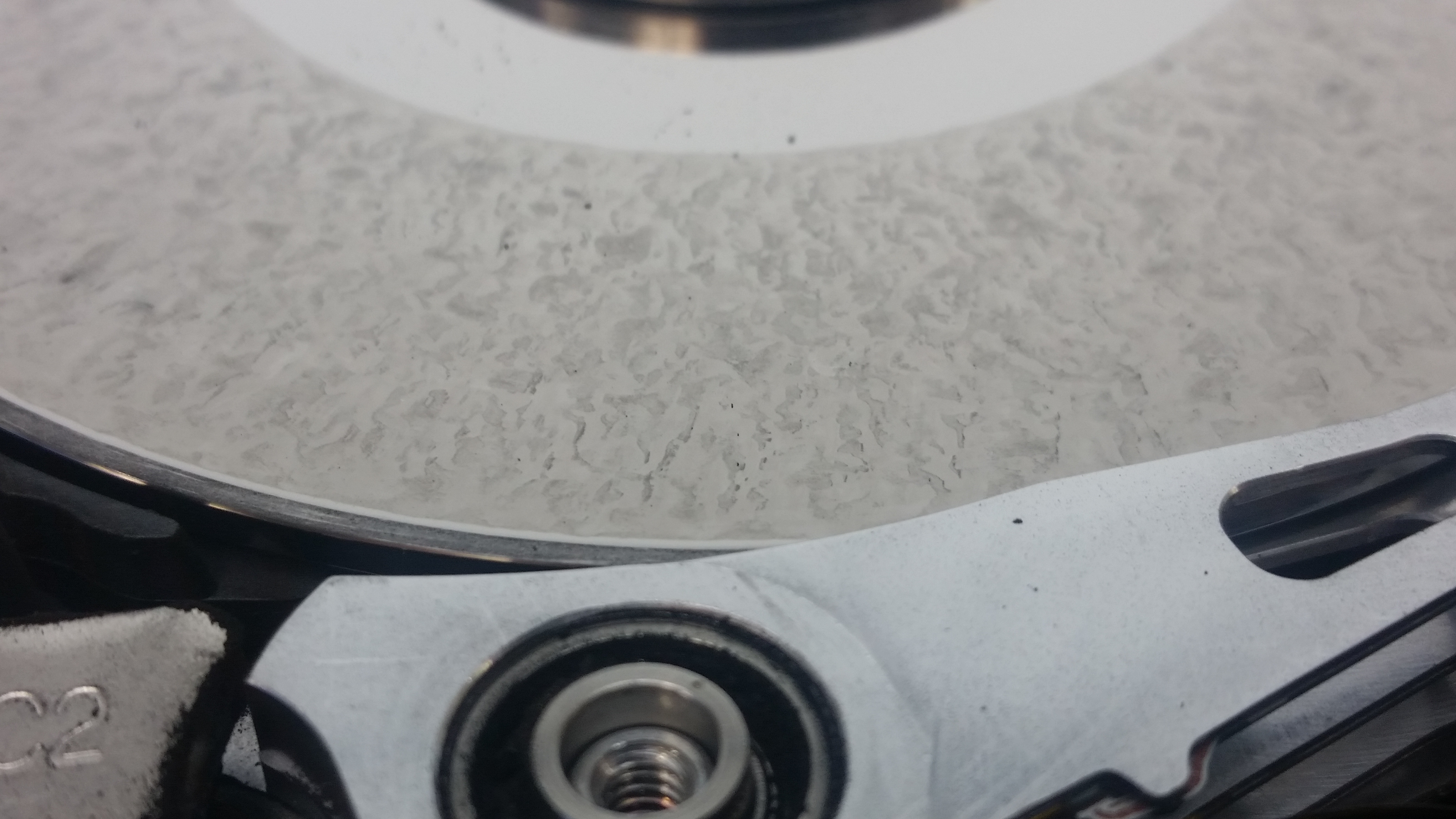

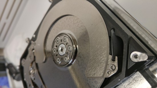

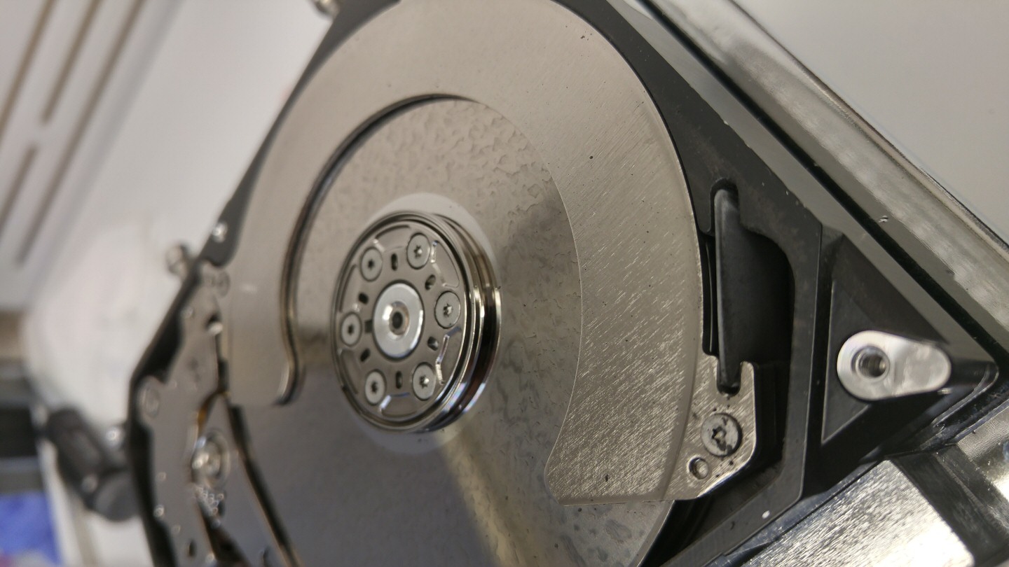

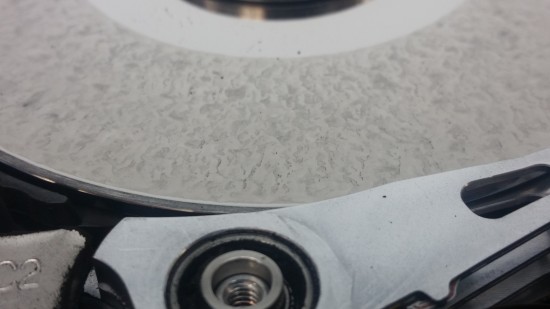

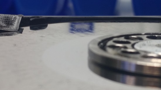

I have never seen a platter with this type of damage. Its almost like the failing heads were in some sort of rhythm.

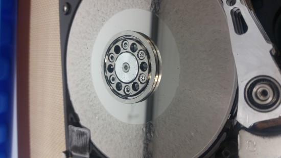

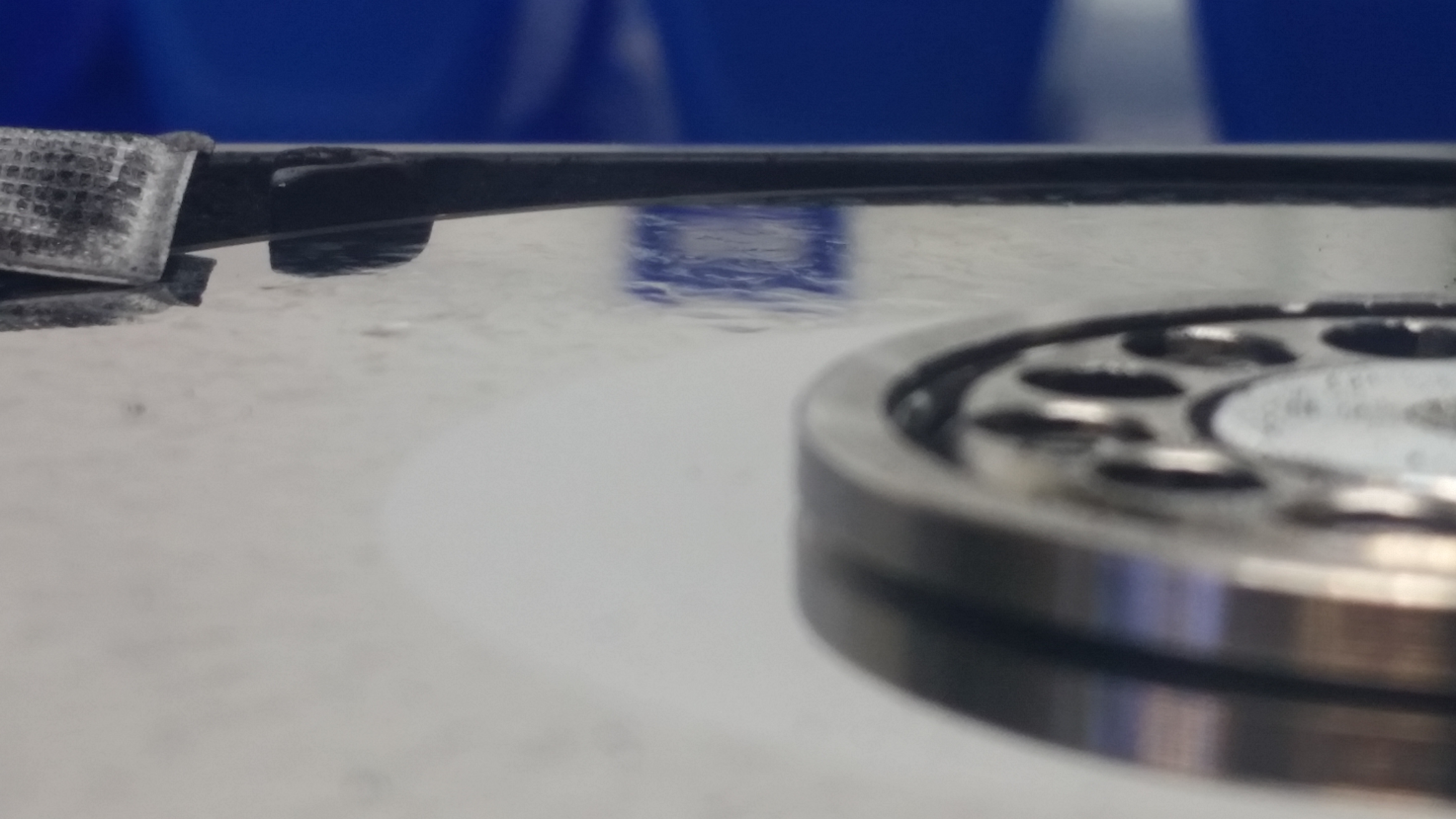

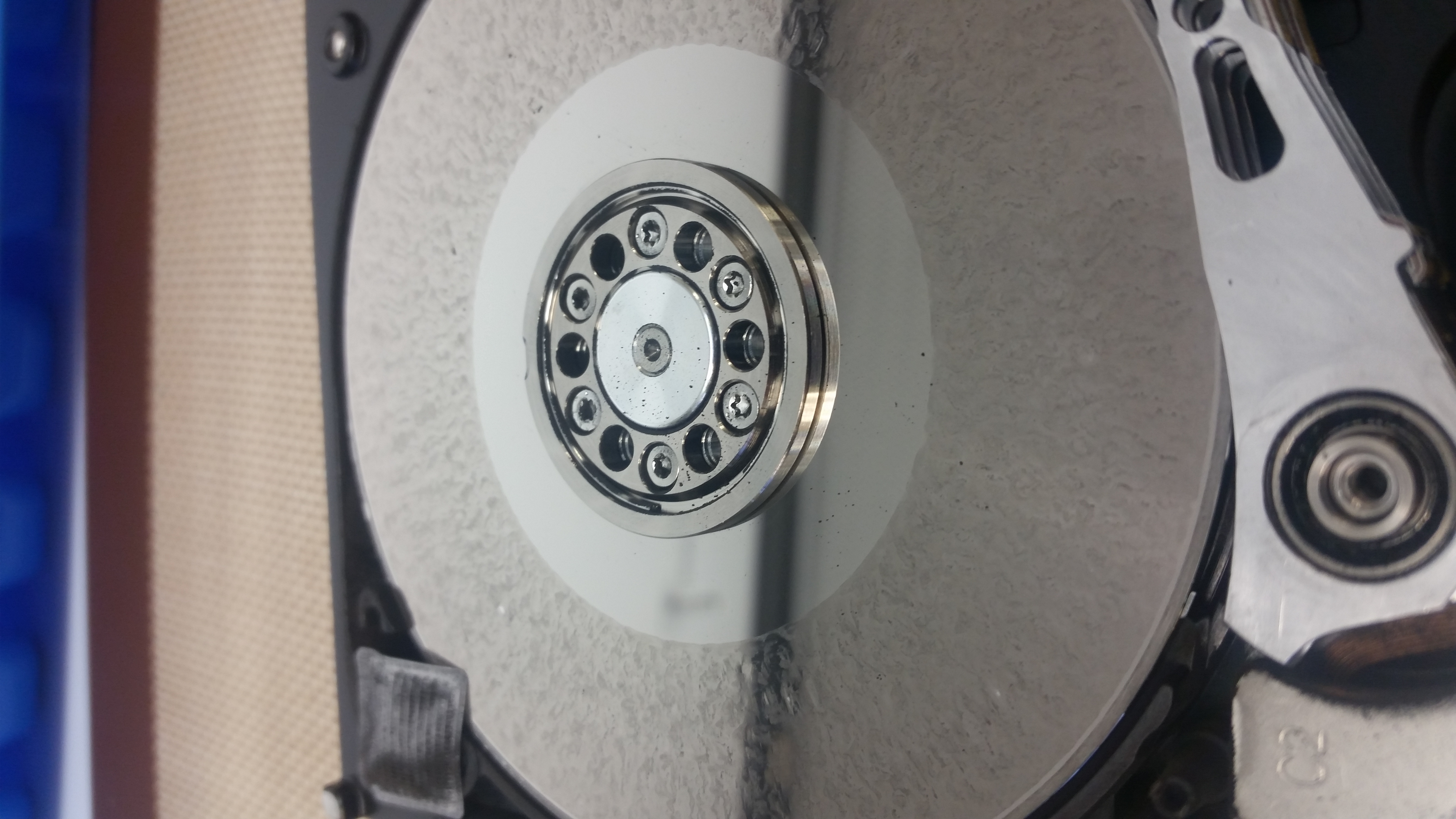

I had one of those a few months back. I hate making those phone calls :(

Is the damage just on the top platter or on all platters?

I've seen damage like this a couple times. Usually from a failed RAID member in a server that's never shut down. Obviously, it was running for quite some time after it failed.
+1
If the client doesn't want the drive back, I will let you know.
