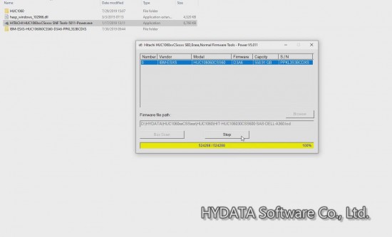

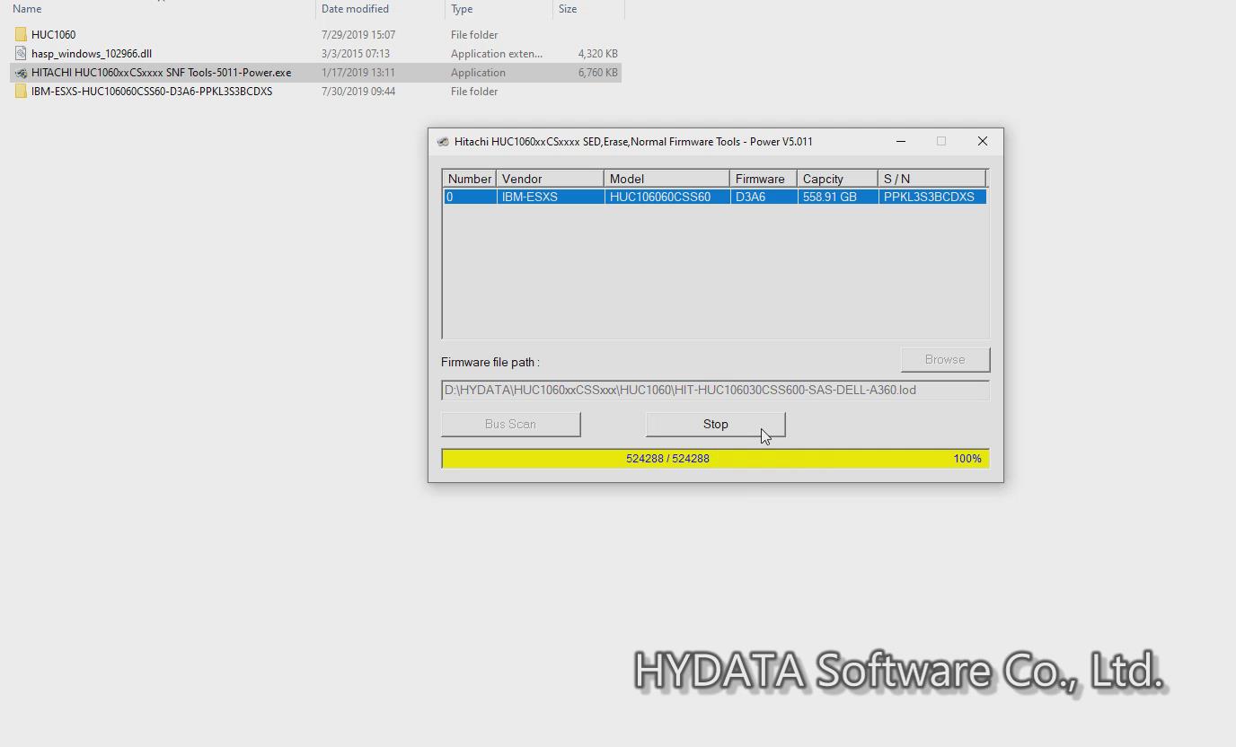

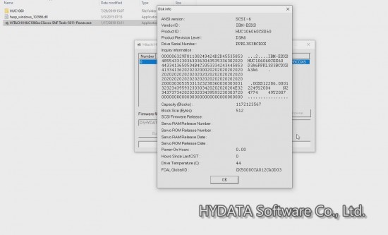

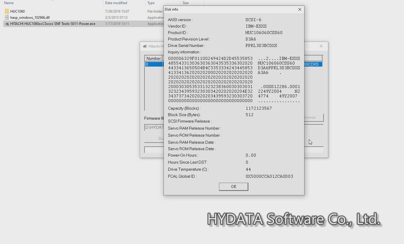

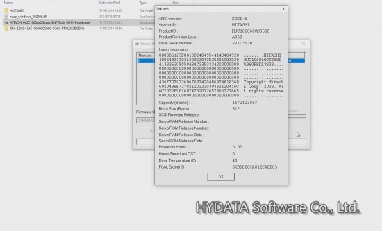

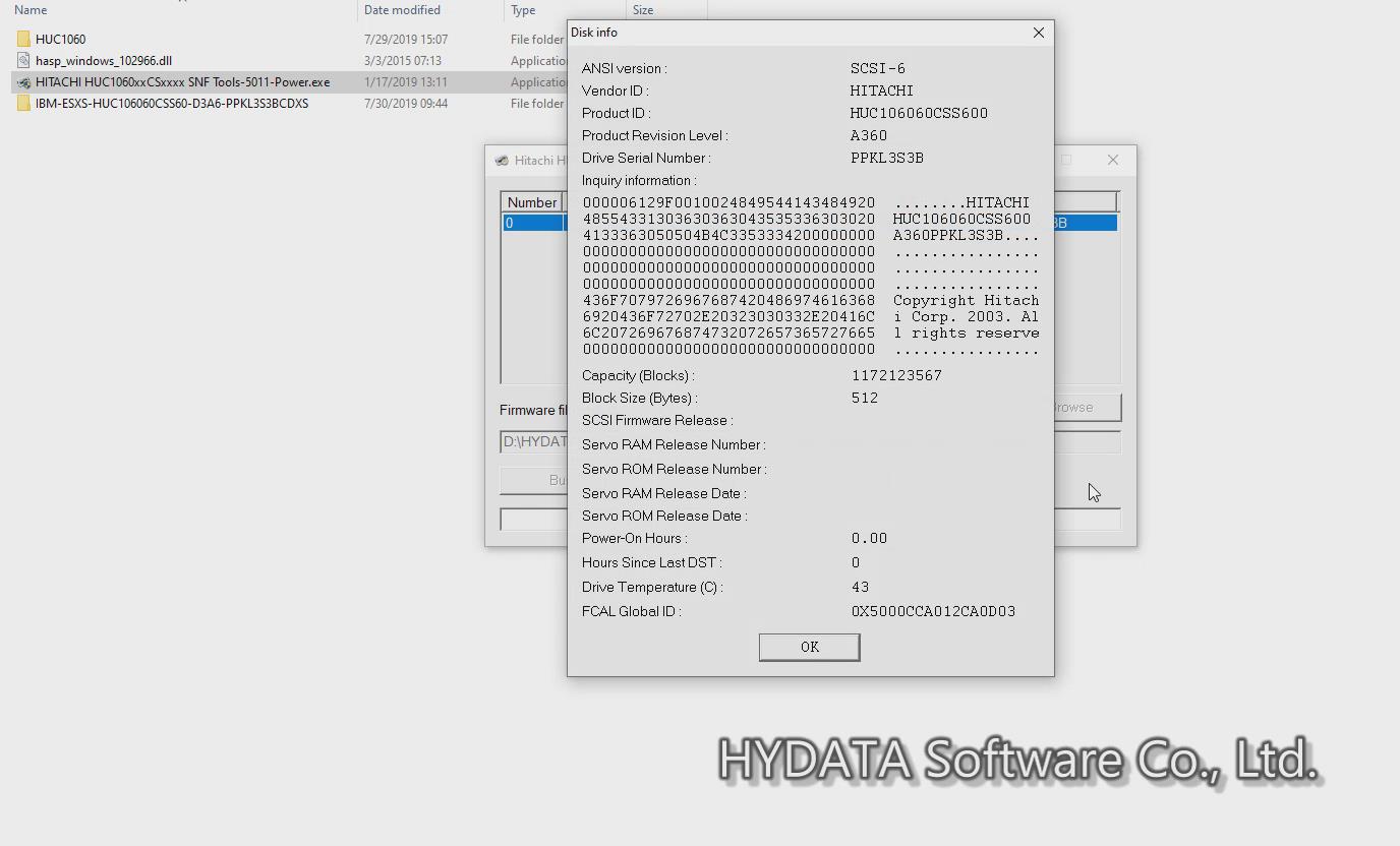

HYDATA gives the solution see the video
http://www.hydata.com\video\Hitachi\HUC1060xxCSSxxxSDF.mp4
File comment: Hitachi Superfirmware download tools
