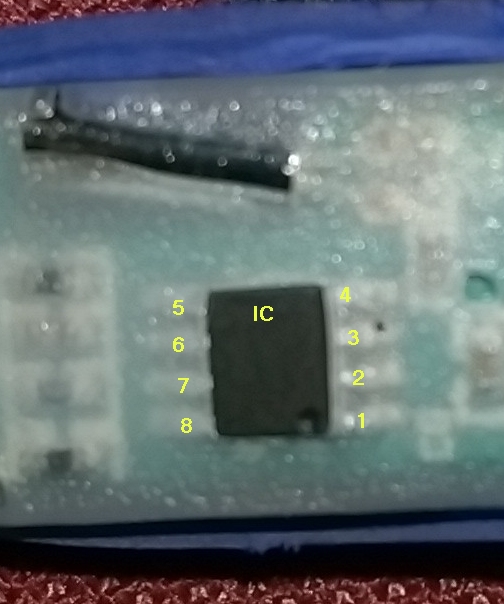

Do you still have the connector part ? With that you could trace the wires to match the correct colors and pinout. Or get a CP2102 / CP2104 adapter from the usual chinese sources.
 Post subject: Re: Old problem, Seagate 7200.11, connecting CA-42 cable
PostPosted: August 9th, 2017, 20:36
Posts: 17384

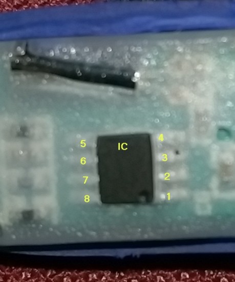

Can you scrape away the coating to reveal the markings on the IC?
Can you puncture the coating and make contact with each of the IC's 8 pins? Needle point probes would be ideal for this purpose. We could then use a multimeter to perform continuity checks with each of the wires.
To start. I'm a complete noob. I do have a multimeter at home though.
I was able to scrape away the coating with a knife, but I also scraped the IC a little bit (just the tiniest bit, it barely made a mark). Does it matter?
No, it's only packaging material.

In Windows, how is the cable recognized ? Which are the names of the drivers / hardware strings it is detected ? That chip *could* be a PL2303SA
http://prolificusa.com/files/DS_PL2303SA_d20120504.pdf
I suppose that's possible, but ISTM that the PCB layout would be much more logical if the chip were rotated 180 degrees. The way it is now, the USB pins (5 & 6) are on the "wrong" side (ie facing away from the USB connector), and the TxD/RxD pins (2 & 4) are facing away from the TTL cable.
