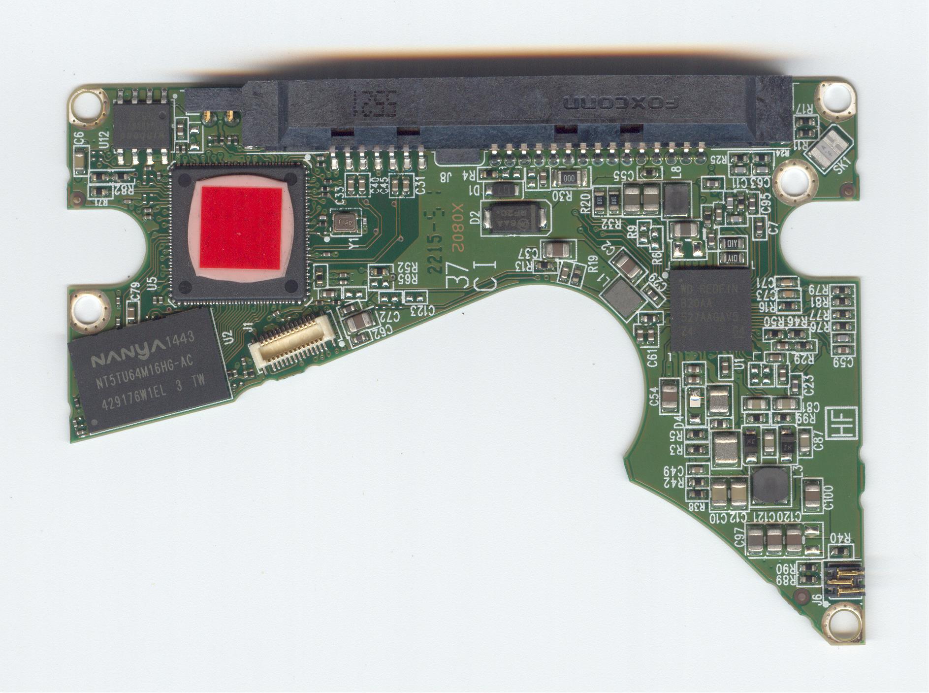

does your donor pcb has the same controller as the usb one?
Can you post pics (with ic marking readable)?
 Post subject: Re: Is there a compatible SATA PCB for 2060-800041-003? WD40
PostPosted: August 16th, 2017, 5:10
Joined: May 30th, 2005, 17:07
Posts: 550
The PCB model is the same as the Pebble (2060-800022-000 REV P2)
The only difference is the amount of RAM
Mikippp
PostPosted: August 16th, 2017, 5:13
Posts: 4846
Thx Miki,
I am interested in the OP's pcbs, especially the PN of the controller, which is not visible on your photo btw.

Drive Parts Information
Controller chip vendor.................. : 0x0000
Controller chip revision................ : 0x5450 88i1047F0
MicroP vendor........................... : 0x0000
MicroP revision......................... : 0x5450
Channel chip vendor..................... : 0x001A
Channel chip revision................... : 0x0020
Preamp vendor........................... : 0x0001
Preamp revision......................... : 0x0003
Power chip vendor....................... : 0x0000
Power chip revision..................... : 0x8320
Drive Build Information
Product ID (Ext)........................ : 0x16FE (0x025A)
Model................................... : WDC WD30NMVW-11C3NS2
