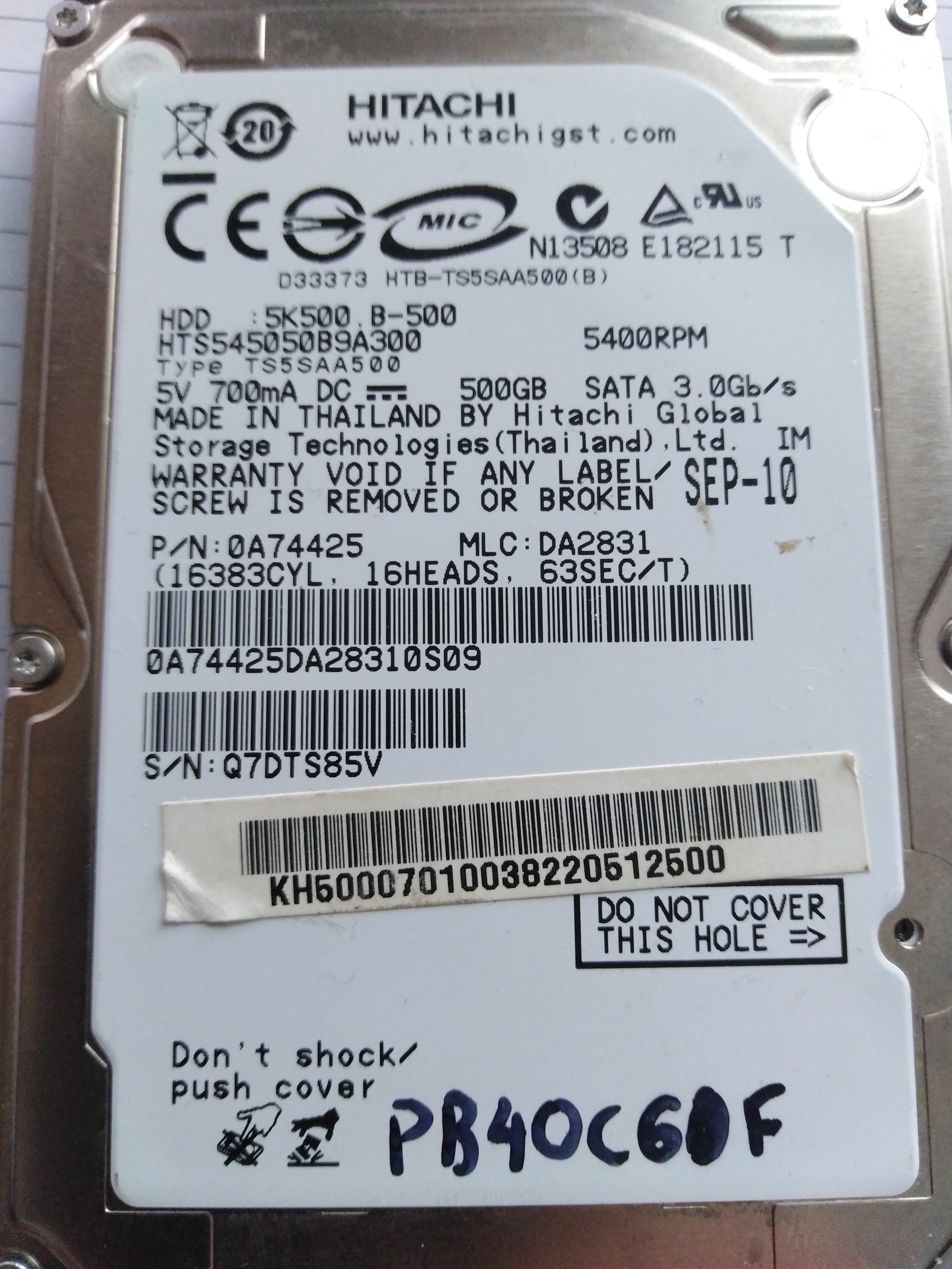

How to update firmware hard drive Hitachi hts545050B9A300 PB4OC60F, what utility and what to do please help.

I check hdd mhdd, victoria, hitachi and programs do not work at emergence of bad sectors in different places hdd hangs, works only after reset. On the other hdd hitachi understood, and in hts545050b9a300 PB4O60F can't decide how to replace the firmware.

You cannot just “replace firmware”.
Not a firmware problem, you are wasting your time.

Clone the drive with ddrescue or HDDSuperClone.

I thought about posting that kind of suggestion, but I was guessing (maybe incorrectly) from the tone of the OP’s message that they were looking to repair the drive rather than to recover data.

для восстановления диска файлы не требуются. Ошибка прошивки нужна PB6OC60F
no files are required to restore the disk. Firmware error need PB6OC60F.

If you try to repair a bad sector, the disk is not detected until you restart. and so in different areas of the disk.
При попытке восстановить поврежденный сектор диск не будет обнаружен до перезагрузки. и так в разных областях диска.
