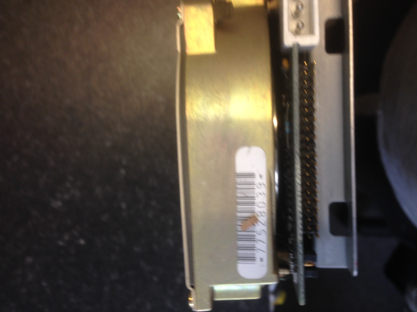

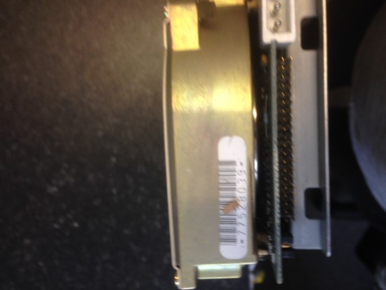

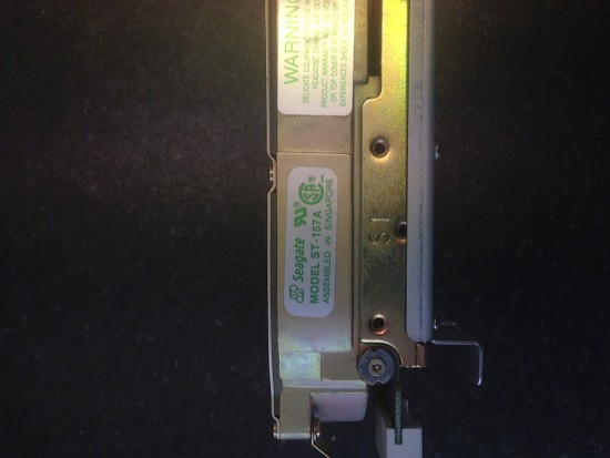

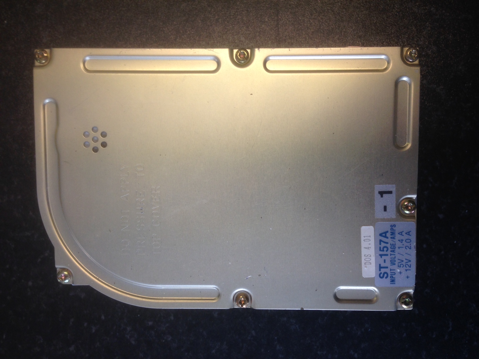

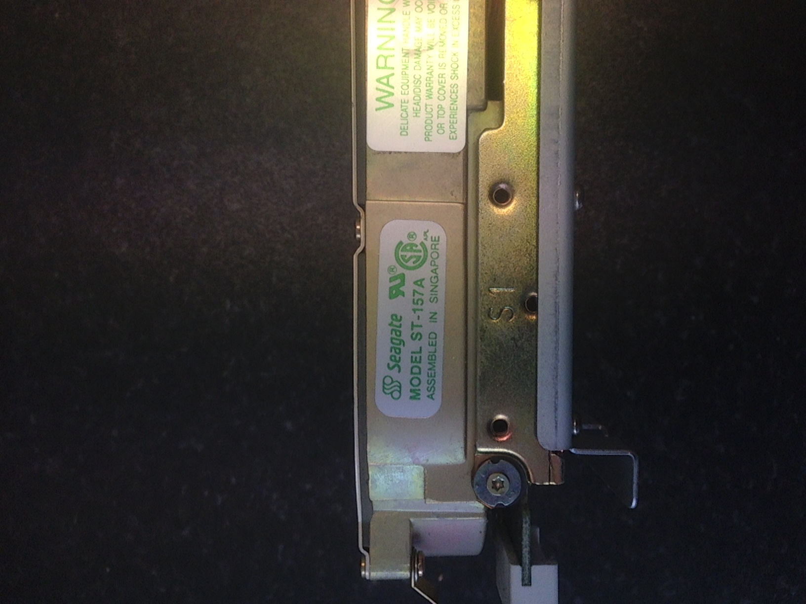

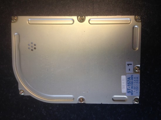

I have an old seagate drive that came into me. pc no longer starts up . When I say old - this fella is kinda 1st generation stuff
Drive Model is ST 157A (see attch images)
Condition of drive is ok . Have tried connecting via pc-3000 in PATA but to no avail..I'm assuming maybe its just too old?
Would be handy if I could recover or figure a way...Maybe set up an old 386 and slave it?

Need old PC-3000 ISA end old utility
http://www.acelab.ru/dep.pc/doc.pc3000d ... ST157A.pdf
оr crack ISA, DOS end old PC (IDE 5V)

Disclaimer: This drive is so old that the following could be wrong and not work, but the only way to know is to try. The computer BIOS does not have to properly recognize the drive, but it must at least recognize that the drive is attached.
If the drive is OK, then you should not need a really old PC, just one with IDE connector. On a computer that has IDE, boot a Linux live CD or USB with the drive attached, and you should have full access. It does not matter if the BIOS recognizes it properly, as you are not booting from it. The Linux OS should properly detect the drive and give access.

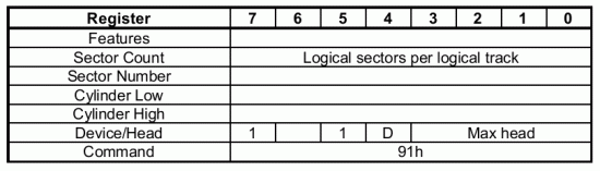

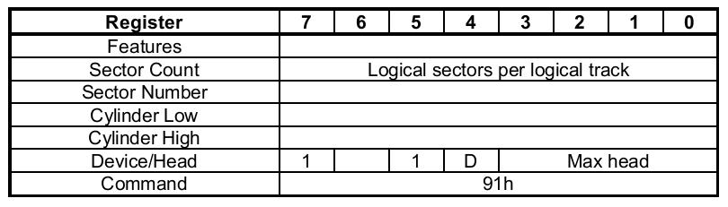

If Linux doesn't detect the drive correctly, I would examine the drive's current CHS translation mode (usually set by the BIOS to match the drive type selection) against the CHS parameters in the partition table or boot sector.
7.11 INITIALIZE DEVICE PARAMETERS
COMMAND CODE - 91h
TYPE - Mandatory.
PROTOCOL - Non-data.
INPUTS - The Sector Count register specifies the number of logical sectors per logical track, and the Device/Head register specifies the maximum head number.
NORMAL OUTPUTS - None required.
ERROR OUTPUTS - Aborted Command if the device does not support the requested CHS translation.
PREREQUISITES - None.
DESCRIPTION - This command enables the host to set the number of logical sectors per track and the number of logical heads minus 1 per logical cylinder for the current CHS translation mode.
Upon receipt of the command, the device sets the BSY bit, saves the parameters, clears the BSY bit, and generates an interrupt.
A device shall support the CHS translation described in words 1, 3, and 6 of the IDENTIFY DEVICE information. Support of other CHS translations is optional.
If the requested CHS translation is not supported, the device shall set the Error bit in the Status register and set the Aborted Command bit in the Error register before clearing the BSY bit in the Status register.
If the requested CHS translation is not supported, the device shall fail all media access commands with an ID Not Found error until a valid CHS translation is established.

your correct on age of computer maximus - I currently have it hooked up as a slave on an old pentium 4 and can access it and all data on it...
however that said is the easy bit :) this must be a very old dos drive or have a dos based system on it as the file structure isn't the normal documents and settings like windows normally has - currently copying the data from the drive at a very painfully slow 150/200 bytes per second ...
we'll have a look at the structure then and see if maybe an emulator may help .. we'll see what we can get back anyway - I'm suspecting anything will be txt based or very early MSWORKS files - any files like that should open in an early copy of works say a windows 95/98 version
Will keep this updated for future reference as to solutions for folk :)
