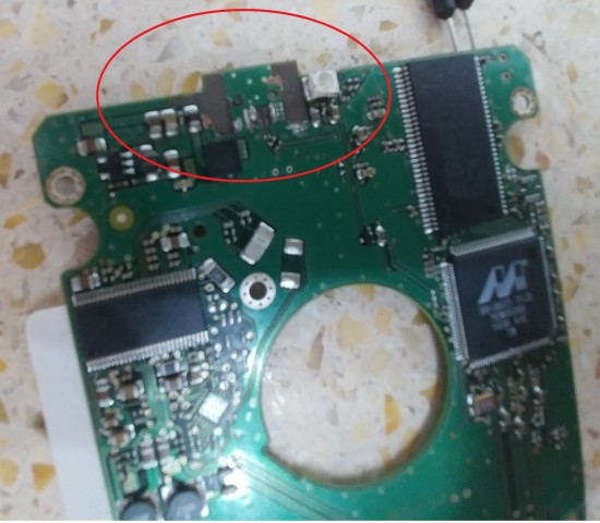

I have a Samsung USB drive HM502JX (PCB REF: BF41-00282A) with a broken USB connector.

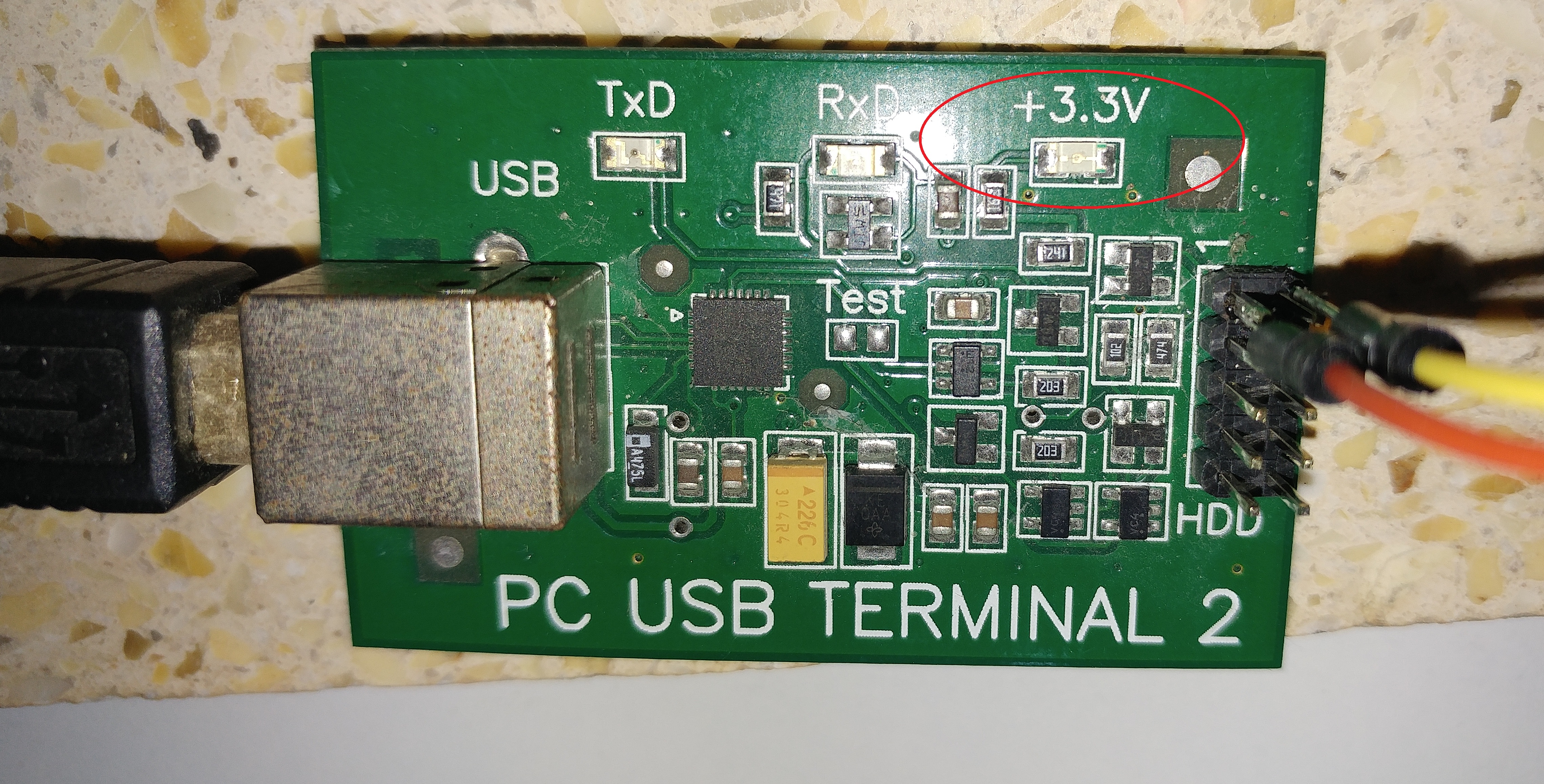

When I try to read ROM via Terminal in PC3000 in order to use it in a donor PCB, I can't (maybe because PCB is not powered Is it not possible to solder a USB connector as the PCB is damaged in that region).
Is there another way to read ROM?
Is there another way to recover data in this case?
Kind regards,

 Post subject: Re: Samsung USB drive HM502JX with Broken USB connector
PostPosted: August 27th, 2017, 12:20
Joined: September 7th, 2012, 16:37
Posts: 197
That's what I thought but how? as USB connector is broken (see the photo above) and I couldn't solder a USB connector.

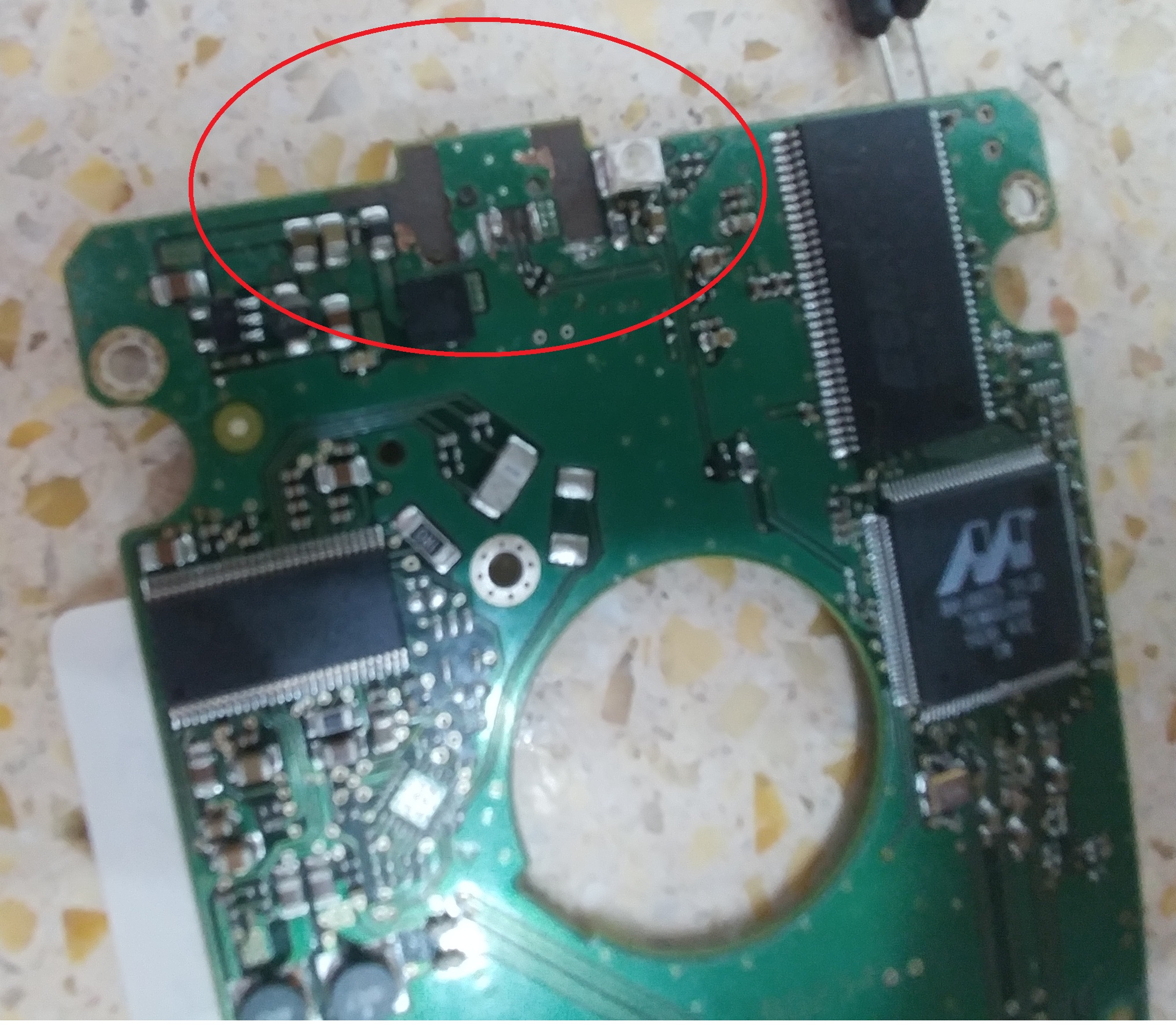

PostPosted: August 27th, 2017, 12:47
Posts: 197

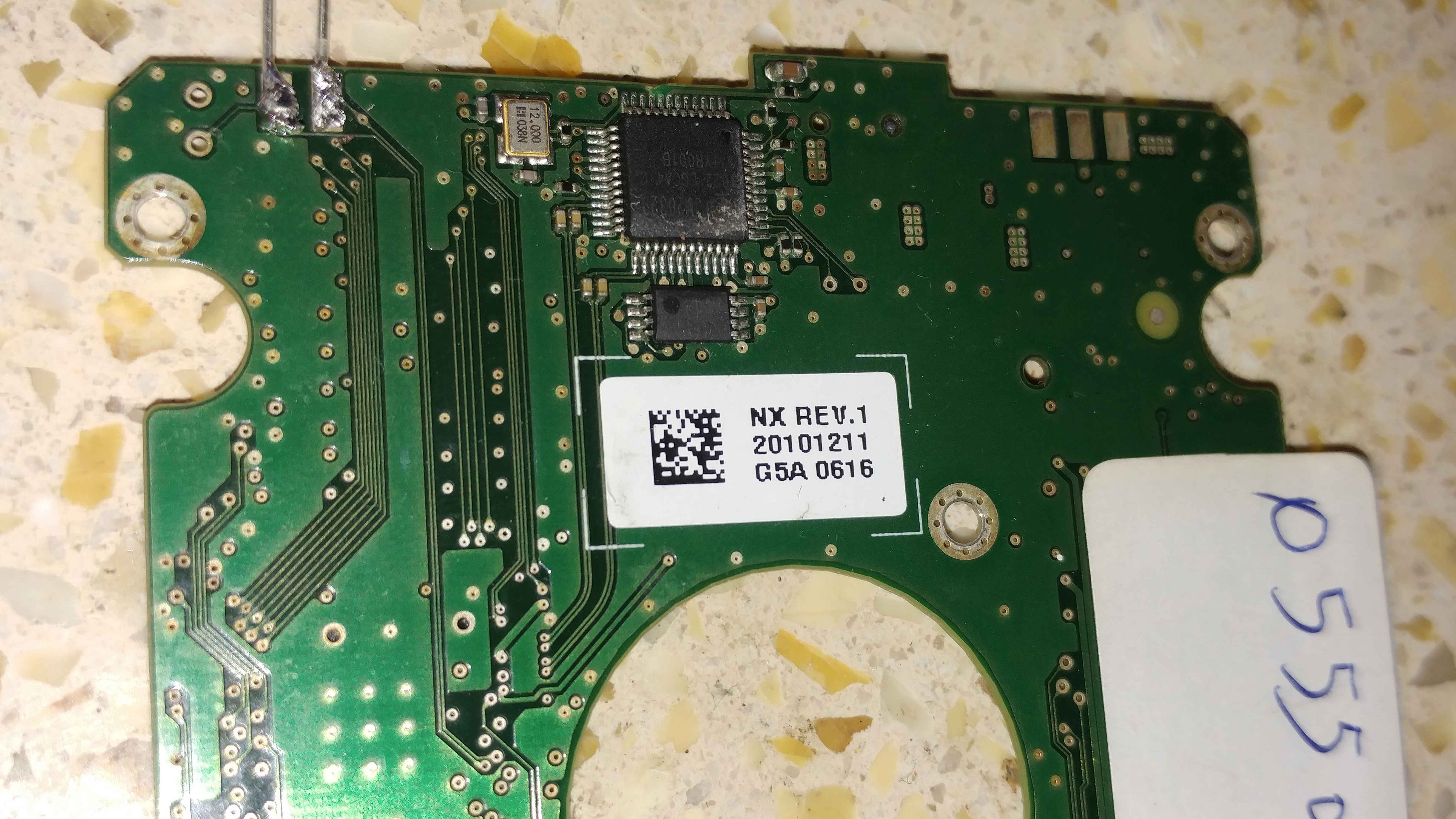

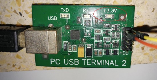

Could you please show me where to connect it? I can see only 3.3V on "PCB USB Terminal 2" (see attached photo)

No, not on terminal adapter....take a sata power cable and cut plastic then solder 5v + ground to the pcb.

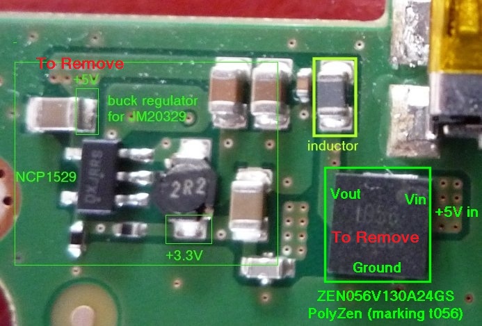

PostPosted: August 27th, 2017, 15:40
Posts: 17218

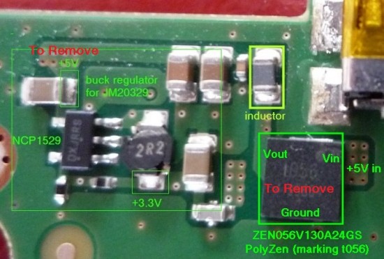

PCB protection devices - PolyZen:
http://www.hddoracle.com/viewtopic.php?f=100&t=1615&p=8870
http://www.hddoracle.com/download/file.php?id=3093&mode=view
PostPosted: August 27th, 2017, 19:13
Posts: 3970
If you can provide a better clear photo of the USB connector are, we should be able to mark where to solder. You also might even be able to solder wires to link another USB connecter to the board and recover data. In the grainy unclear picture, it doesn't look *that* bad.. I also advise soldering under a stereo microscope at at least 5 - 10x.
PostPosted: August 27th, 2017, 19:27
Posts: 17218
My URLs have all the information that the OP requires, including an annotated photo clip.

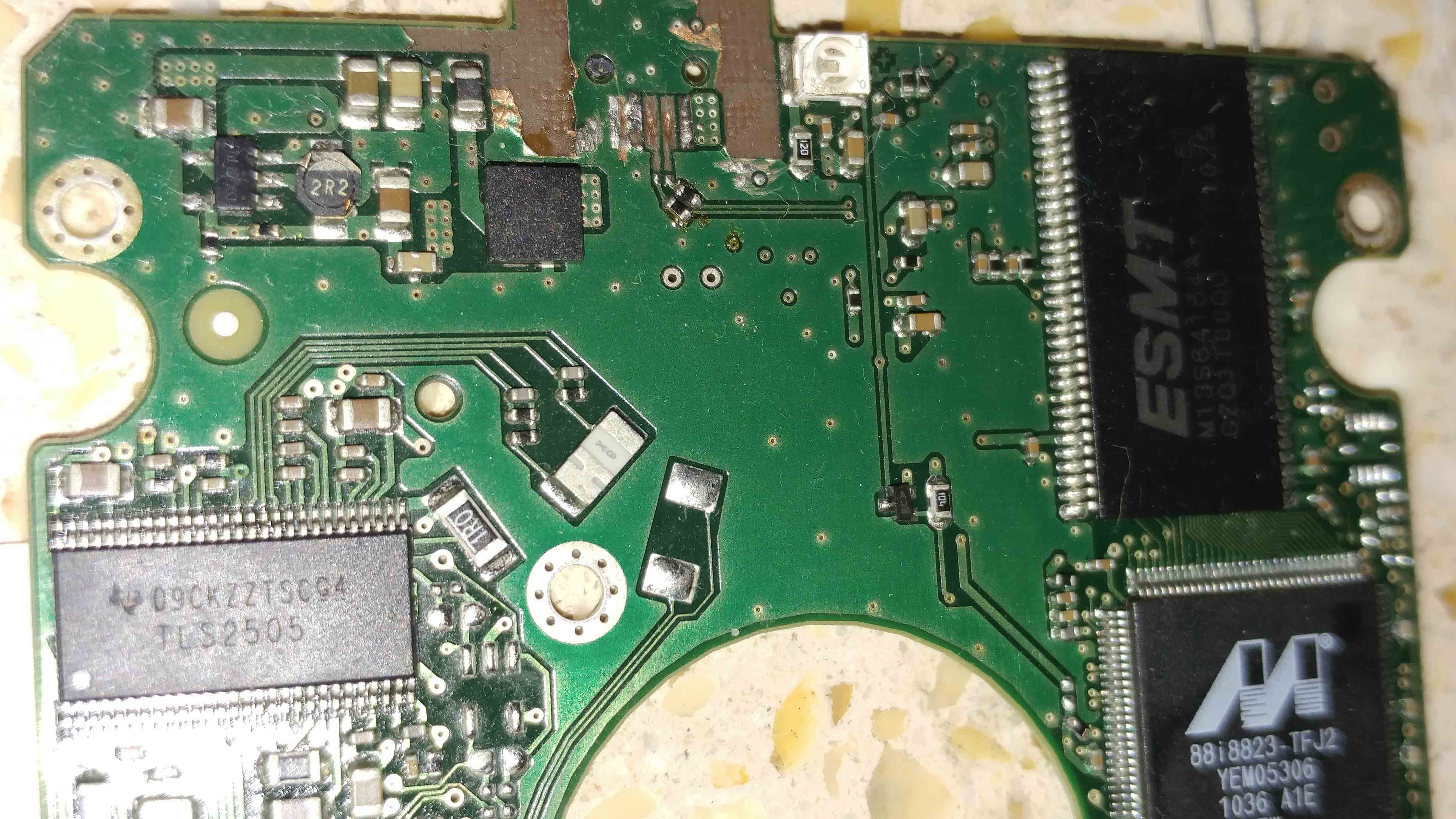

Should I remove the Buck regulator and the PolyZen chips to solder the SATA power?

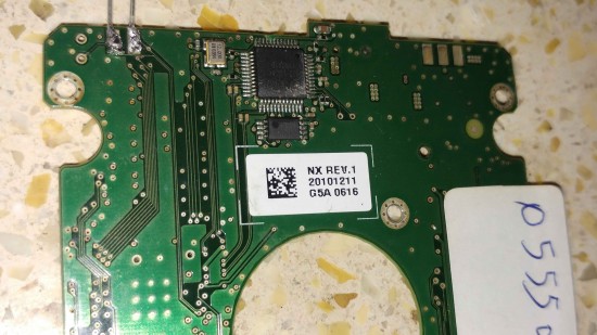

Attached the 2 photo of PCB.
PostPosted: August 28th, 2017, 12:43
Posts: 285
No
connect +5v to the pad at vin of PolyZen, and use ground at any screw hole pad.
As HaQue suggested, use a microscope and with good soldering skills you can get USB connections also done, and get the data back
