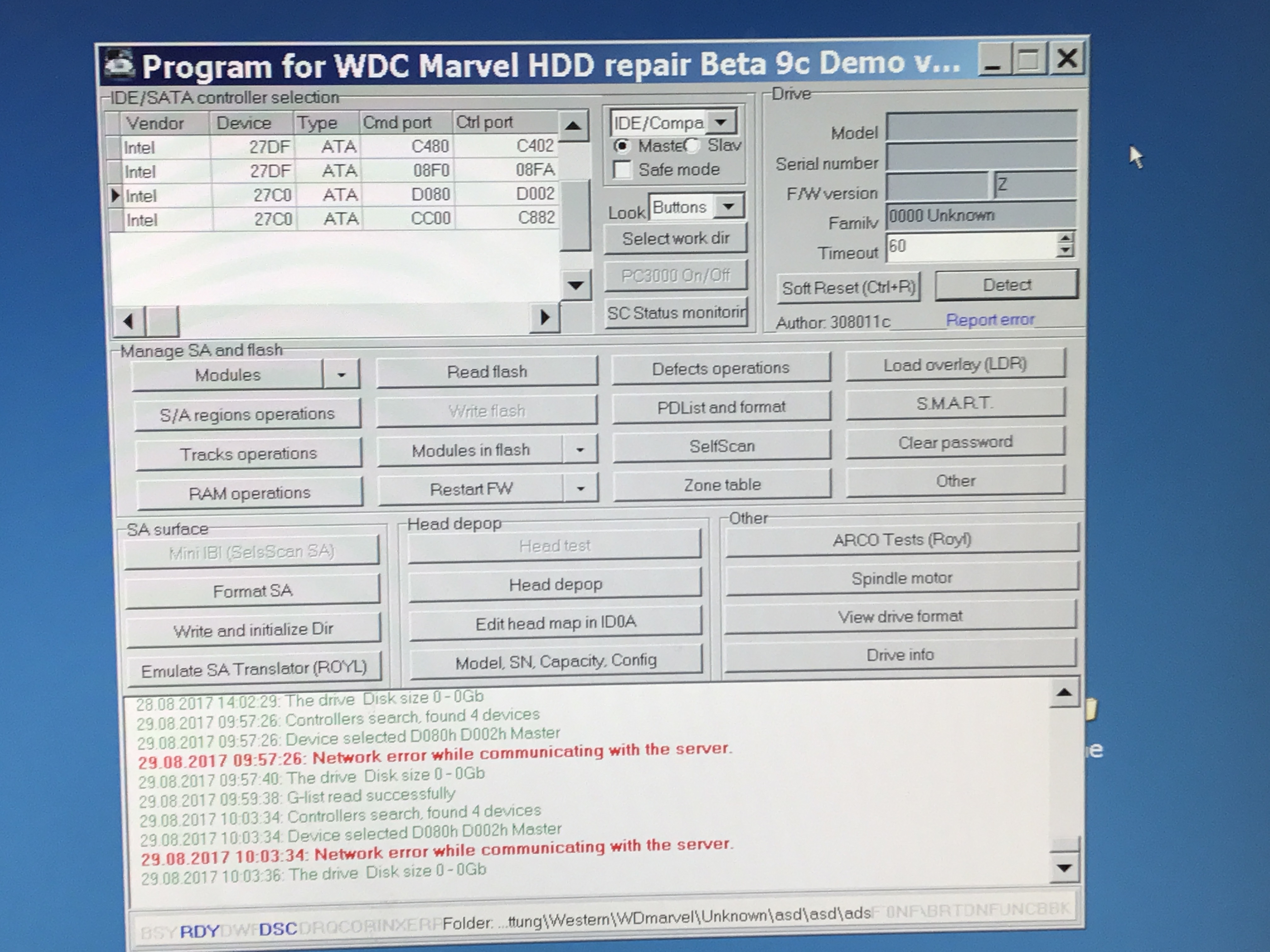

HI there,
I have a Western Digital WD500BEVT.
The drive is sometimes recogniced by the system in the Devicemanager. If i connect it to the S-ATA Port, the HDD LED will blink permanent.
In WD Marvel i cant ID the Disk correctly. (see pic).
Is it a Slow issue or will PCB exchange solve the problem, so that I can rescue the data on it?
U12 Chip is available on both boards.
best regards
Fabian

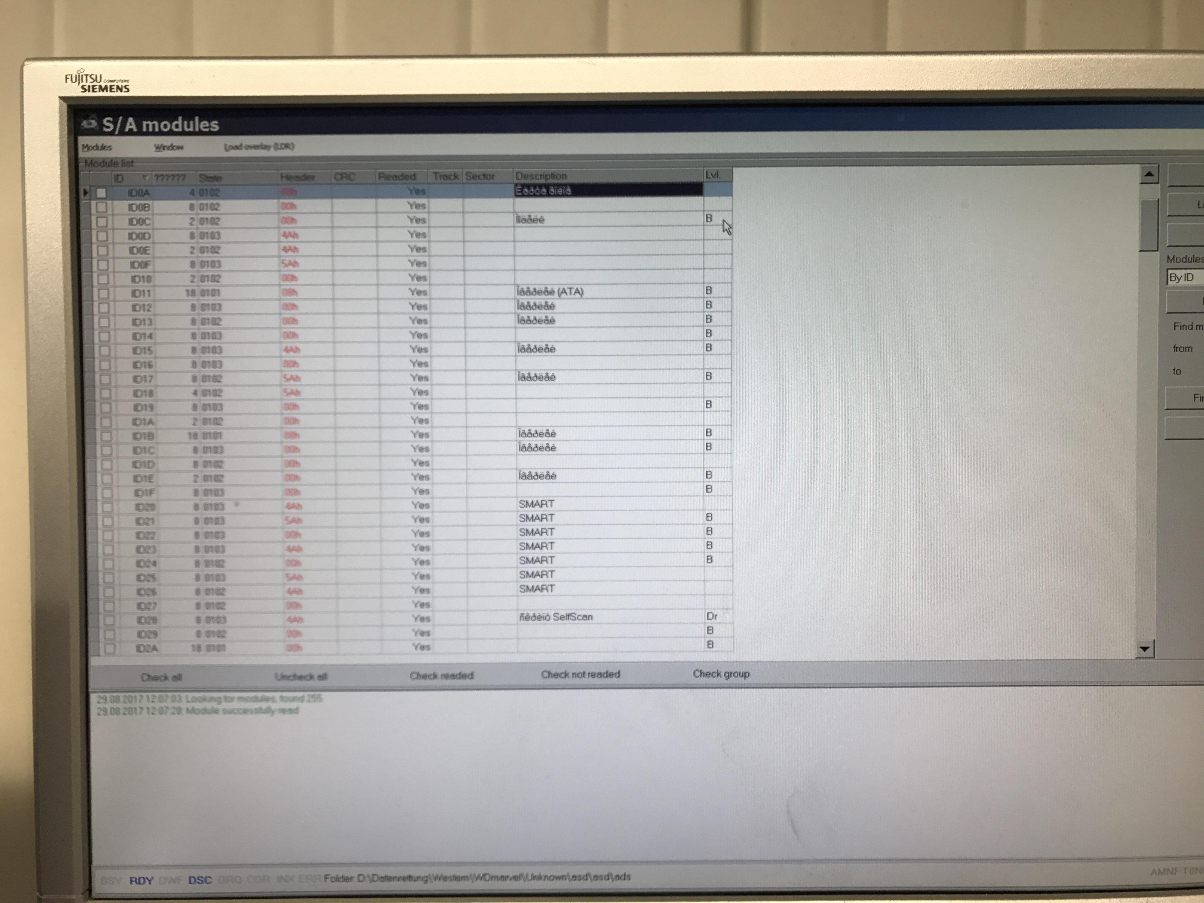

This one?
 Post subject: Re: WD500BEVT 0-0GB
PostPosted: August 29th, 2017, 7:35
Posts: 1748
Location: Verona, Italy
yes, can you backup those?
