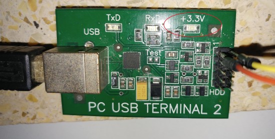

Could you please show me where to connect it? I can see only 3.3V on "PCB USB Terminal 2" (see attached photo)

No, not on terminal adapter....take a sata power cable and cut plastic then solder 5v + ground to the pcb.
