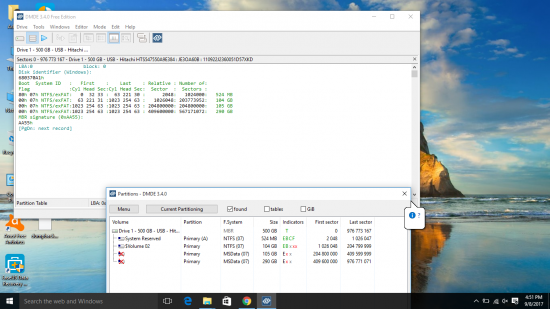

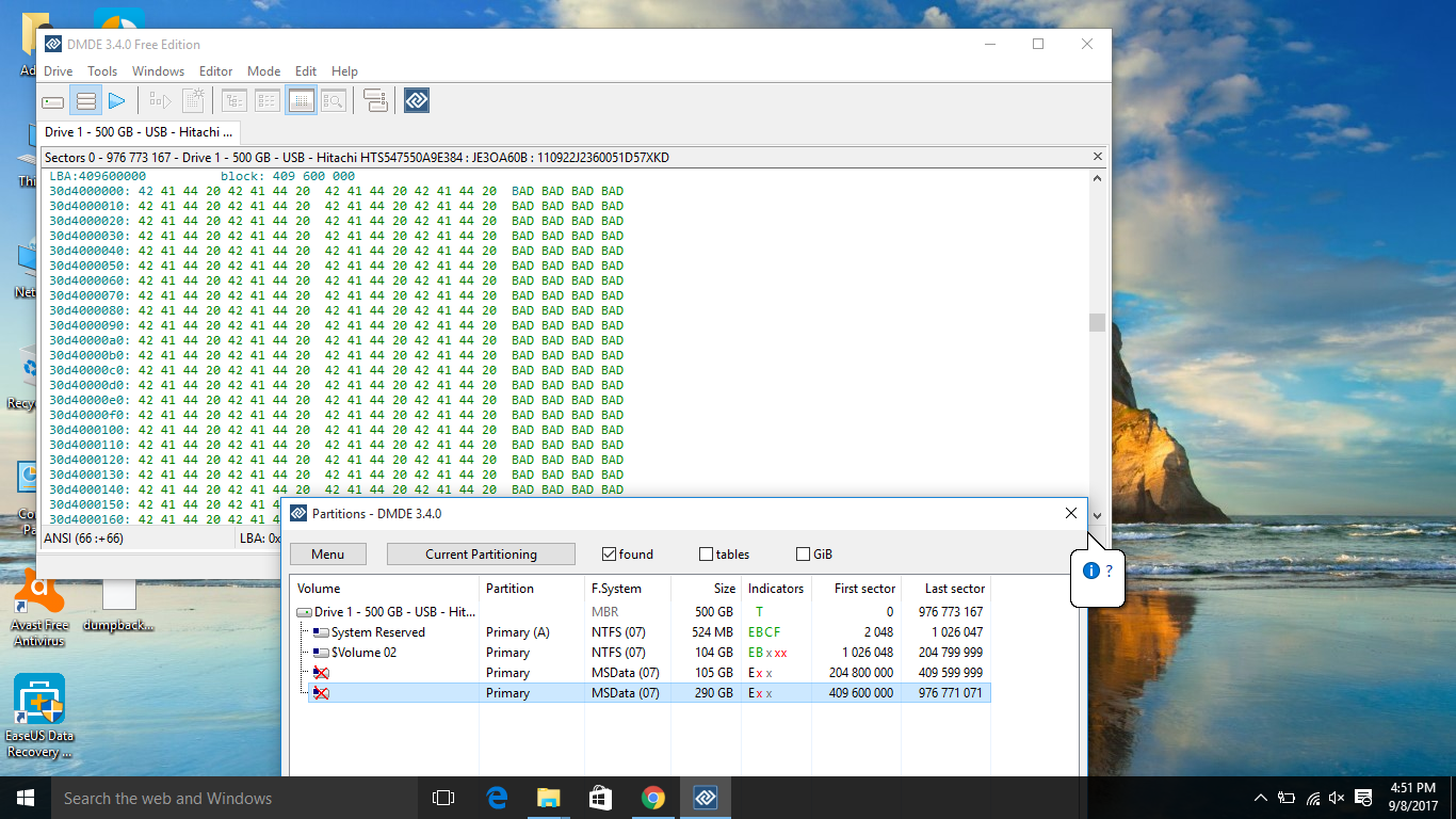

Can you show us the Partitions window in DMDE?

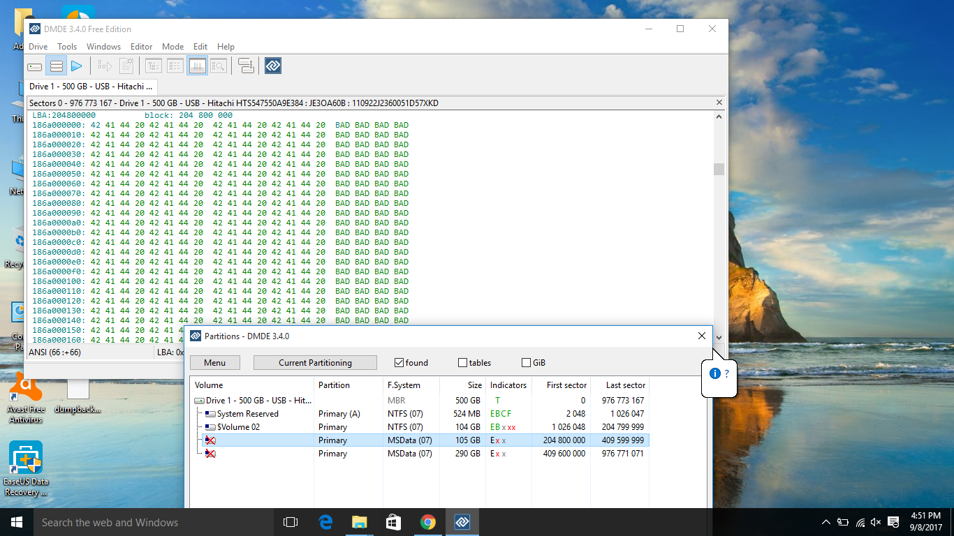

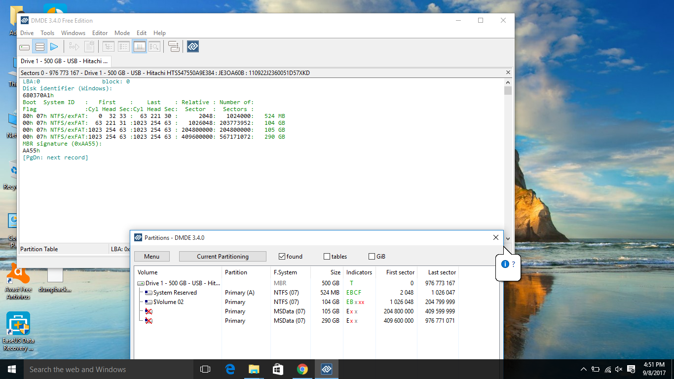

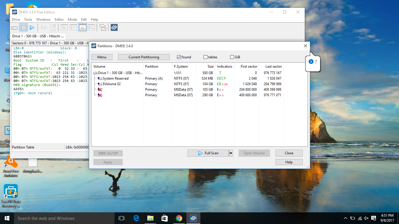

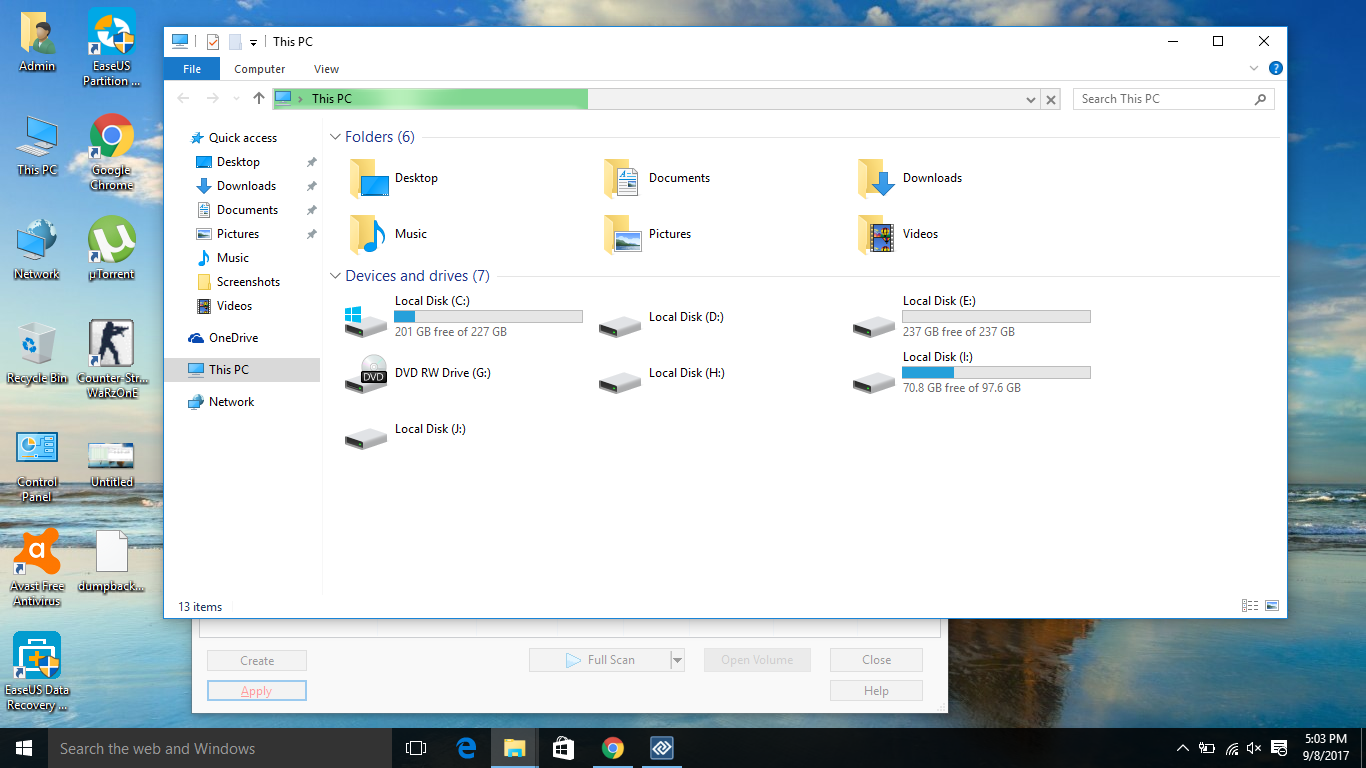

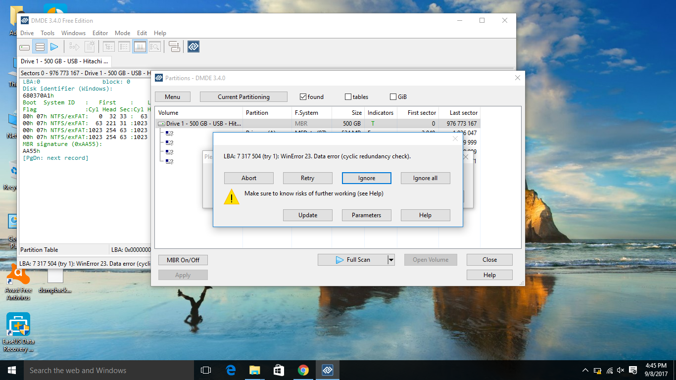

check this screenshot. I am planning to format then recover the data using easeus but i am unable to even format it. This hdd sometime disconnected automatically and sometime it even effect the current laptop for eg the desktop gets disappeared(full blackout)

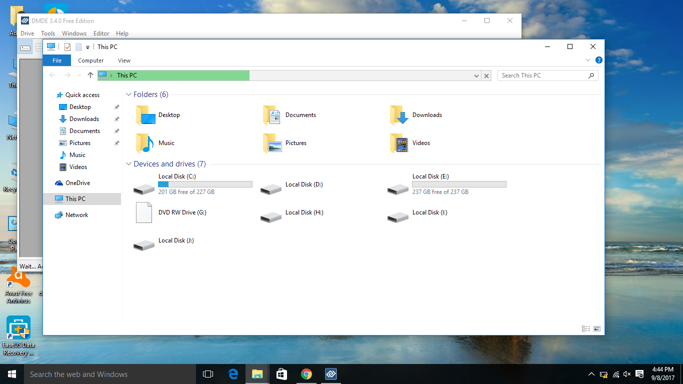

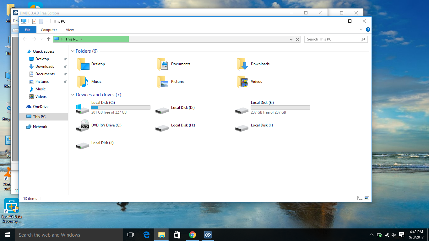

drive C and E belongs to current laptop.
not a good plan.
drive not stable, so if data is important take pro help.
Else clone the drive and play(use recovery software) with the clone

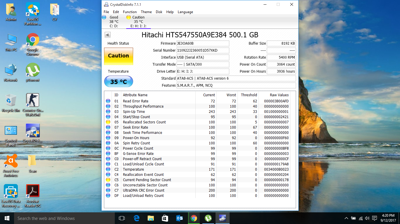

@Akkidonz, your drive has physical problems. Can you show us the SMART report with CrystalDiskInfo?

If possible, as soon as possible, do a one-time, one-only-pass (of each sector), sector by sector clone of the problem HD onto an external HD of equal or greater size. If HD has an imminent physical failure, spin-time is questionable as to how long without major error, and total failure time is unknown.

Check this.

Attributes 01, 05, C4 and C5 all point to physical problems.

As sathyan has already said, the only DIY option would be to attempt to clone the drive, sector by sector, with a tool such as ddrescue or HDDSuperClone, and then run data recovery software against the clone..
