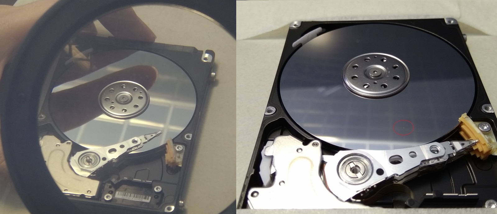

The head was indeed stuck at the disk surface after the top cover was opened. I'm using the anti-clockwise with a slight knock at the end of the head stack assembly slowly return the head to the ramp. Noticed a small white dent at the disk surface.

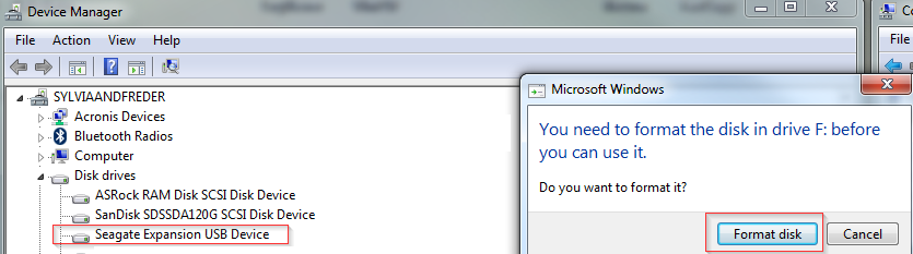

Drive was able to get ready. A "format disk" message shown up after power up the drive. Windows chkdsk was able to fixed the "format disk" error messages.

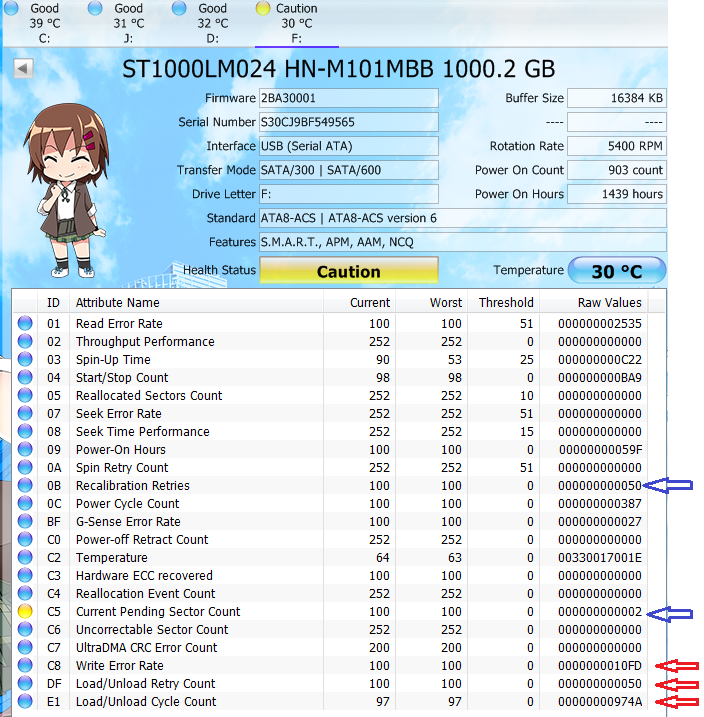

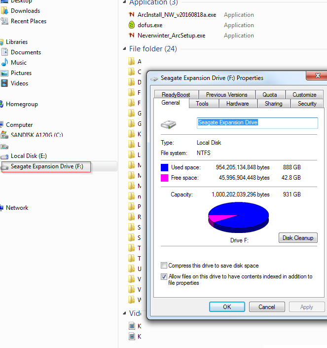

Owner data was intact with about 880GB. The internal drive was a Samsung M8BP2 series. Noticed the load/unload cycle count increased significantly.

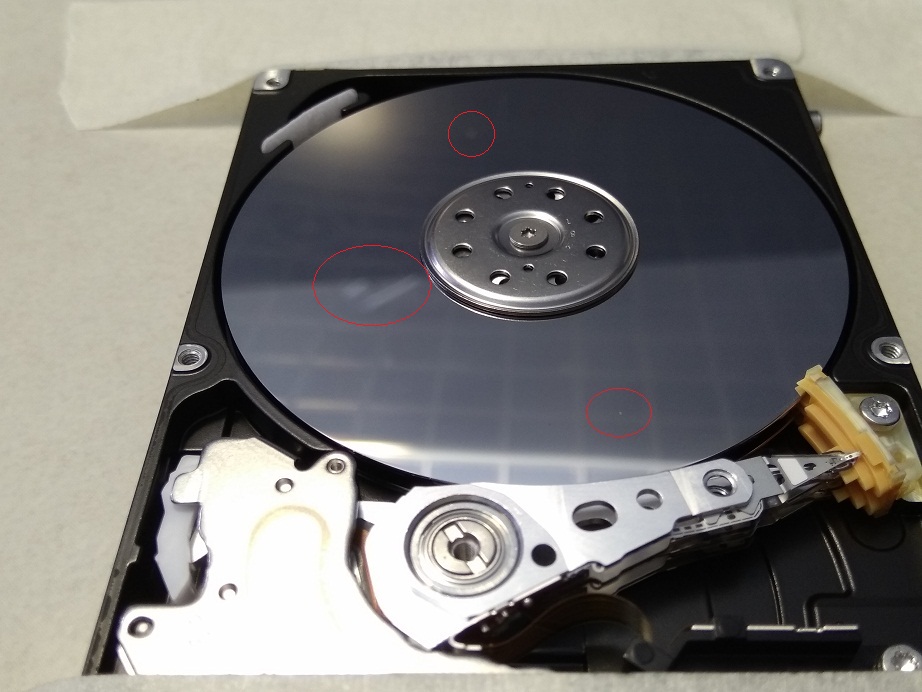

- I can see dust particles on your 2nd picture. If a laminar flow workbench was used then it's not properly filtering air particles or it's not HEPA100 (at least) as dust is clear visible on your picture.

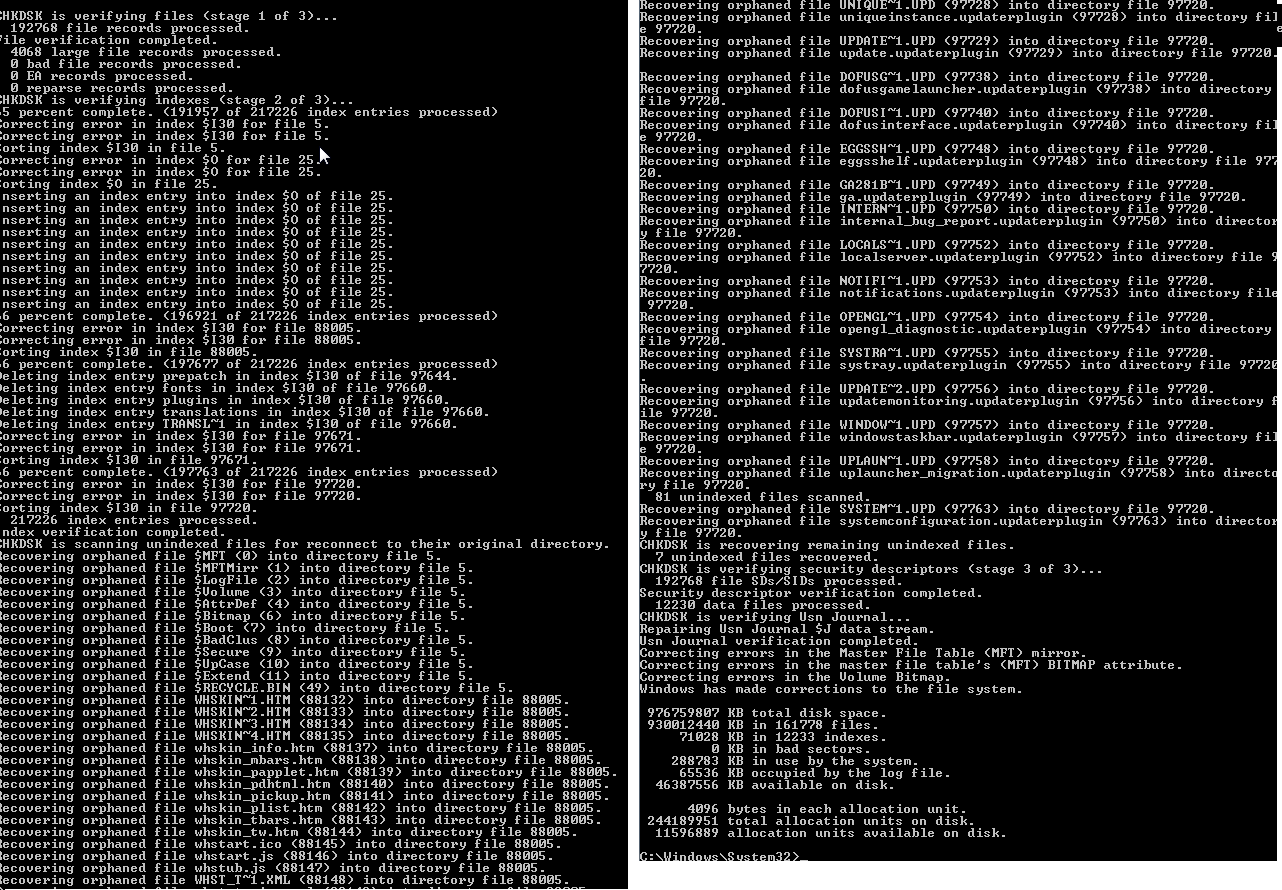

- You stated that you get a format message that you fixed with checkdisk. How did you migrate the data if all that you were getting was a format message ? :shock: :shock: :shock:
Hello Spildit,
- I'm handling with glove and I believe those are not sticking dust/particle (highlighted in red), while the earlier white spot mark was caused by the head disc interaction. I will pay extra precaution and practice more x-swap exercises.
-Sorry that I didn't make it clear earlier, as soon as the drive was detected (but un-mountable in windows explorer) I'm using EaseUS to retrieve and migrated the data into my portable drive (not the best option!). The checkdisk command was the last option that I'm trying check if the drive was able to fix and mount to the explorer. Understand that checkdisk will reallocates some bad sectors and make it as unreadable (from my earlier Samsung HM321HX case). So after the data migration then I performing check disk to check if the drive was mountable in windows explorer.
So the picture with the bare hands in the picture was taken after the recovery?
