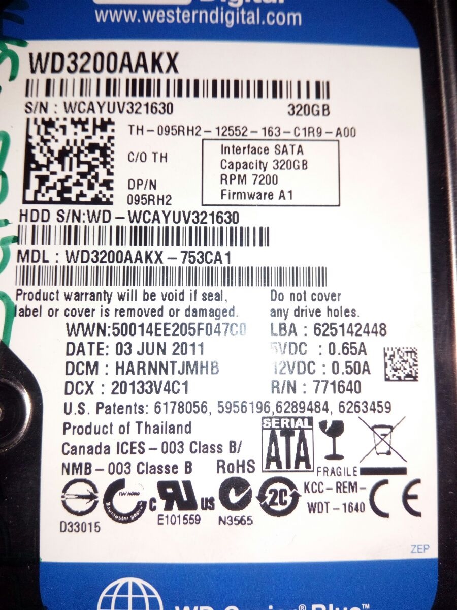

I am find donor HDD for HEAD swap process.!
i found one,,,,
WD3200AAKX-083CA1 SN WCA** DCM : **TJ* DATE : 2011
Part number different with damage one " 083CA1 "
this donor compatible or not with damage HDD ?

Should be, but it's good to also check microjogs
