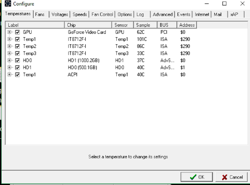

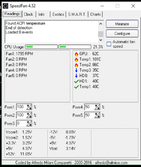

The free program SpeedFan shows the following figures:
GPU: 65C
Temp1: 101C
Temp2: 86C
Temp3: 35C
HD0: 38C
HD1: 40C
Temp1: 40C
In the program window, there are fire signs beside GPU, Temp1, and Temp2. I do not know what components are referred to as Temp1, Temp2, and Temp3. 101C (213F) and 86C (186F) are very high temperatures.
Another window in the same program has the value of 105 beside the WDC drive, and 41 beside the SeaGate drive. Two drives are inside the system block.

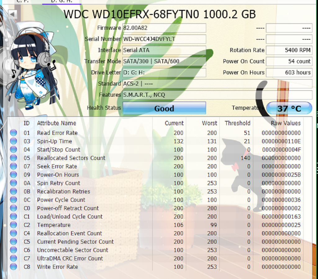

The CrystalDiskInfo program, shows the value 41 at the top and in the table below as the temperature of the SeaGate drive, whereas it shows 38 at the top and 105 in the table below as the temperature of the WDC drive. The programs says that both drives are in a good state.
Do you know why both SpeedFan and CrystalDiskInfo show the temperature of the WDC drive to be 105, while CrystalDiskInfo also has another value of 38 in the below table as the temperature of the same drive? Is 105 a temperature value for an internal part of the drive which is much hotter than the external part?

@Vlad, please show us the CrystalDiskInfo SMART report.
SpeedFan is displaying the temperatures reported by the motherboard's hardware monitor IC. It has no way of knowing which temperature sensor is connected to a particular input of this IC. Instead you could observe the same information in BIOS or using the motherboard manufacturer's own tool.

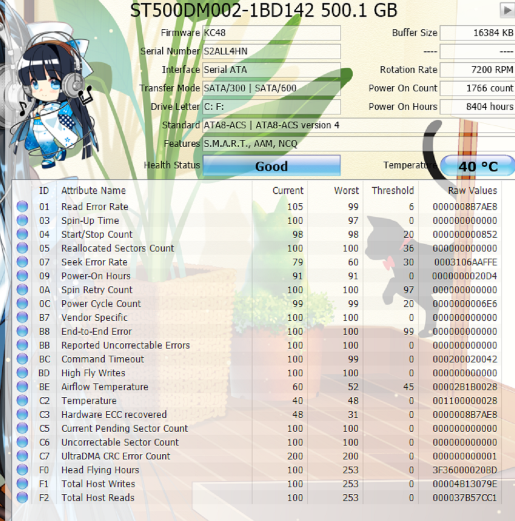

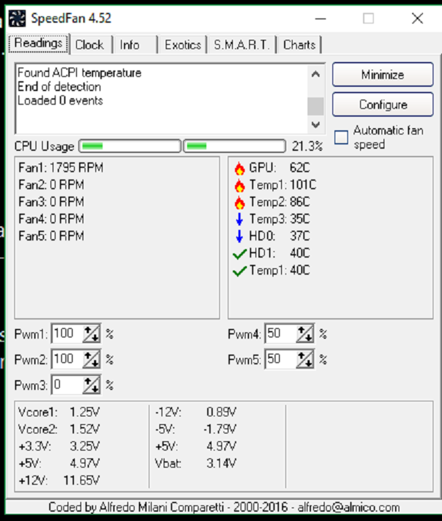

The two files attached below contain the reports for the two hard drives in the system block. The report for the WDC drive shows 37 degrees at the top but 106 in the table below.
The other two files contain the reports from SpeedFan.

The Seagate SMART report shows a few Command Timeouts (0x42 = 66) but is otherwise clean. These timeouts could reflect the observed "bleeps". I would backup your data on a regular basis in any case.
The TEMPs are probably case and CPU temperatures, but you will need to go into BIOS setup to confirm this.

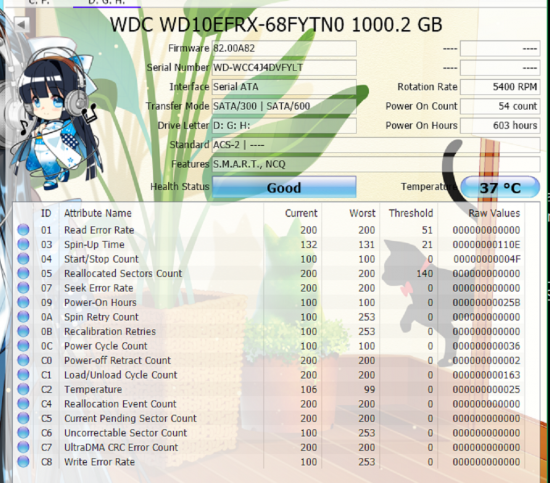

Do you know why the SMART report for the WDC drive shows its temperature to be 106?

The Current and Worst numbers are normalised values. The raw data are the actual temperatures.
For the WD HDD (attribute C2) ...
    temperature = 0x25 (hex) = 37C (decimal)
http://www.google.com/search?q=0x25+in+decimal
The normalised value is a "health score". Since lower temperatures are better, the normalised value is presented in such a way that lower temps score higher than high temps.
    normalised temp = 143C - raw temp
A value of 143 reflects and actual temp of 0C.
The Seagate HDD has two temperature attributes. In fact both use the same temperature sensor (probably located within the preamp on the headstack). In this case the normalised value of attribute C2 reflects the actual temperature (40C), while attribute BE (Airflow Temperature) is a health score.
    normalised temp = 100C - raw temp
As you can see, the HDD manufacturers are free to define the SMART attributes any way they wish. In fact the definitions can, and often do, differ between firmware versions of the same model.
Seagate's raw temperature data record the max/min/current temperatures for the current power cycle.

I suspect that SpeedFan's Temp1 and Temp2 data may not be real. The I/O chip is an ITE IT8712F, so it would have 3 temperature inputs. The motherboard designer may not have implemented all 3 sensors. I would allow the machine to cool down overnight and then examine the temperatures immediately after a cold boot. If the temps remain unchanged over time, then I would discount them as bogus.

Sometimes, when the SeaGate drive starts emitting a bleeping sound, the system encounters an error and has to restart.
One source says about the command timeouts: “This is a critical parameter. Degradation of this parameter may indicate serious problems with power supply or an oxidized data cable. Urgent data backup and hardware replacement is recommended.”
Another source states: “Normally this attribute value should be equal to zero and if the value is far above zero, then most likely there will be some serious problems with power supply or an oxidized data cable.”
If the command timeout number in the SeaGate drive is 66, will this affect the accuracy of copying data? For, example, if 10 GB of data are copied into the SeaGate drive, will all the bits be copied accurately?
What can be done to remove the problem with command timeouts?

I doubt that the Command Timeouts are the result of power problems. Instead they most probably reflect difficulties with reading certain sectors. You could examine the SMART logs with a tool such smartctl (smartmontools). These logs may identify the problematic LBAs, if any.
Seagate's spec (see my previous post) states ...
This attribute tracks the number of command timeouts as defined by an active command being interrupted by a HRESET and COMRESET or SRST or another command.
Your data indicate that the drive recorded 2 "commands with > 7.5 second completion".
    0002 0002 0042
Raw [1 - 0] = Total # of command timeouts, with Max hold of FFFFh
Raw [3 - 2] = Total # of commands with > 5 second completion, including those > 7.5 seconds
Raw [5 - 4] = Total # of commands with > 7.5 second completion
The Command Timeout attribute value is reset and recomputed after every 10,000 ATA commands. AISI, this means that the attribute may improve if problematic sectors are replaced with spares.
The normalized value is only computed when the number of commands is in the range 10^3 to 10^4. The CommandCount and ErroCount are cleared when Number Of Commands reaches 10^4.
Edit: I would think that command timeouts should not affect data integrity as long as the system remains powered and the OS is aware of them.

The OP's drive has recorded 3 seek errors in 250 million seeks over a period of 8000 hours. Is any non-zero SER value a cause for concern, however small?

what i saw is Current=79, Worst=60, Raw=0x003106AAFFE, which does not look like normal to me.

Those numbers look like any other Seagate drive, except for the 3 seek errors. Which numbers do you have an issue with?
