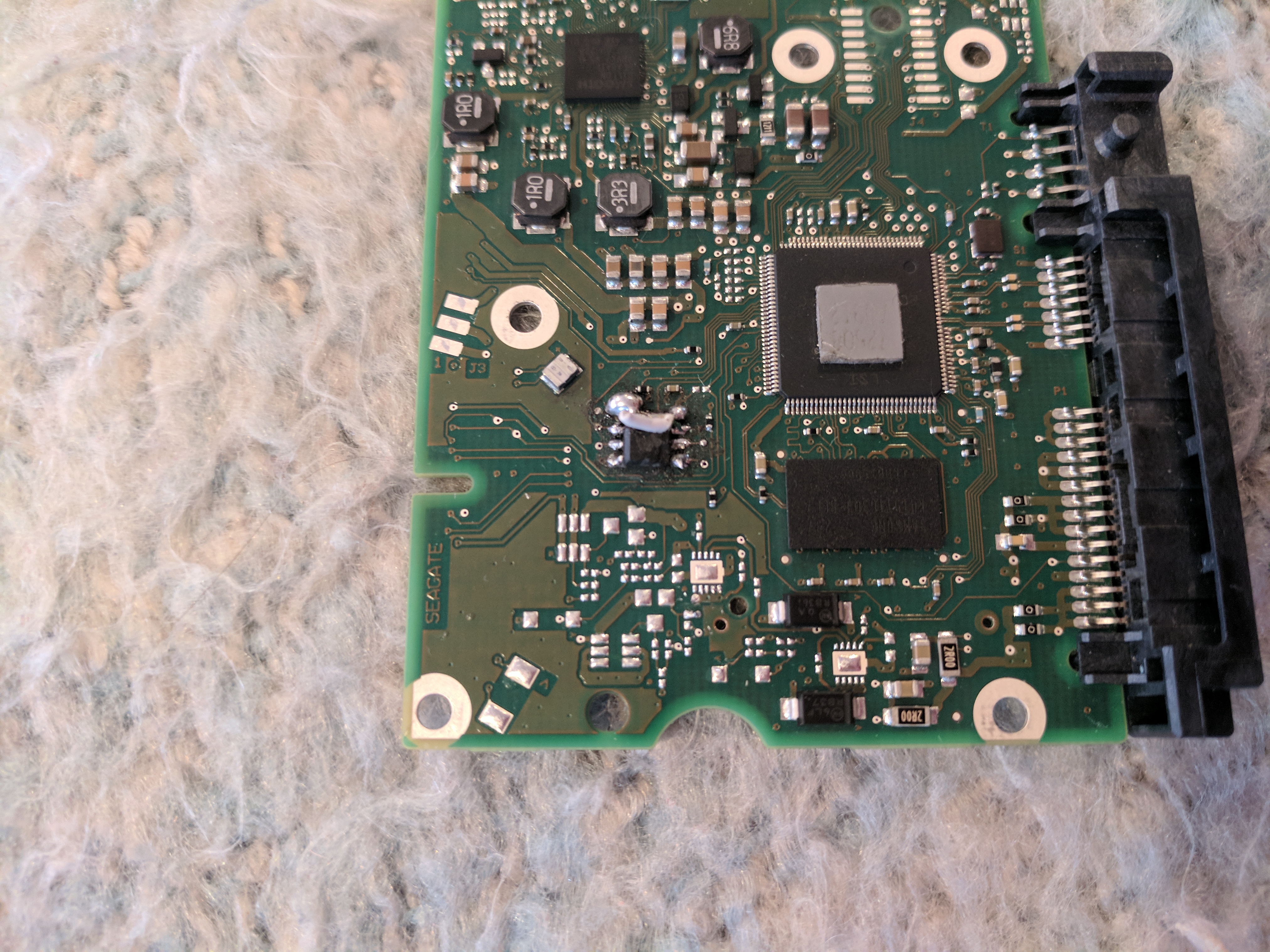

Can you show us a picture (clear, close-up) of the ROM, please.

Blizzard wrote:
There might have been a chance when the pin was broken but I'm guessing when the Dremel got plugged in it was game over. Still might be worth having a look though.
http://i.imgur.com/8NdEy7Y.jpg
No jokes about what a moron I am, please :)
I'm sure you have already beat yourself up enough, no need for anyone to pile on. If it's important data you should probably just send the HDD to a data recovery lab. Most of us have a "no data, no charge" policy.

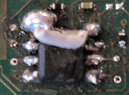

I don't understand the solder blob and/or white stuff at the "top" end of the ROM? Which leg was it that broke off? If you want to send it to me, I'll see what I can do. See PM.

i have solution for the lost rom scenario for some seagate families, unfortunately 1CH is not one of them. I was pretty close to solve it in 2014 but i am not any closer today either :(
there might be a chance of reading the chip however, but not by using your methods i think.

from the OP i think that train is gone. some pin is missing from the chip. Perhaps there is a chance to wire it under microscope but definitely not with the kind of skils he has. :=s
