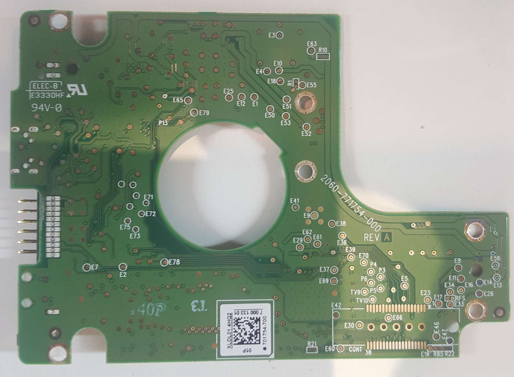

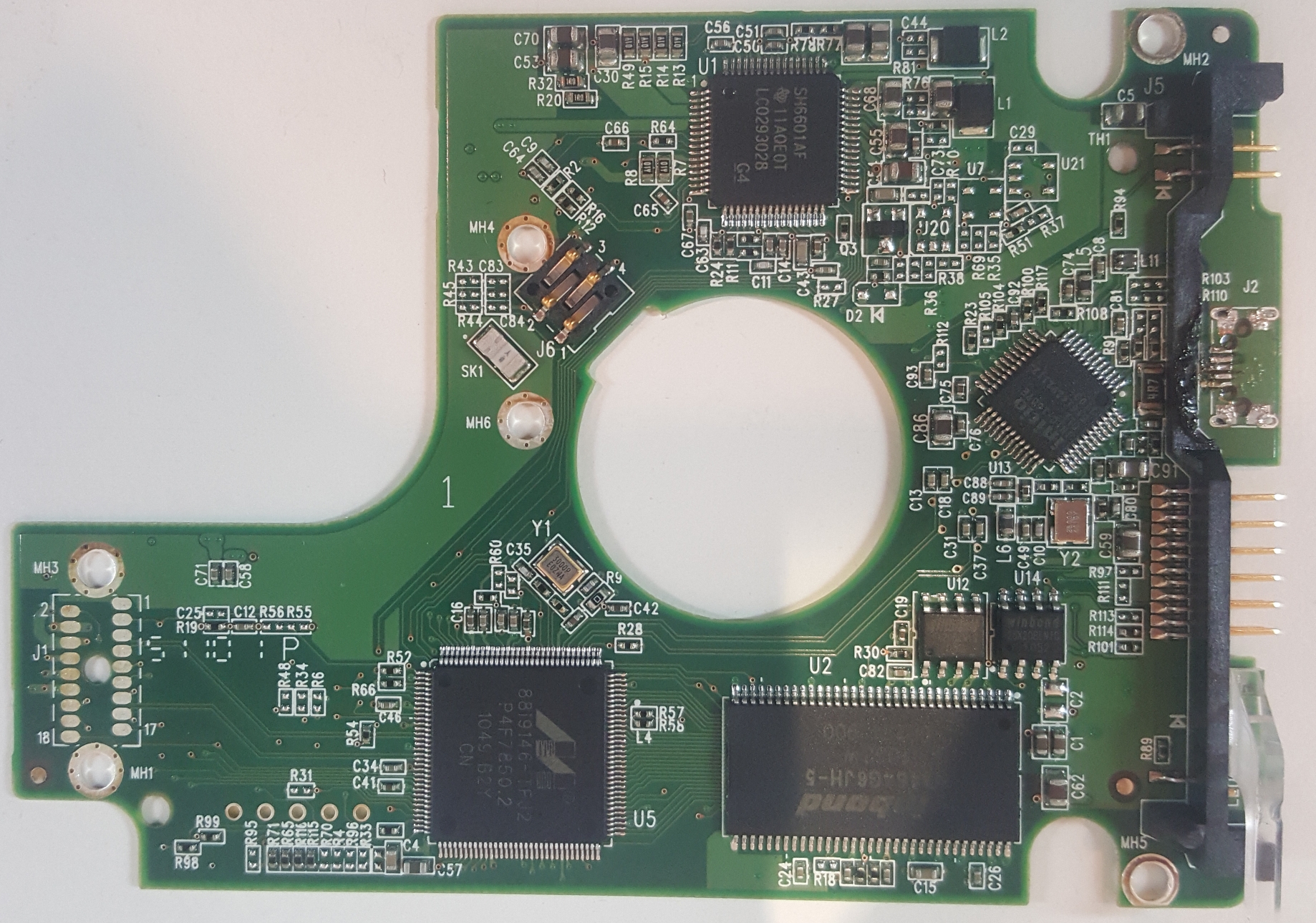

Cut the end off a USB cable and solder the wires directly to the PCB?
I like this idea but the traces where the damaged port were are too small...
See pics.

you solder stuff like that under a stereo microscope, it is quite easy to do. for the wire to USB header method, you can use thin kynar wrapping wire at around AWG#30 or less. also if the header is not an exact match physically, it doesn't matter. A data recovery company should have all the tools and shouldn't cost that much as long as there are no other issues.. if you cant find a friend to do it.

Solved this one. I was able to locate a similar PCB from an older Passport drive, remove the USB port with hot air, and then resolder onto the damaged PCB with micro pencil tip. Thanks for all the tips.
