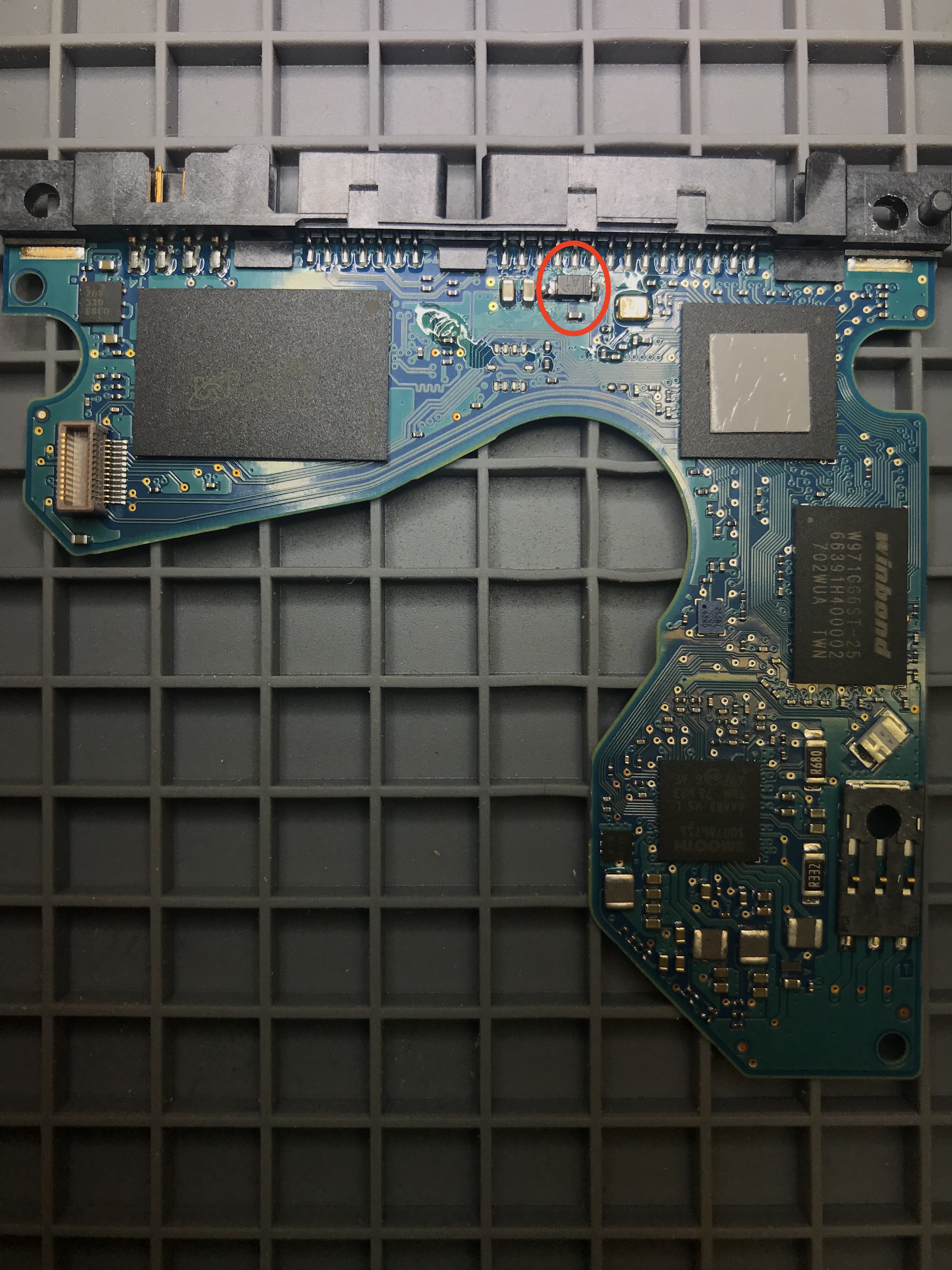

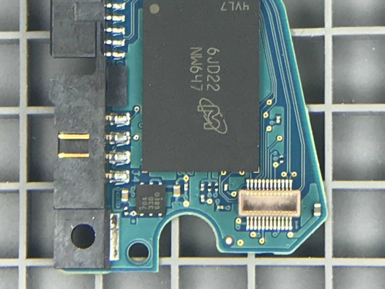

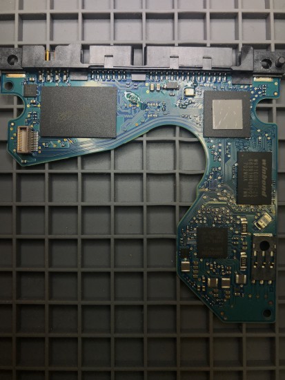

Does anyone know if this PCB has an overvoltage protection chip? It has no power.
ROM is masked as well :(
thanks

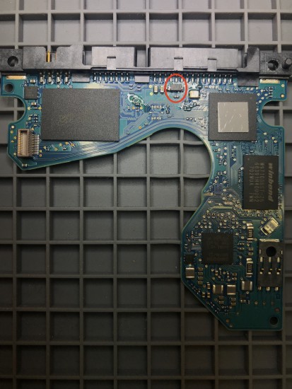

Hi, looks like 1A fuse at the red marking.

that looks more like a tvs. It has masked ROM (as almost every controller), but there is a serial flashchip near the DRAM, it is marked 25S81.

mr_spokk : checked ok.
pepe: will try , havent seen that tiny flashchip before :)

Did you test A1 as a fuse or as a diode? If it checked OK as a fuse, ie zero ohms, then the TVS diode is shorted. That said, a shorted diode would shut down your PSU.
RSA5M, Rohm, TVS diode, 200W, 5V, marking A1:
http://www.rohm.com/web/global/datasheet/RSA5M
http://www.1688eric.com/upload/pdf/2012-10-15/RSA5MG.pdf
LE25S81QE, ON Semiconductor, 8M-bit (1024K x 8), 1.8V, serial flash memory:
http://www.onsemi.com/pub/Collateral/ENA2287-D.PDF
https://media.digikey.com/pdf/Data%20Sheets/ON%2520Semiconductor%20PDFs/LE25S81QE.pdf

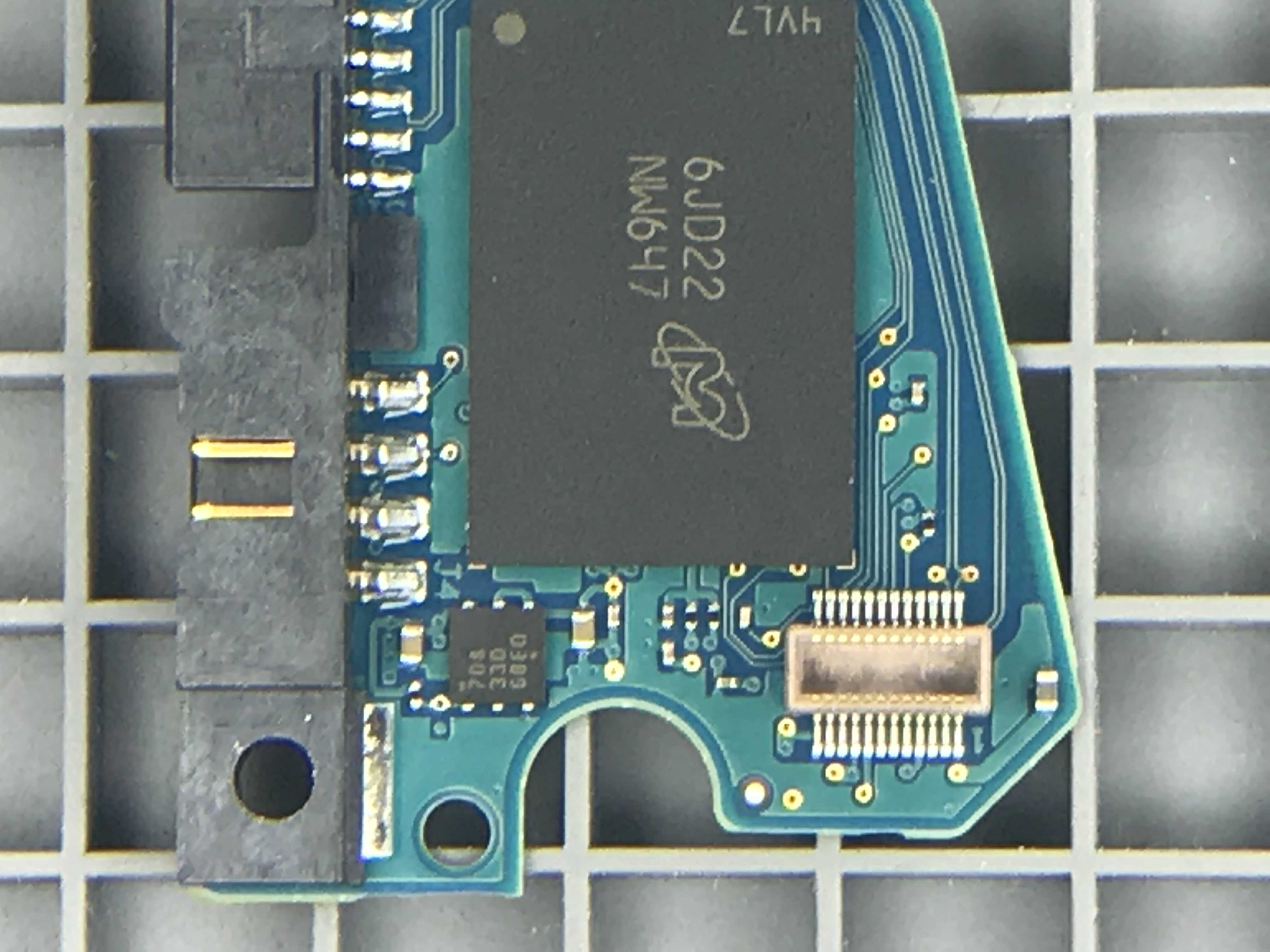

hi, can you atach more zoom pictures of the pcb pins? like the second picture please?

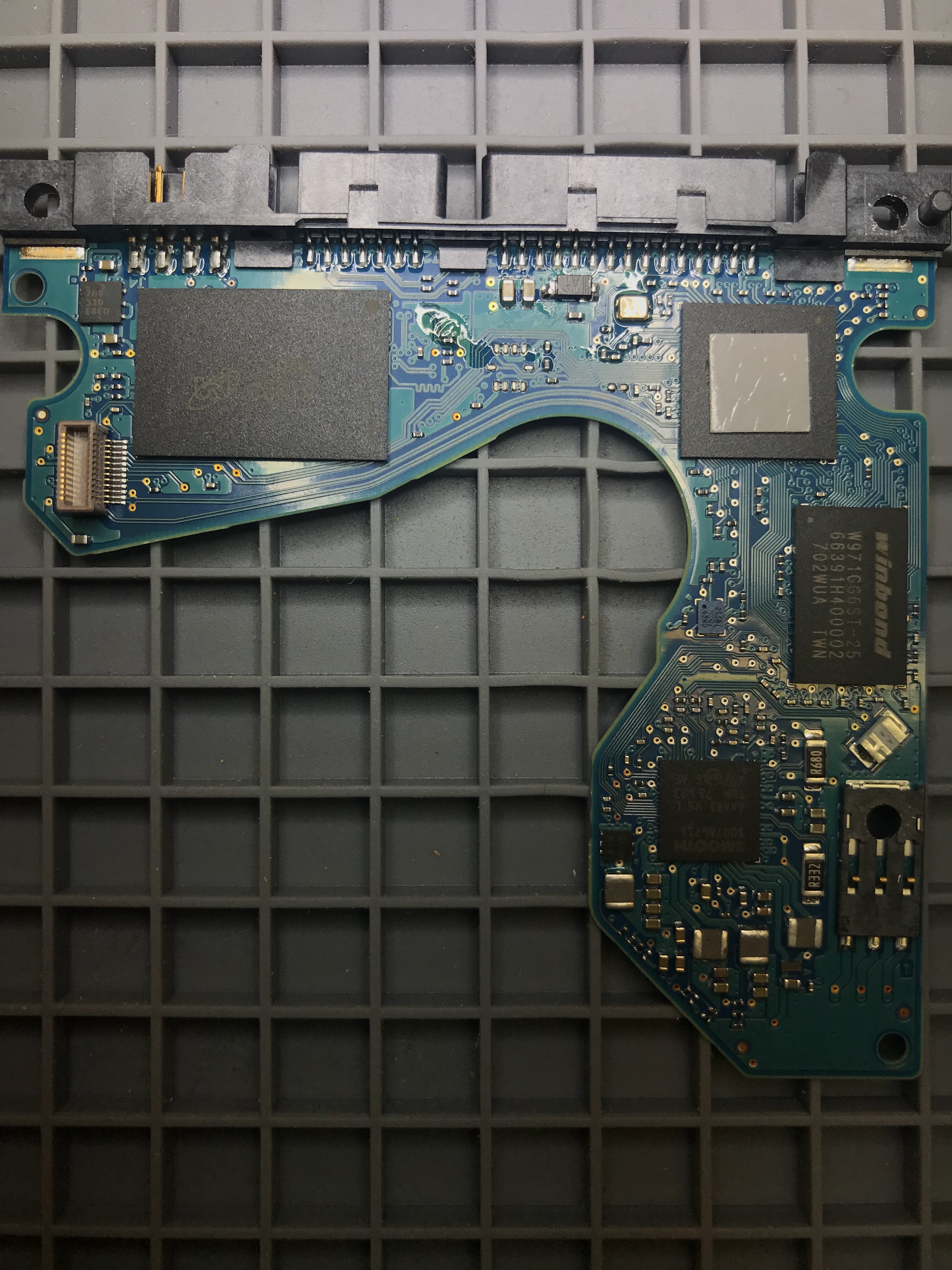

Sounds like you're in a similar situation as me. The FireCuda 2.5" SSHD drives seem to have a very high failure rate (~20% or more based on non-scientific analysis of amazon reviews) within first 2 years.
It's likely that your pcb is not totally dead but that the NAND chip is not responding which causes the board to sit in a boot loop and appear powerless. If you attach a UART to the diagnostic port, you will likely see the drive cycling through it's startup sequence. It never gets far enough to spin the platter but the platter should be just fine.
See my post for more:
https://forum.hddguru.com/viewtopic.php?f=1&t=38731
The PCB's are essentially identical even though mine was the 2TB version (I included photos in my thread).
