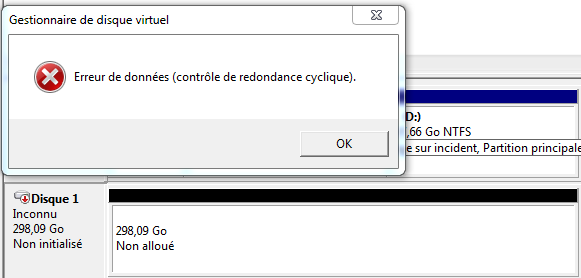

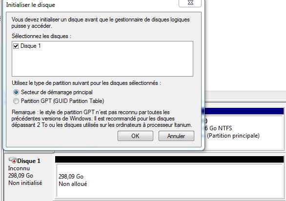

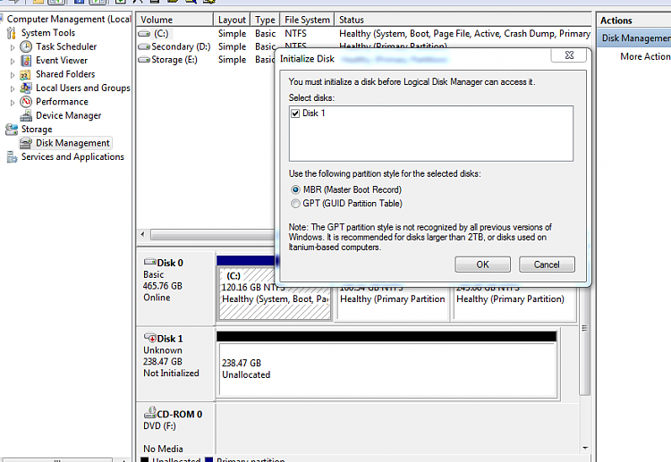

okey, i use windows 32 bits to format but when i insialise the HDD whit MBR or GPT i recive the message of Data Error (Cyclic Redundancy Check) this is the picture
 Post subject: Re: How to Fix Data Error (Cyclic Redundancy Check)!
PostPosted: September 10th, 2017, 15:08
Posts: 17215
The drive is not being detected properly.
    238.47 gibibytes = 256.055 gigabytes
What does CrystalDiskInfo report?

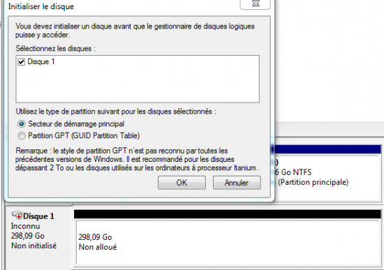

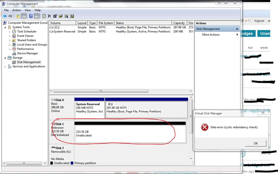

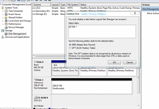

Ok Mrs rogfanther, they are the new picture and thnks for the help
File comment: finaly this is the msg what i recerved
File comment: in this and when i want to inisialise my HDD they give me too methode MRT or GPT in each choise they give me CRC
File comment: This picture show me my HDD
PostPosted: September 25th, 2017, 10:33
Posts: 713
Location: Brazil
I can see you are trying this with a lot of different computers.
Can you post a good picture of the disk label, please ? The one you used in the first post is too small.
