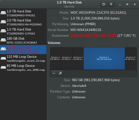

Some time ago a friend of mine gave me their laptop and asked me to attempt to recover the data from the HDD, as their child had knocked the laptop off a high place and subsequently ended up with a smashed screen, broken keyboard, etc. At the time I thought I could just pull the drive and chuck it in my own machine, however this doesn't seem to be the case.
When attempting to mount the drive in Windows 10 the disk management facility shows an unrecognised drive of unknown capacity, and fails to initialise the drive entirely. I cannot format or otherwise change the drive settings, nor does it have a drive letter assigned to it.

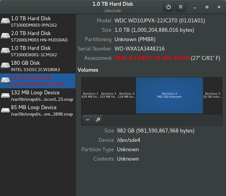

Mounting the drive in Ubuntu gives a more interesting result. The default disks facility shows all partitions currently on the drive along with partition sizes and device ID's, however there is no other information past this (See attachment 'Image 1' below). Viewing the drives SMART data reveals an overall assessment that the drive is likely to fail soon, due to a high reallocated sector count (See attachment 'Image 2' below).
I've tried to run 'ntfxfix' on each partition individually (in an attempt to at least mount the drive and backup the data), resulting in the command getting stuck at 'Mounting volume' until I close the terminal. I've also tried 'ntfxfix' on the entire drive, wherein I get the following output:

File comment: Image 1 - Drive in question showing partitions

File comment: Image 2 - Drive SMART data

To be honest, if the drive itself is worth more than the data then you are wasting your time.
This drive will never be usable again, or at the very least not to be trusted.
It will almost certainly have some physical media issues, and the problems you are seeing are a symptom of the underlying issues and not the actual problem.
