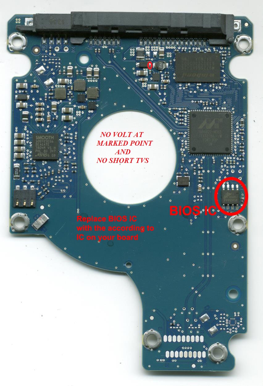

SAMSUNG ST2000LM003 PCB 100731207 - NO VOLTAGE
NO SPINUP.
1. TEST POINTS PLEASE
2. CAN I USE 100739392 AS REPLACEMENT PCB?

There are 3 inductors above the SMOOTH chip. They will be Vcore and Vio. Also measure the voltage at the 2R2 inductor.
I can't tell if the diode is a TVS diode or if it is connected to the coil.

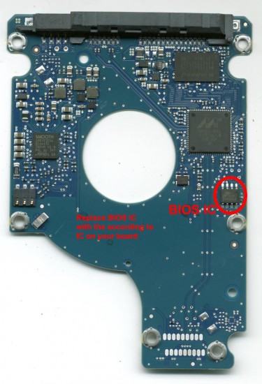

used this pcb 100739392 with rom transfer, problem solved
