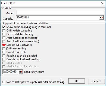

On barracuda 7200.14 drives with bad media, sending usually terminal congen commands often don't help much.
You should use some pro tools as PC3000 or MRT to edit ID on sys 93 by unticking everything, exept "Show additional diag msg in terminal".
Sometimes you'll need to disable also IDLE activities by ticking the option, see pic

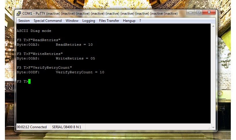

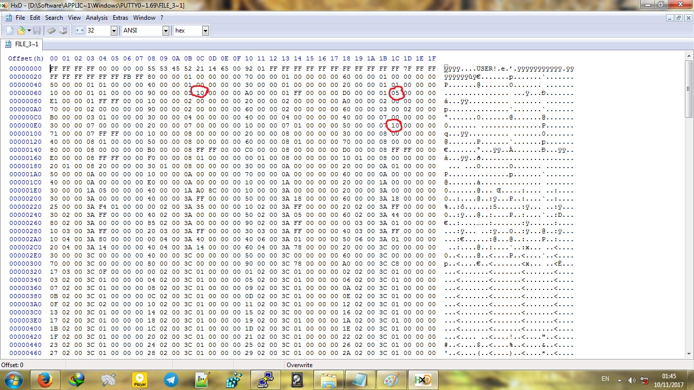

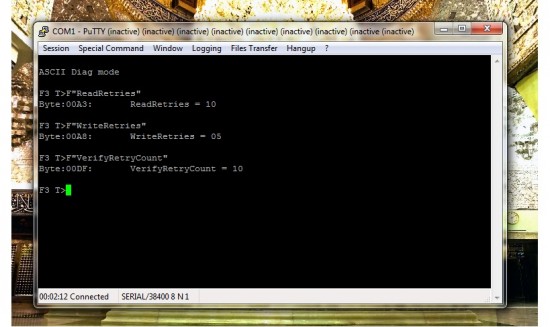

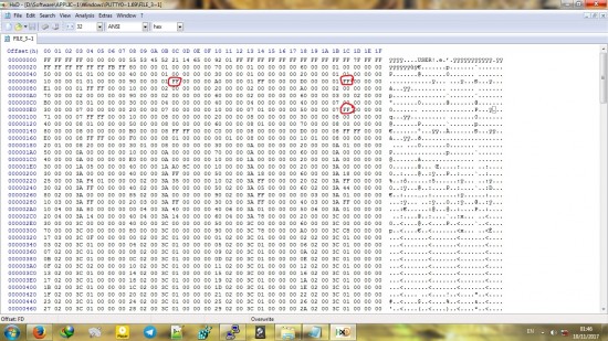

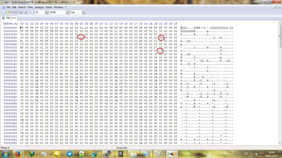

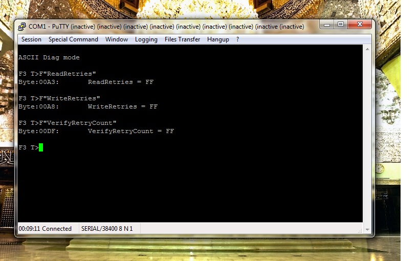

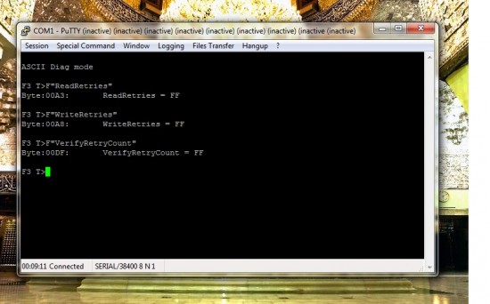

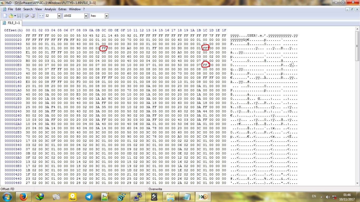

i compare sys file 93 in hex editor with terminal log and locate settings
for example you can change read and verify retry to 255 (0xff) in sys file 93 with hex editor
File comment: first i print these values in terminal
then i read sys file 93 with terminal and save it
File comment: then i open sys file 93 and locating bytes in sys file 93 with hex editor
File comment: then changed values to 255 (0xff)
File comment: then upload sys file 93 with terminal to drive and repower drive
then print terminal values and you see value changed :D :D :D
