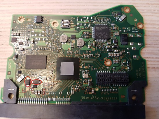

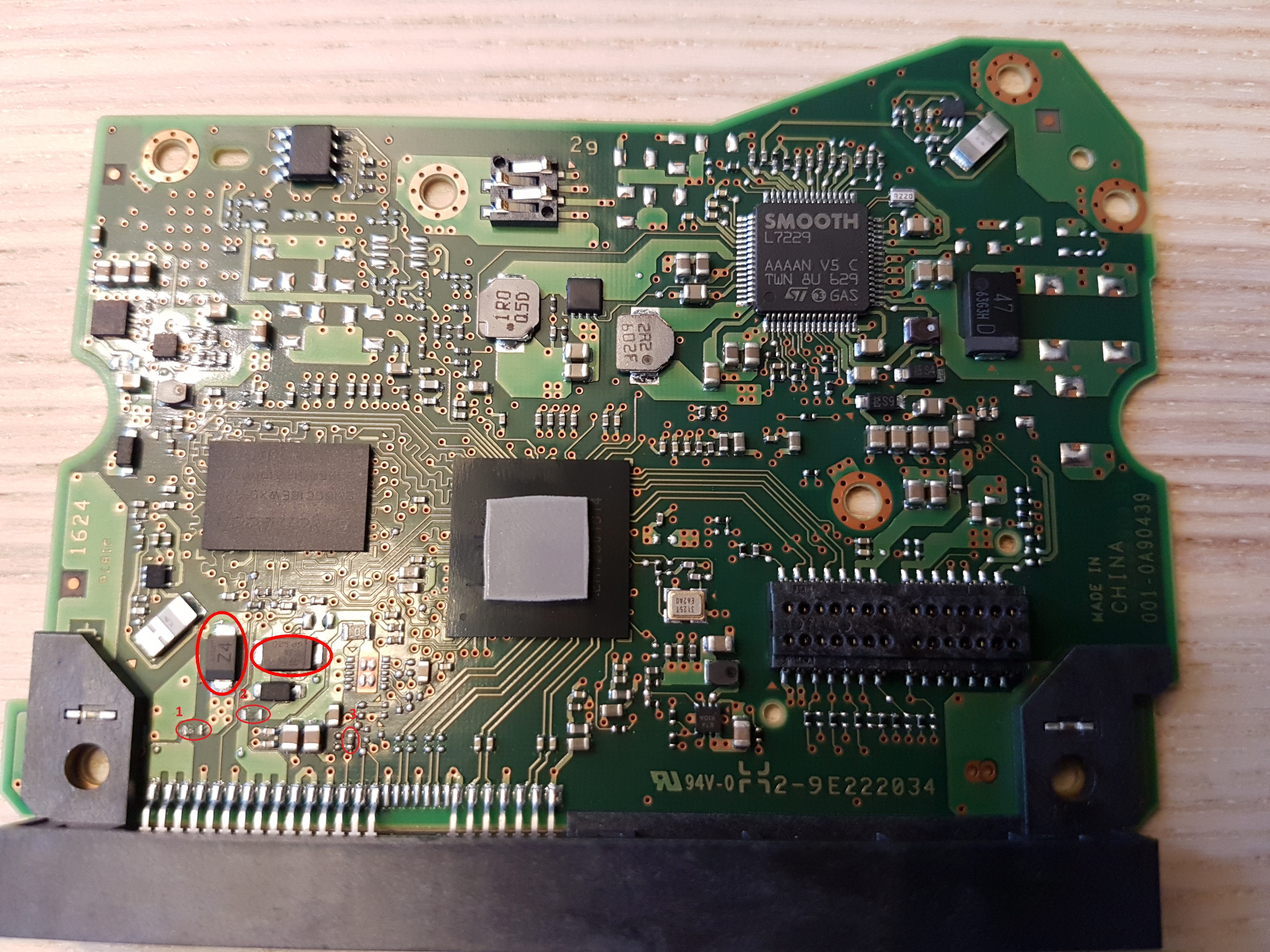

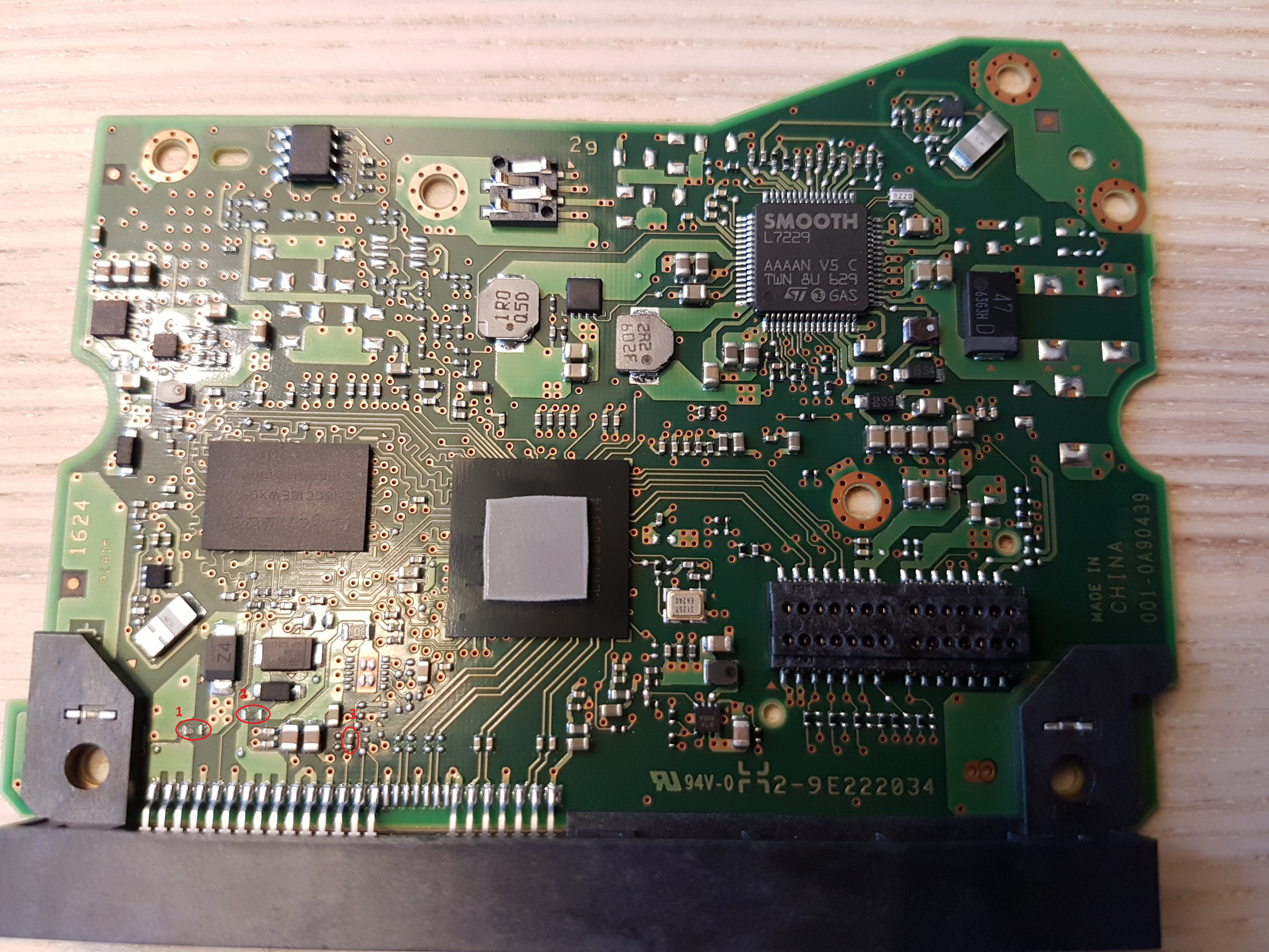

I managed to connect 19V power to a QNAP NAS expecting 12, and blew the NAS and 4 of these WD drives. I've been doing some research, and it appears there's a possibility I can get the drives to spin up again by snipping a TVS diode. Unfortunately, there's no labels on the PCB, so I've attached an image here hoping someone can confirm my guesses or tell me I'm way off :)
I've marked what I believe are the diodes:
1) This appears to not be connected - Out of range with ohm meter at 20M
2) 0-0.1 Ohm, both directions
3) 0-0.1 Ohm, both directions
Should I, in theory, get the drive to spin up by snipping 2 and 3?
 Post subject: Re: WD80EFZX NAS overvoltage
PostPosted: October 6th, 2017, 9:48
Nope, the TVS diodes on this one are the two much larger black components just up from the two you marked. Check those and see if they read near 0 ohms in both directions.

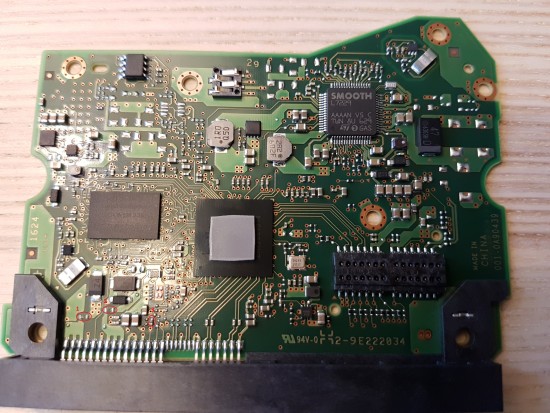

PostPosted: October 6th, 2017, 9:52
Here I circled them for you:
PostPosted: October 6th, 2017, 13:12
Joined: October 6th, 2017, 8:11
Location: Norway
Thanks!
The leftmost of the two you circled shows close to 0 ohm, both directions. The rightmost shows 2.4 kOhm and 600 Ohm, and the diode tester doesn't complain about it.
So, in theory I could snip the leftmost diode and get the drive spinning enough to get data off, as long as I don't mess up the voltage again?
PostPosted: October 6th, 2017, 14:18
Posts: 17332
Component #1 is a zero-ohm resistor (or fuse?). The 12V TVS diode (Z4) will be shorted (as you have already determined). You can snip the diode, but you will need to replace the "fuse". You can use a blob of solder or a wire link as long as there is no other damage to the PCB.
BTW, you say that you "blew the NAS" and the drives. If the NAS really is damaged, could you upload detailed photos of both sides of its PCB? Perhaps there is a simple DIY solution.
PostPosted: October 8th, 2017, 16:13
Location: Norway
Thanks! All drives are spinning and 14TB of data's being copied off.

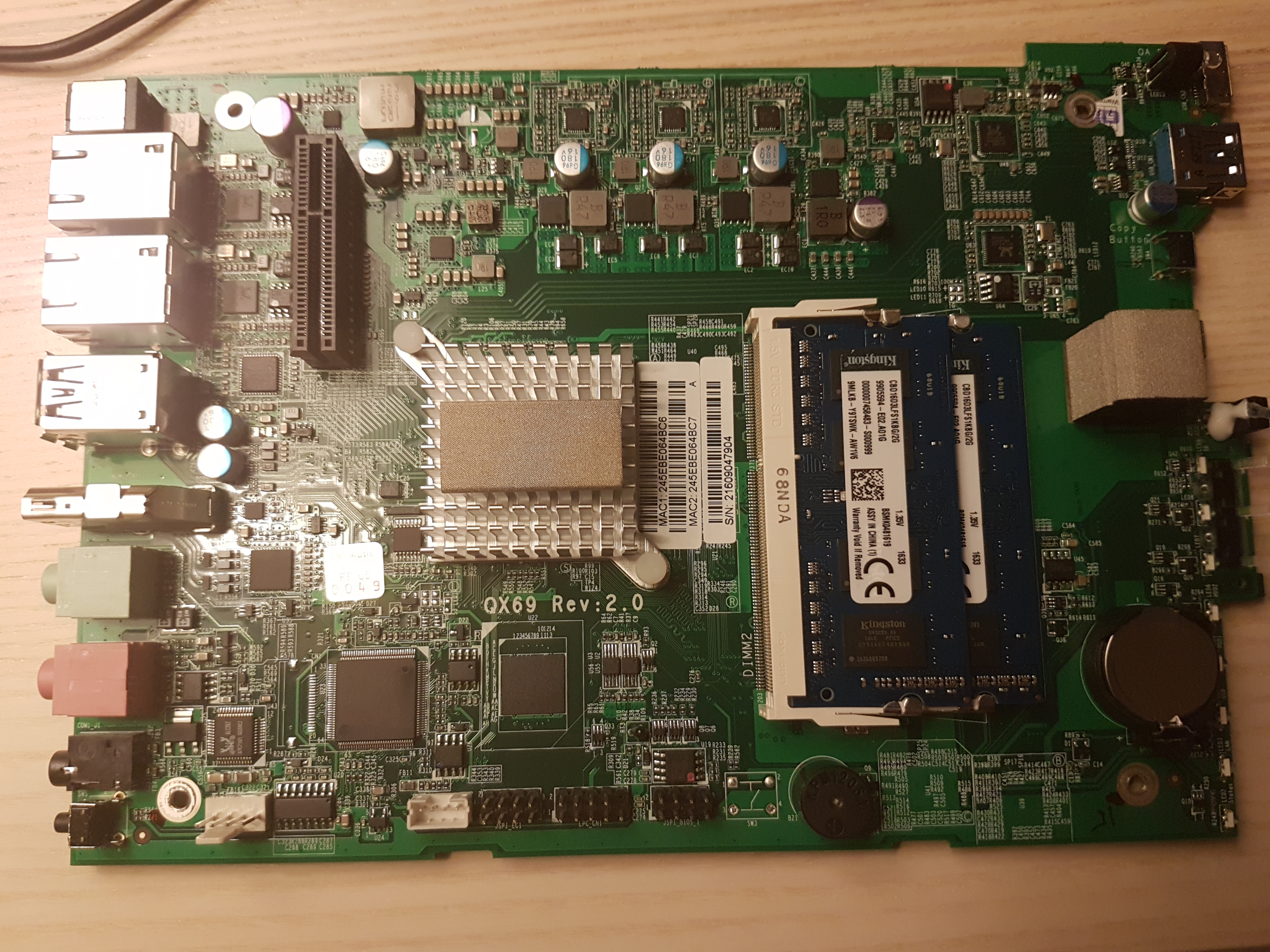

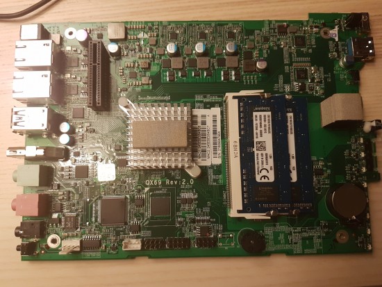

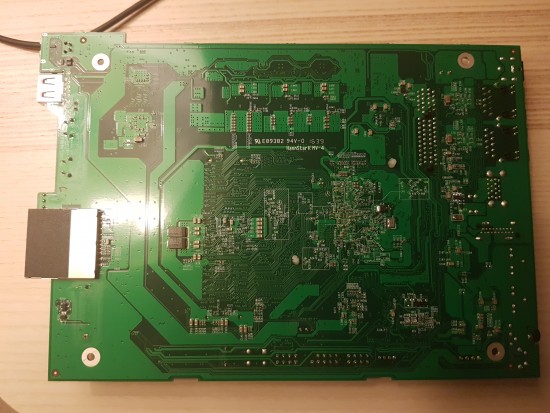

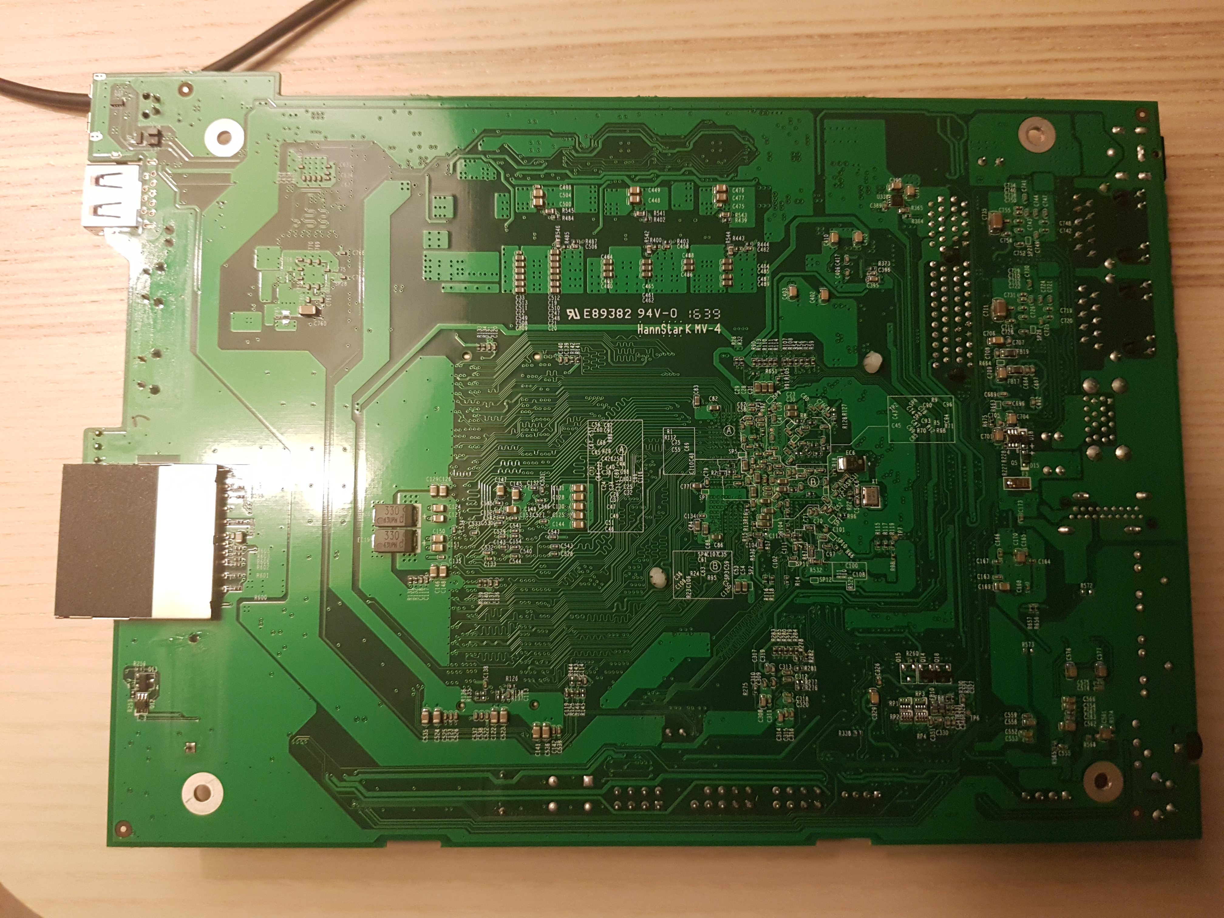

The NAS that died is a QNAP TS-451A. Attached photos of the main PCB. If you have suggestions for testing and DIY fixing I'd love to try fiddling with it.

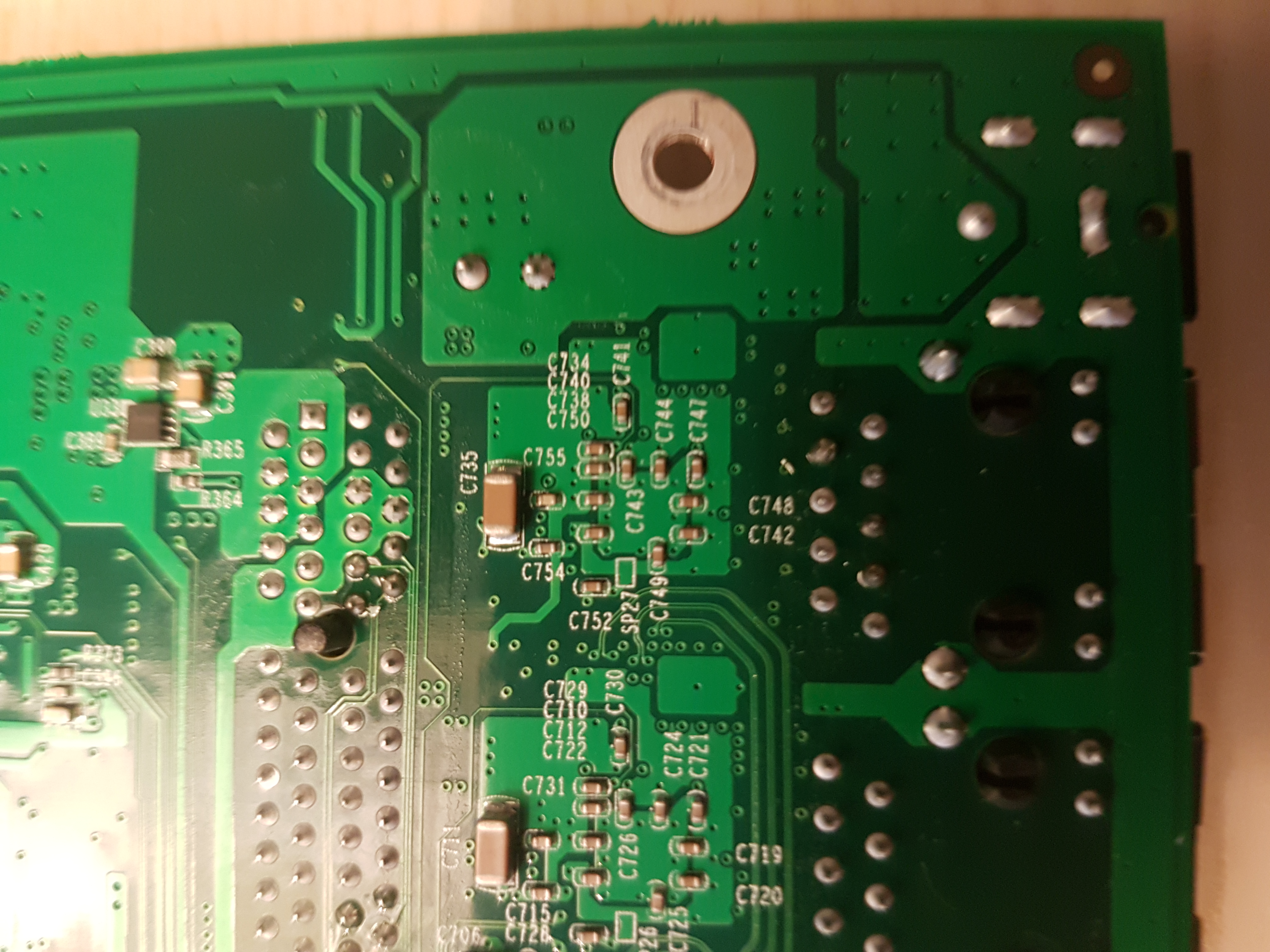

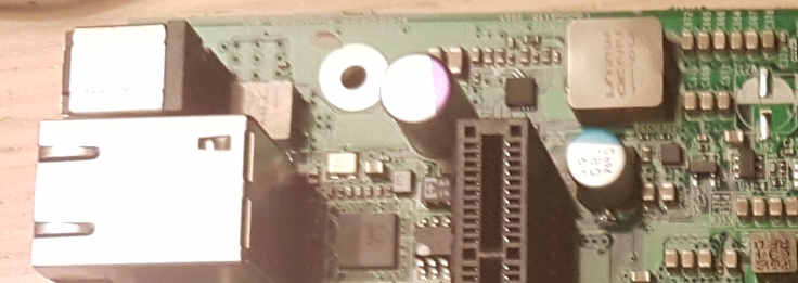

PostPosted: October 8th, 2017, 17:20
Posts: 17332

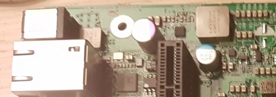

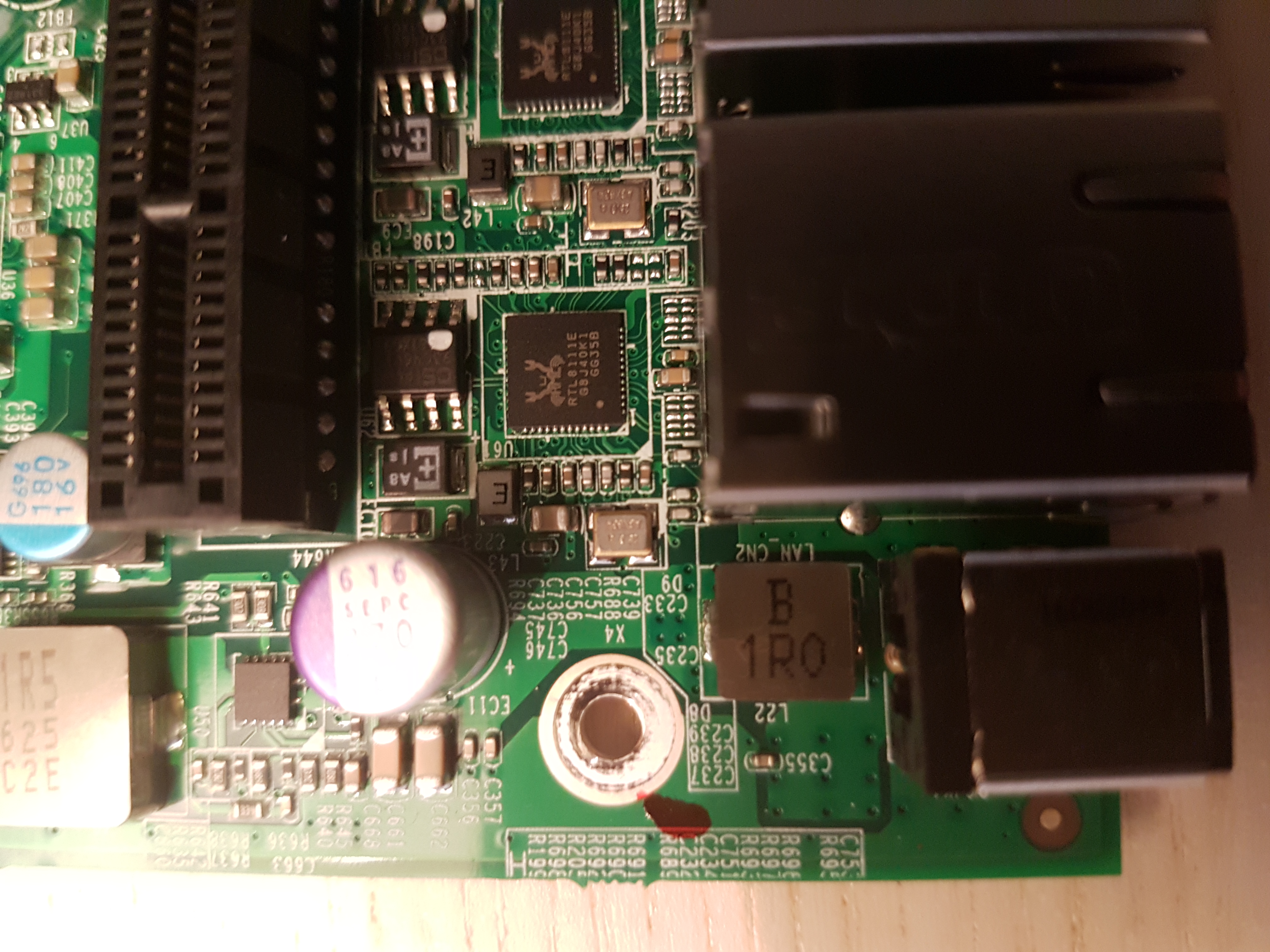

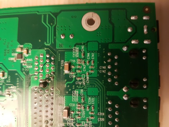

Could you provide close-up shots of these areas?

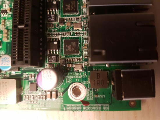

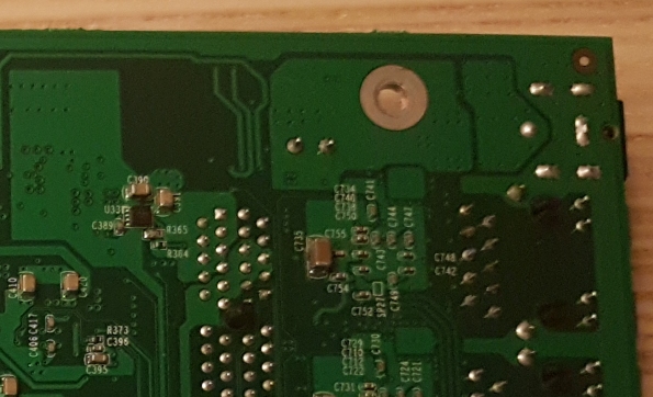

PostPosted: October 9th, 2017, 11:58
Location: Norway

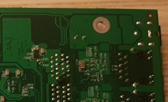

Here's the images, are they usable?
PostPosted: October 10th, 2017, 15:34
Posts: 17332

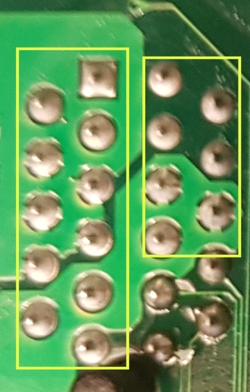

Can you measure the voltages on these pins?
