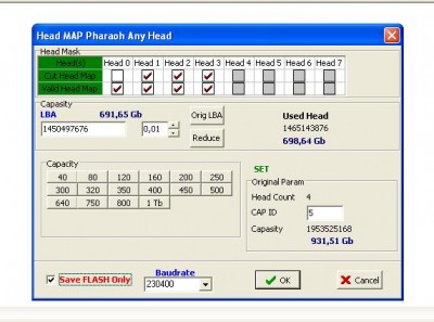

Hi
i programmed rom after power on drivei hear tick tick
it didnt work you must cut head with sediv
see below link from spildit
http://www.hddoracle.com/viewtopic.php? ... =20#p13246
Thanks for your help

 Post subject: Re: please someone cut head of this rom for me
PostPosted: October 11th, 2017, 3:08
Posts: 1755
Location: Verona, Italy
Sediv doesn't even consider to cut head 0 on this seagate (Pharaoh family) with just rom code.
In head map utility it let you to cut all heads exept head 0.
As i thought, you can't cut head 0 on this family with only rom, you'll need CP13 and module 3, then you can do it.
PostPosted: October 11th, 2017, 8:19
Posts: 1755
I don't know what to say, sediv doesn't let me to untick head 0 or any other head exept last one.
Example, if F3 drive has 4 heads (0,1,2,3), it will let me to cut only head 3, if i want to cut head 2 i have to untick also head 3 or it will refuse to untick head 2.
If i want to cut head 1, i have to untick first head 3 and 2.
PostPosted: October 11th, 2017, 16:34
Posts: 17230
When cutting the last head, SeDiv only needs to make minor changes, eg head map, number of heads, capacity. OTOH, when cutting any other head, say head #n, SeDiv needs to shift the parameters for heads n+1, n+2, etc, to positions n, n+1, etc.
You can see how this is done in the following WinHex script (posted by Spildit) to cut head 0 for 4-head Wyatt drives:
http://www.hddoracle.com/download/file.php?id=4923
