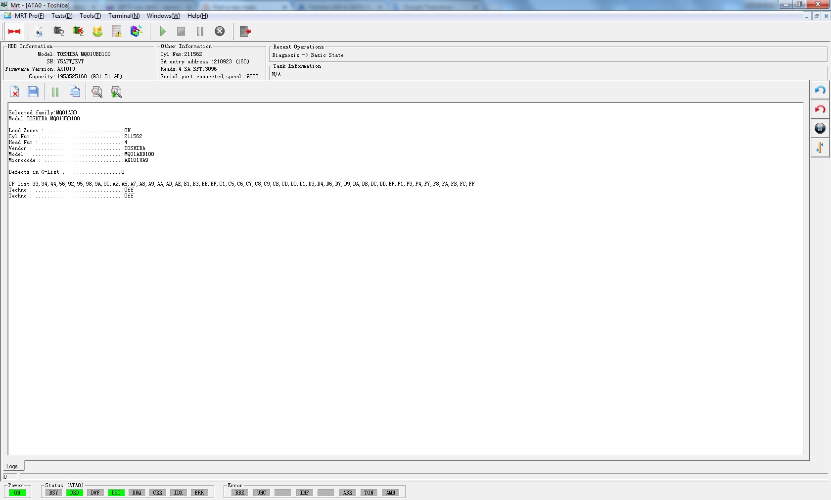

i've this Toshiba MQ01UBD100 usb drive that i need to clone.
I converted usb pcb G3448A to sata by using sata donor G003235B
G3448A ----------> G003235B
I already cloned surface 1 - 2 - 3 without any problem in sata mode, but i can't clone any single sector on surface 0 (SATA, UDMA, PIO mode don't work).

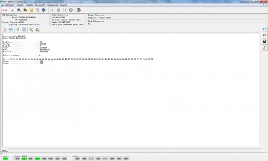

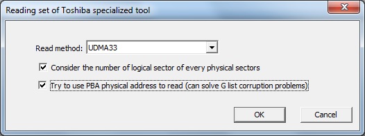

I thought it was bad head 0 (or at least very weak head), but if i turn off technology mode on toshiba utility, i'm able to read sectors on surface 0 only via PBA.
Reading speed in PBA mode is pretty slow (about 2,7 MB/s) but many consecutives sectors are not readable even in PBA. When head 0 hits first unreadable sector of those bad zones, hard drive goes busy for about 10 seconds before that is able to continue (i had to set 80,000 LBAs jump on 'skipping sectors after reading error' or it would take a life to continue reading).

FWIW, the G-list has 3 sections. The number of reallocated sectors before and after clearing is 0. The second section has 0x660 defects (pending sectors/tracks?) before clearing and 0xE afterwards. The third section remains unchanged after clearing.

If it was a WDC drive I would say:
In PBA mode it uses Coarse Microjog settings and in LBA mode Fine Microjog settings. This makes the diffrence.
