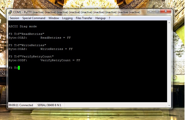

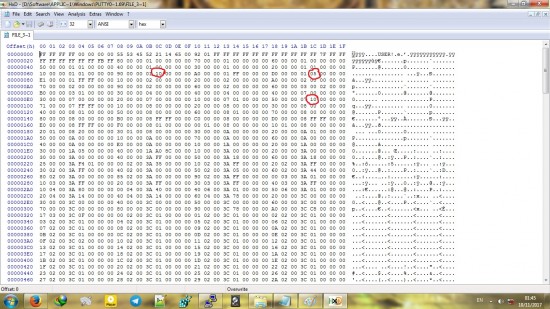

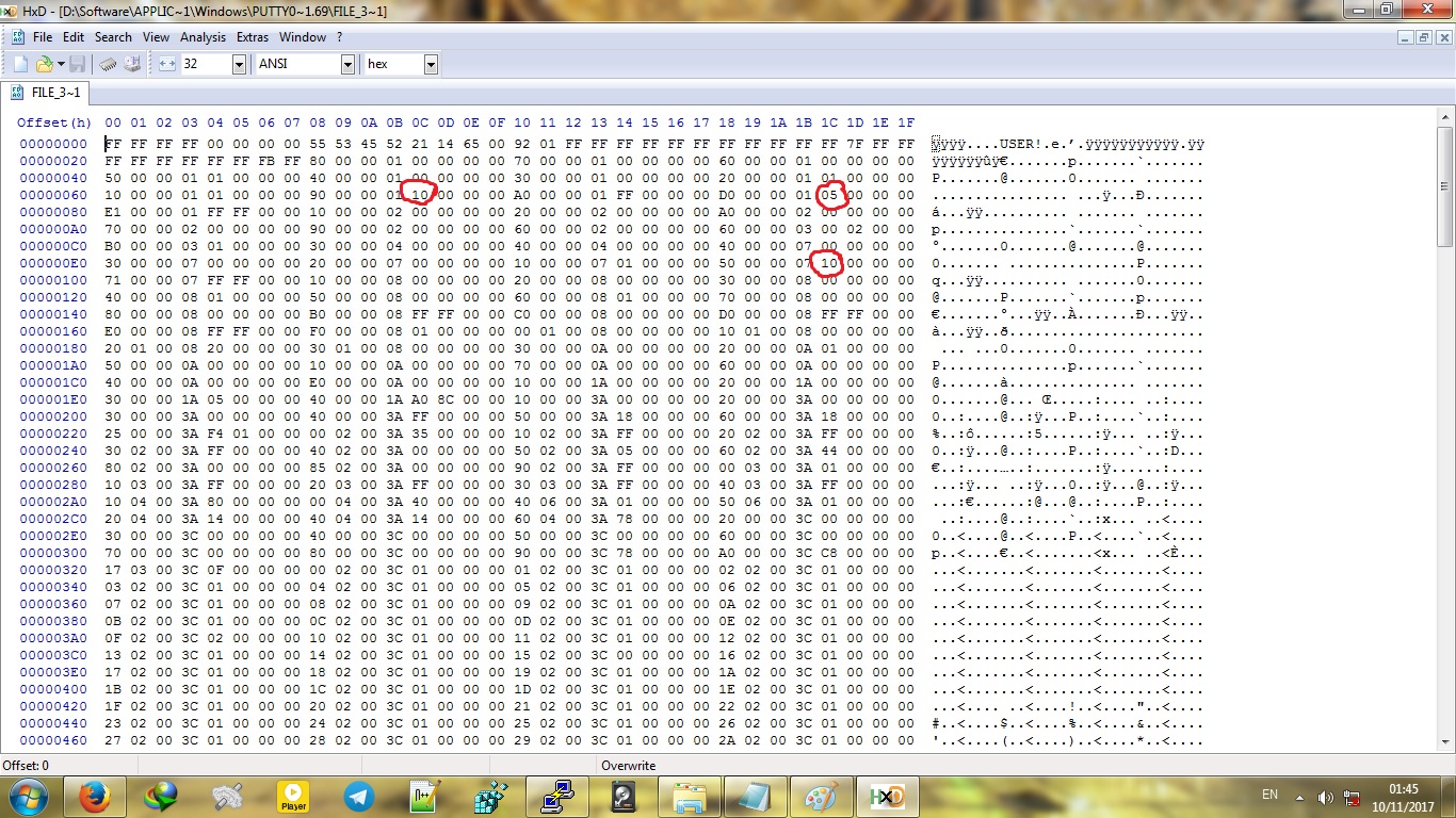

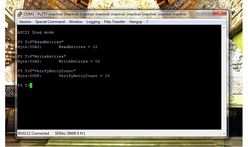

hi

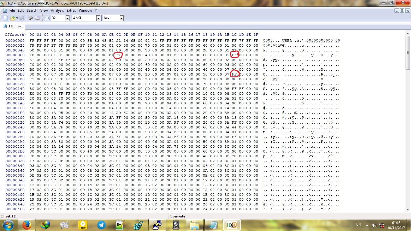

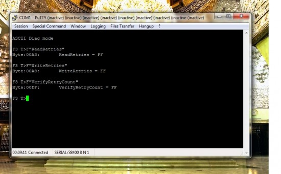

i have another trick for seagate to have fast recovery 8) 8) 8)
i changing values in sys file 93 with hex editor :D :D :D
see pictures

this does not work on all FWs...
