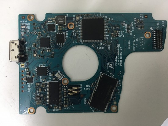

what is a Compatible SATA PCB for Toshiba G003189A USB 3.0 ??

And which one is the rom? IC606 or IC602
 Post subject: Re: Compatible SATA for Toshiba G003189A ??
PostPosted: November 1st, 2017, 11:00
Posts: 219
SATA PCB: G003235C
ROM: IC602
