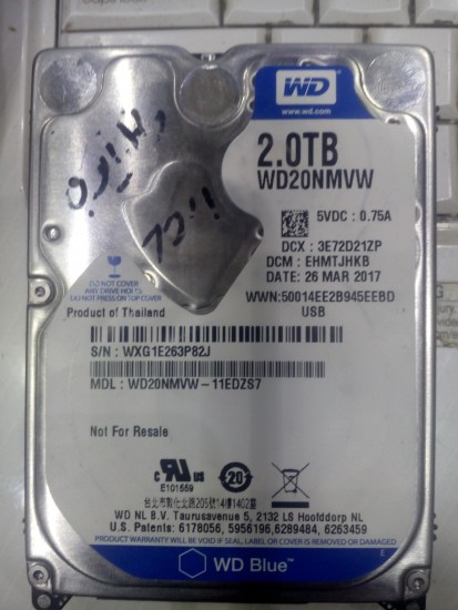

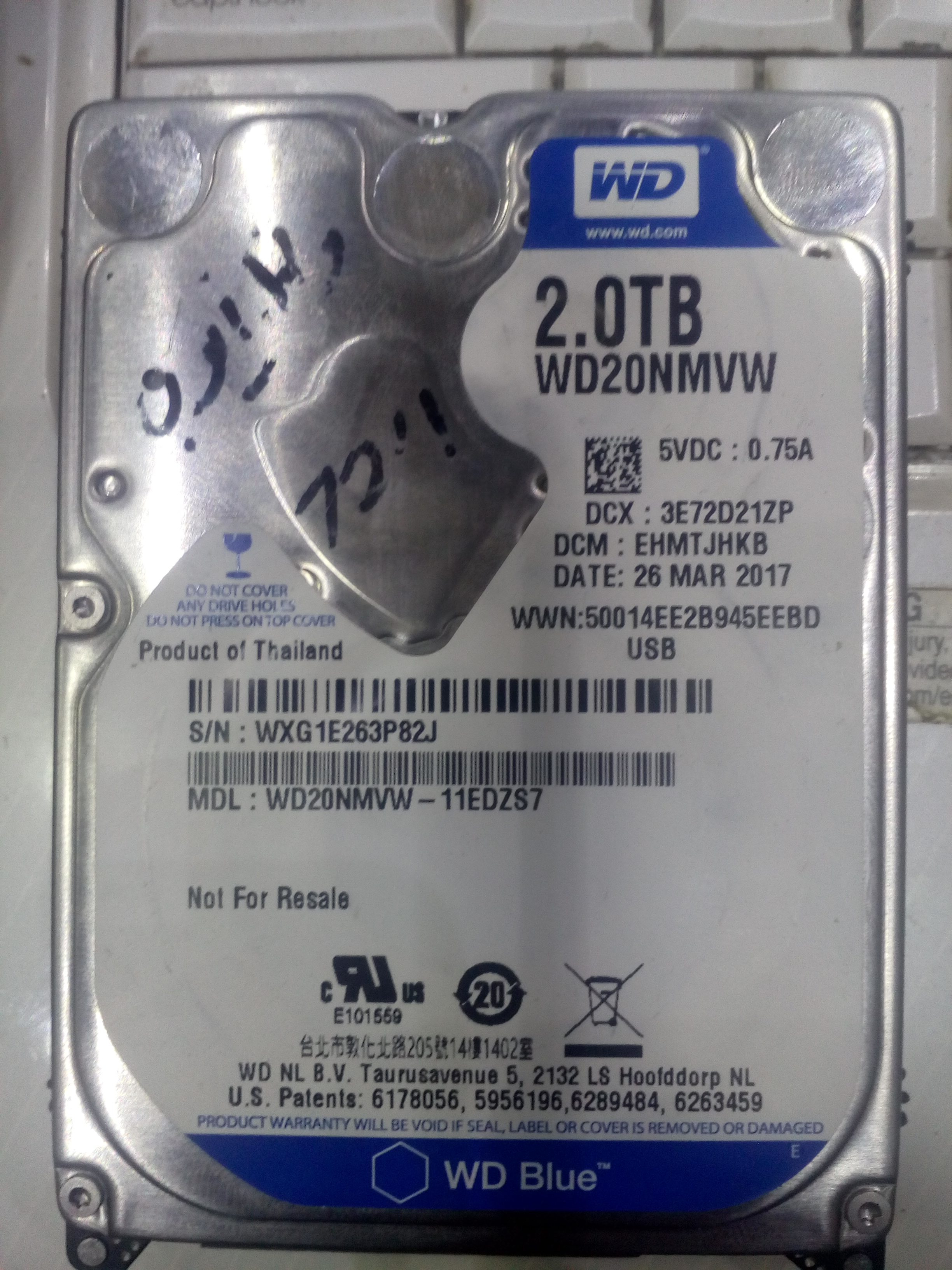

Hello
The drive in topic came to me with corrupted ROM. No detection/ SA access.
After some modifications i have SA access and mods. Backed up two copies 0,1.
The problem now that module 02 can't write by ID. Although, copy 0 and 1 can read and write module 02
The drive ID now as family (SHREK LT).
What would be the problem in your opinion?
ROM still corrupted?
Thanks in advance for any suggestions.
