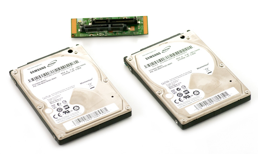

its Hardware Raid 0 picture is below, Data Recovery is possible ..........

strange thing. I thought he said he took the internal drive out to put in another PC, that's why I discounted such a setup.

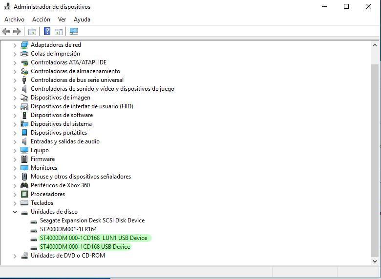

Its really weird. I don’t know if its posible to have two separate arrays of discs or whatever inside one physical drive. For some reason my pc doesn’t recognize more than 2tb for this specific Device. I have another one working without problems with 5Tb.
It was a only 4tb volume but now the system reads two volumes, like two different physical drives.
Its obvious something went wrong with, I assume, the firmware or whatever was working there makin posible the 4tb storage. Now, because some manufacturer (seagate) has tricky ways to sell 4Tb devices including some sort of “patch” for them to work properly, I have those two different volumes... with more than 3,5tb of my data splitted between them.

necrorider wrote:
I have TWO UNITS (not partitions or volumes, I mean two separate units in a single HDD)
there are no two drives, only one (ST4000DM000-1CD168), the problem is in the disk partitioning type, which is correct for the SATA-USB bridge but not for your PC.

Posts: 17091
Some enclosures accommodate 2TiB+ drives by increasing the sector size to 4096. Others (eg Verbatim) present the drive as two "virtual" physical drives.
