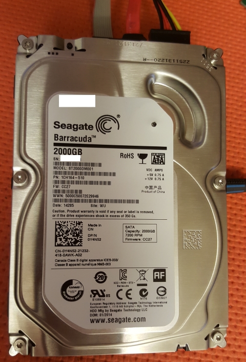

This is a issue i never faced and also ace support can't answer ...
ST2000DM001 1CH164-510 fw cc27 , when i modify head map in rom , than the drive do not spin anymore.
than i took another donor - same model same date same fw - and same issue - once i modify head map in rom, ddrive do not spin.

i detail better:
1) the drive spin up normally with original head map
2) any kind of modification in rom in patient but also in DONOR (same model,fw,date,P/N) make them NOT SPIN
and terminal like this:
"Boot 0x40M"
3) there is no calc of CRC in SAP pop-up , i think the CRC it is auto calculated from utility.

 Post subject: Re: funny issue on Seagate F3: once i modify HM , drive not
PostPosted: November 16th, 2017, 5:37
Posts: 441
Location: italy
ok - case solved
used at the end grenada utility instead of F3 general utility and the crc is correct auto and it works.
hope can help other people
very good fzabkar to notice the crc issue!
